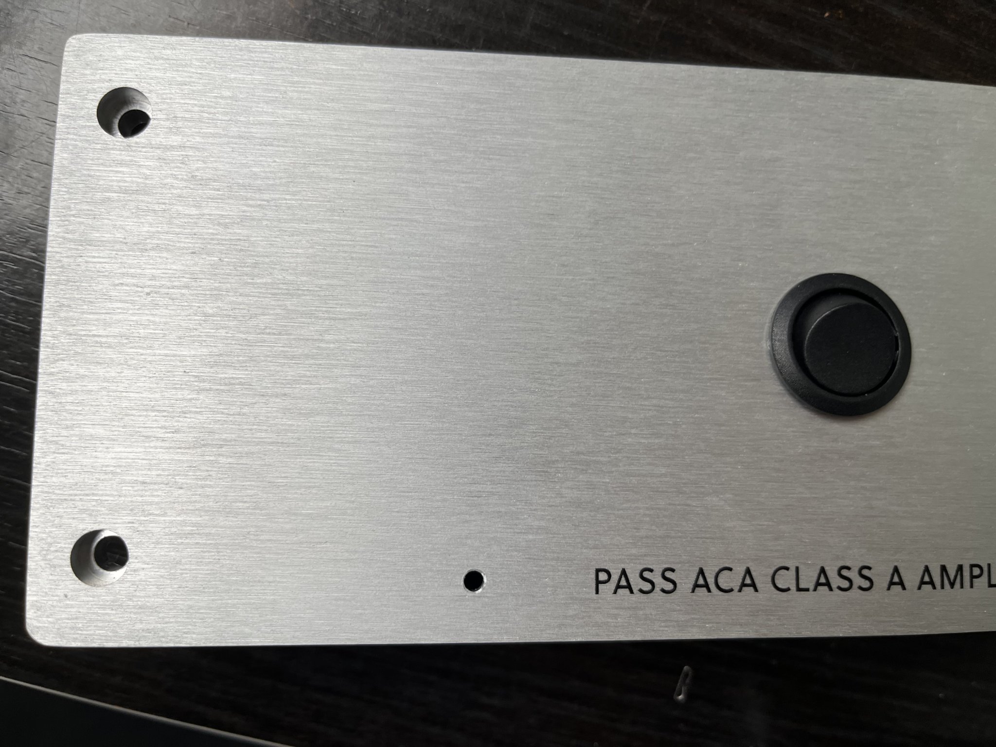

Not sure if this is the right place to post this, but I'm pretty sure the holes are drilled in the wrong place on my amp's face plate.
When comparing to photos in the guide, there are a number of significant differences

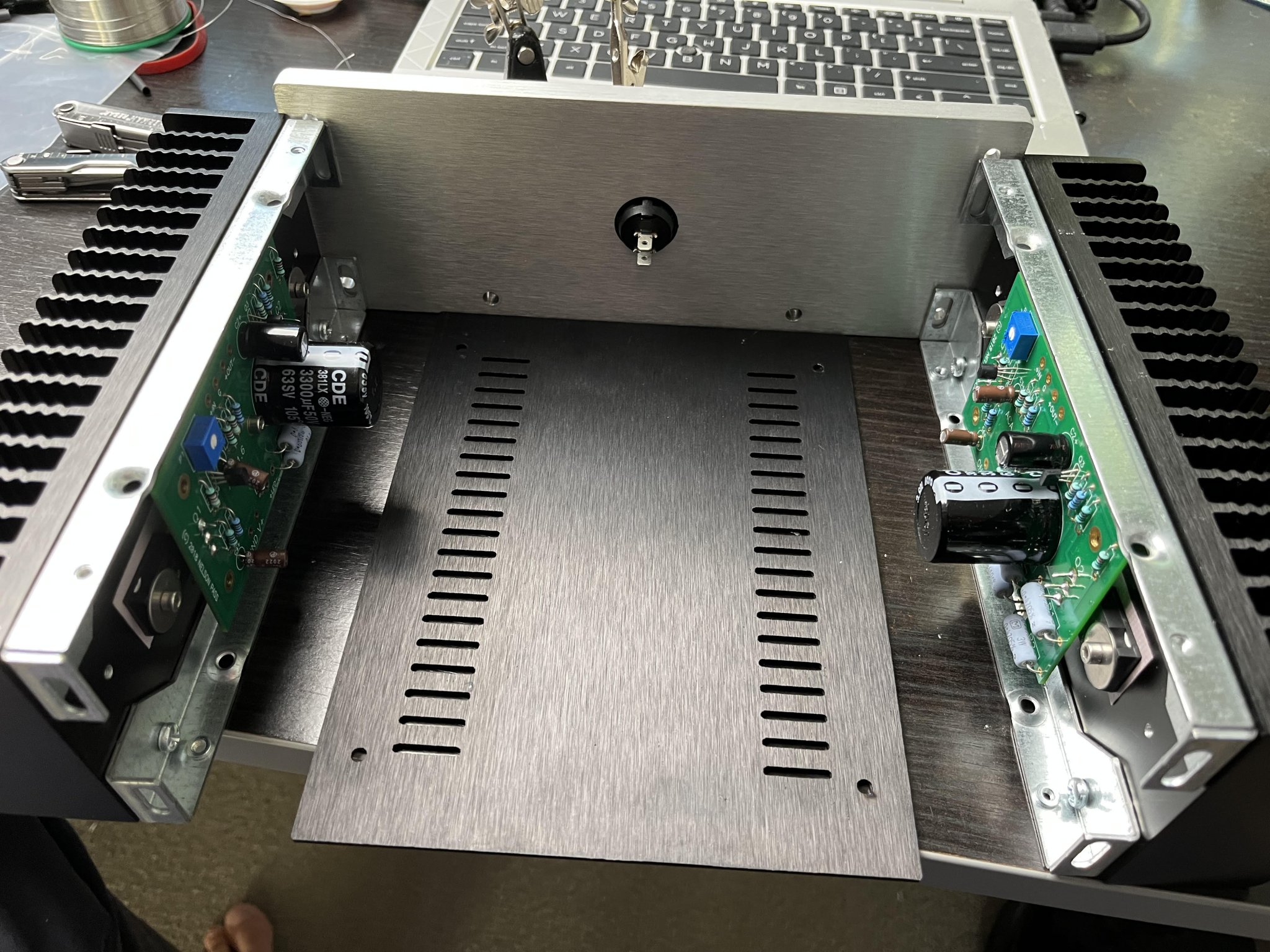

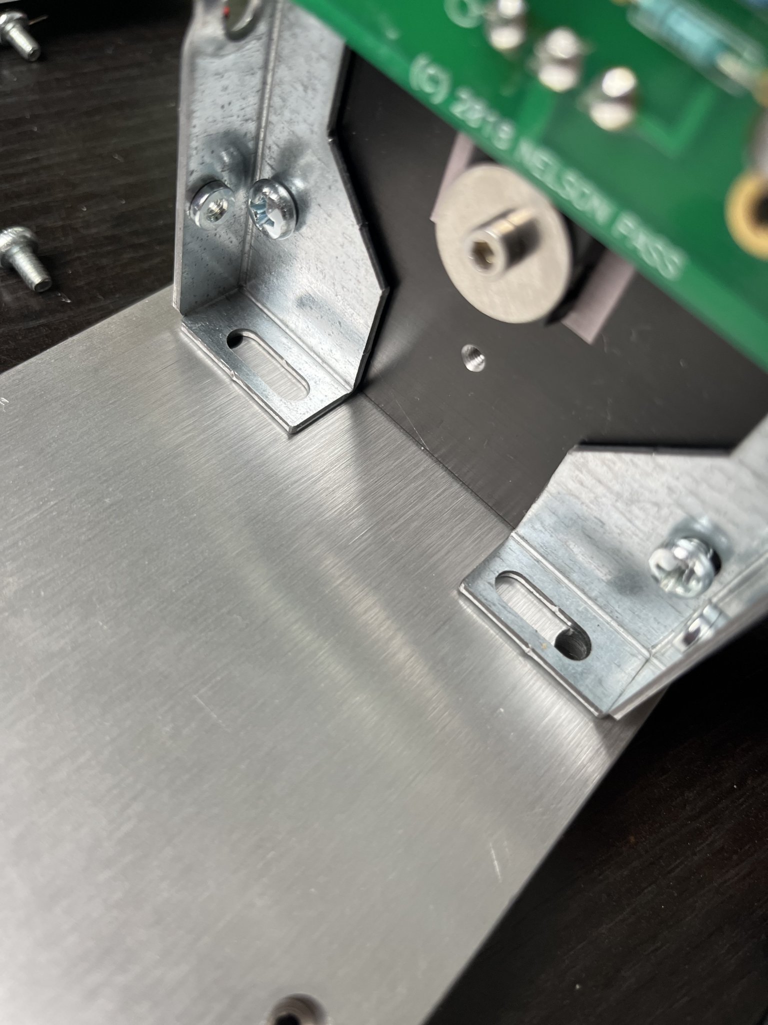

- The holes aren't close enough to attach each side. I've loosened the side rails and wiggled them out as far as possible, the holes don't line up
- The holes are near the edge of the face plate. So even if I could attach the sides to the faceplate, the sides would be too far apart for the top and bottom to span. See the last image
- Also, the holes aren't threaded, it looks like they are intended to use with a nut on the oher side.
The holes in the front panel should be offset more to the center so that the heatsinks are also covered.
The top plate is also too narrow. What does the plate on the back look like?

anybody willing to take a pic of same front plate, to see screw holes?
as if both pairs are missing, at inner side of FPlate
FP is of proper size, as I see it, heatsink sides need to go closer, according to bottom/top plate size
editedit - now I'm officially confused - no M4 holes/taps on back side of FPlate, and there are 4 holes in corners

I'm confused?
When was there an ACA front plate with exposed screw holes.
Wormboy, clearly something very odd with that particular front panel... return it for a proper replacement.

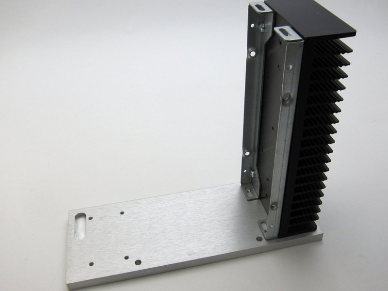

From the build guide for a picture of the normal internal screw places.
