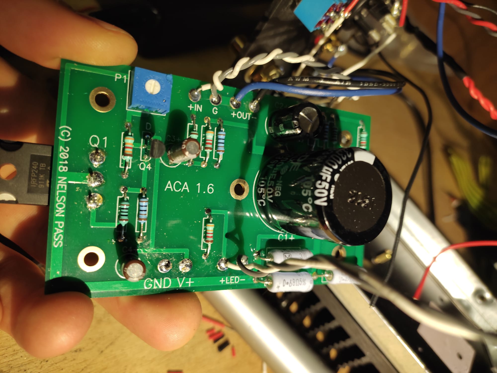

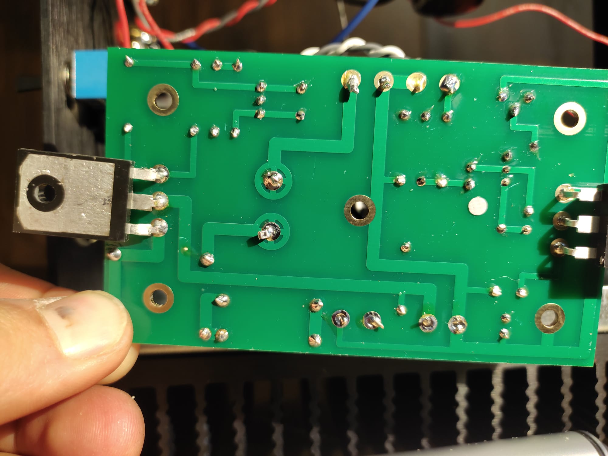

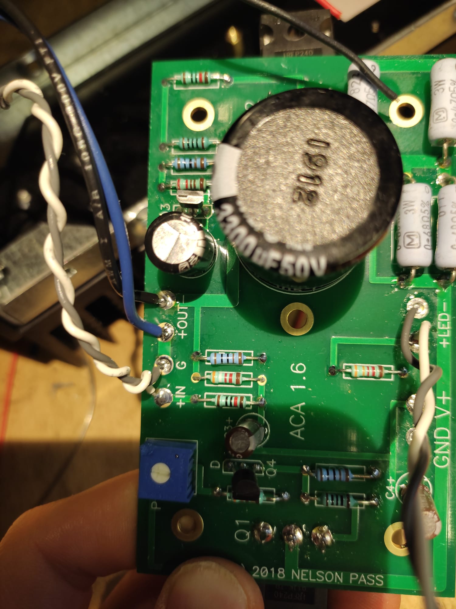

This is my first amplifier build so excuse the questions but I just finished putting it together this afternoon. I plugged it in and saw some smoke. I tried a few things but kept seeing smoke coming from mosfet Q2. After a while, the LEDs started flashing on and off. I read elsewhere that the power supply goes into protection mode when there is a short and oscillates between 24v and 5v. I then found a short on one of the boards and I think one or both of the IRFP240 mosfets are now dead.
Not sure what the best plan of action is. I guess I should order some more of those mosfets and hopefully that will resolve the issue, are any other components likely to have been damaged?
Any suggestions are welcome.
I've attached some pictures of that board.

I've removed it now and stupidly didn't take a picture... It was a piece of excess wire on the underside of the PCB and I'm pretty sure it was connecting the ground at the LED to the trace between R3 and R4
That might kill Q2 perhaps.
Do resistance checks (especially round Q1 and Q2) on the board as per the build guide 'trouble shooting' step 56, it might give another clue. https://guides.diyaudio.com/Guide/Amp+Camp+Amp+V1.6+Build+Guide/5#s145

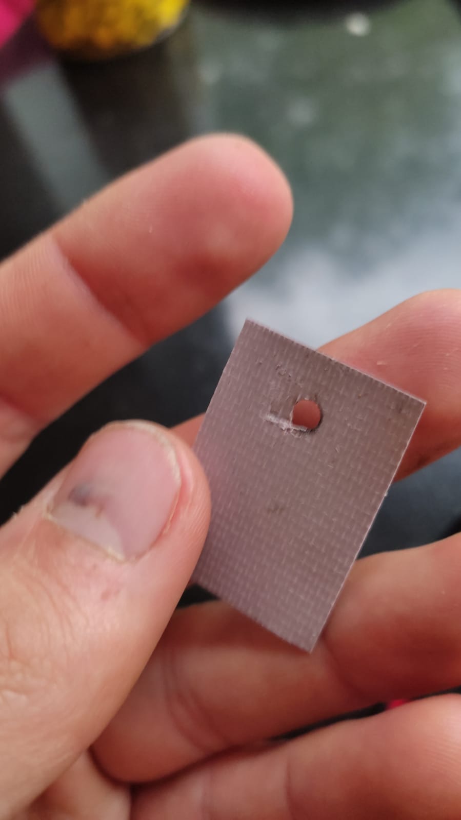

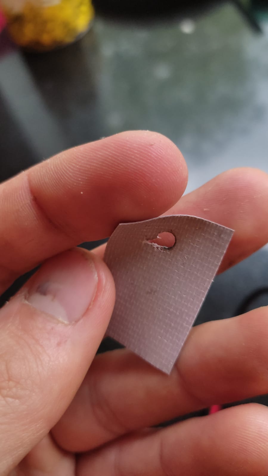

Thanks, just did that and mostly seem to be alright especially around Q1 and Q2. I just checked the keratherm insulation and here are two pictures of the one under Q2. Do you think that tear could be enough to have created a short?
The metal tab on Q2 is connected directly to the Drain. If it was shorted to the heatsink then it would short out the 24volt line and give the pulsing symptom you describe.
That is a strange tear and you need to replace it. Is the black ring from Q2 or a burn mark? Any stray solder blobs or loose strands cause shorts, be meticulous on re-assembly. Check with your meter that it is not shorted too.

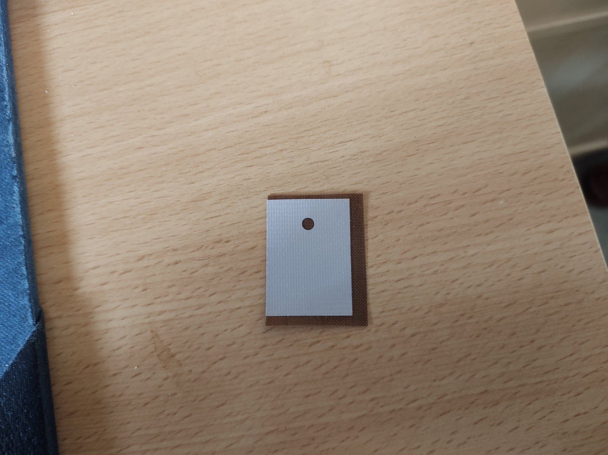

Okay, I'll take my time on re-assembly and I believe the black ring is a burn mark. I'm based in the UK and I can't find anyone with 86/82 with precut holes in stock but I did find this
https://www.rapidonline.com/Kerafol...9_1651697443_585d3f1ce055a4188fde9e0f091c2491
which I could use to cut suitably sized pads. I gather the mounting hole needs to be precise, do you have any good suggestions for making the hole as precise as possible?
I use a 1/8" (3mm) hole punch for my insulation/heat transfer material.

That is the same one that I use, although any 1/8" (3mm) paper hole punch that can be purchased from a crafts or stationery store or from Amazon will most likely work.
