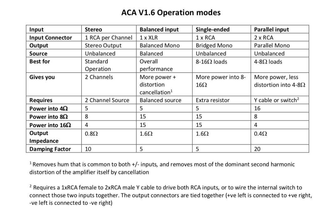

Hi All, I have two 1.8 version kits on the way. I have a question about monoblock use. My Ref3A DeCapo I speakers support bi-wiring. Has anyone connected their ACA monolocks this way? Each monoblock configured in bridged mode, then connected so one output channel drivs the woofer and one the tweeter. The DeCapos are considered a fairly benign load, and in fact there is no real crossover used in them. The woofer rolls off naturally and the tweeter just has a high pass cap. I suppose there would be little or no power advantage to be gained anyway?

that would be not bridged but mono-for-biamping
yeah, worth trying, all 3 arrangements yu can get:
then leave what you like more
- mono-for-biamping mode ( parallel inputs, then one output to bass, second to tweet)
- parallel ...... parallel inputs and parallel outputs, intended for heavier (low R) loads, feeding complete box

Yea, i have tried them in twin biamp active mini DSP HD stereo, single passive stereo and twin passive parallel mono.
Twin Paralell mono, is the lush, muscular and musically juicy King setup in both of my setups: The Really Really Big 95db/W/m 4 ohm and medium small standmount 86db/w/m, 4 ohm speakers.
But that is no insurance that it would be the king setup in your stereo.
Thanks guys, I am guessing monoblock parallel inputs and outputs feeding complete box will win the challenge, but I will likely try them all.

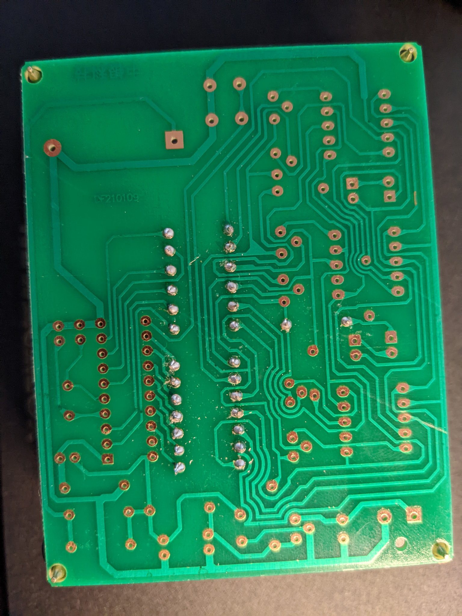

I have two ACA kits waiting to be built, but I have never soldered until today. I have a cheapo digital clock kit that I did my first couple of attempts at. They all test to the correct resistance. I did not use Flux, how important is that? Are these clean enough for a good AmpCampAmp build?

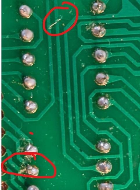

Are these solder splashes (so possible shorts)?
Make sure the iron is hot and use a good multicore flux solder (not a lead free one). Do not carry solder on the iron to the joint but apply the iron and solder together on the joint.
Use a toothbrush or similar to gently brush the board to remove any solder and flux bits.
Thank you. That's exactly the feedback I needed. My eyes weren't going there at all.Are these solder splashes (so possible shorts)?
I will check that out. And also be more careful when I hit the actual ACA board.
