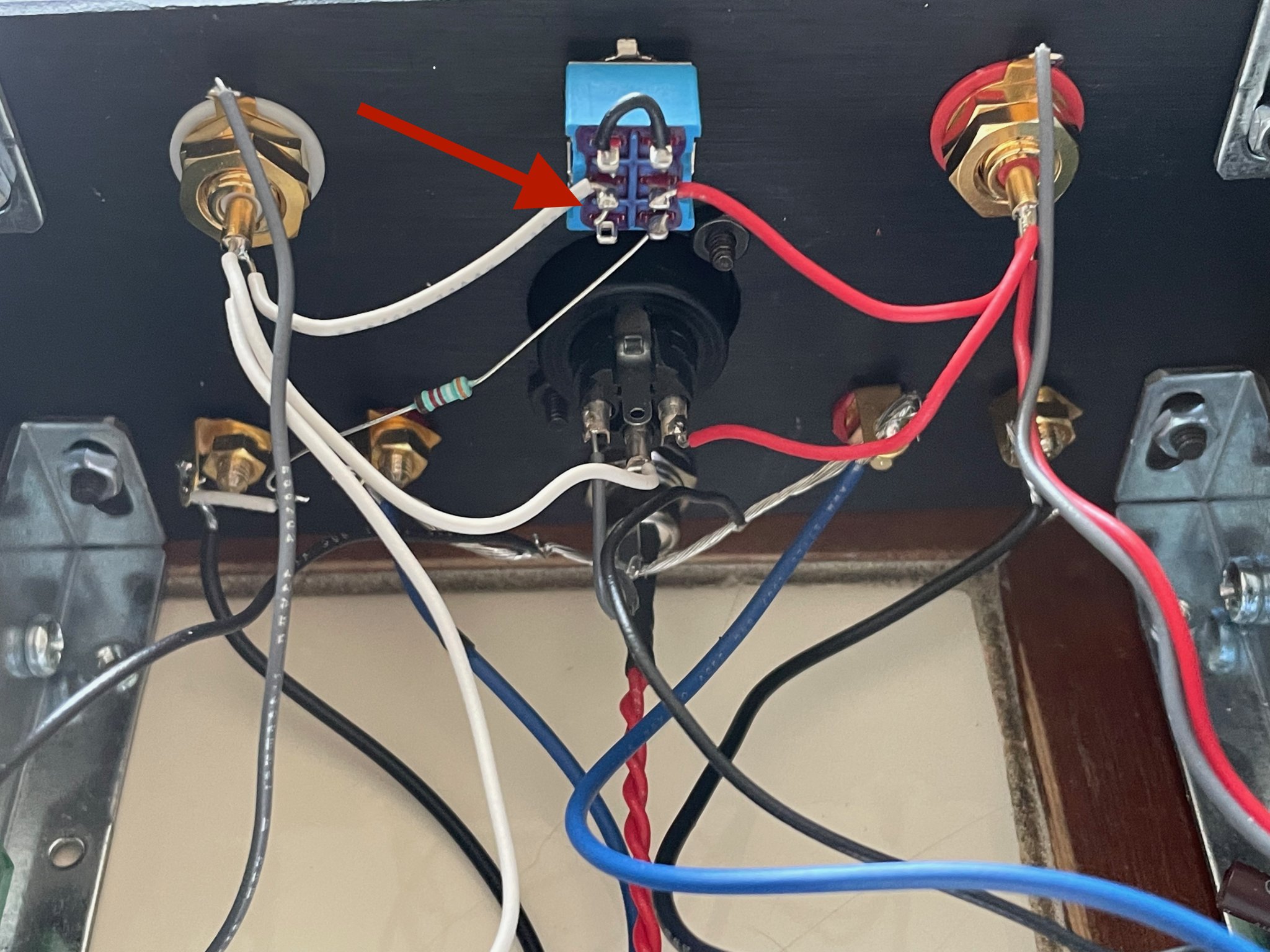

Not sure what you're asking. What does not make sense about the rear pins on the switch?
... if wired properly, and with the switch in the correct position (up)
the signal goes in through channel A's input,
get's amplified on the channel A amp board
in addition to the signal being on the black output post of channel A, it get's routed back through the 39k resistor to attenuate the amplified signal
over to channel B's input
through channel B's amp board where it's inverted yet again.
Now you have two amplified signals at each black terminal. One in-phase with the input signal, and one inverted. (Simple diagram attached).
Since this is an SE Class A amp, it should not matter at all re: the switch position for the devices / sinks to get warm. They're warm even without a signal.
So, two things are odd....
1. That the mode selection switch seems to turn off one channel (very odd to me).
2. That it worked in stereo. That's good. At least you know you've got something to work with and that both channels actually do work.
More pics, please, and please indicate which channel is "turning off". Please use A and B vs. L and R for ease. Please just say red or black speaker terminals for ease also. They're not 'negative'.

For 'RCA bridged mode' the two inputs are Not connected together. You use the White input, that feeds the White channel, the White channel output then feeds the Red channel input via the 39kΩ resistor.
(You join the Red and White channels for Parallel mode.)

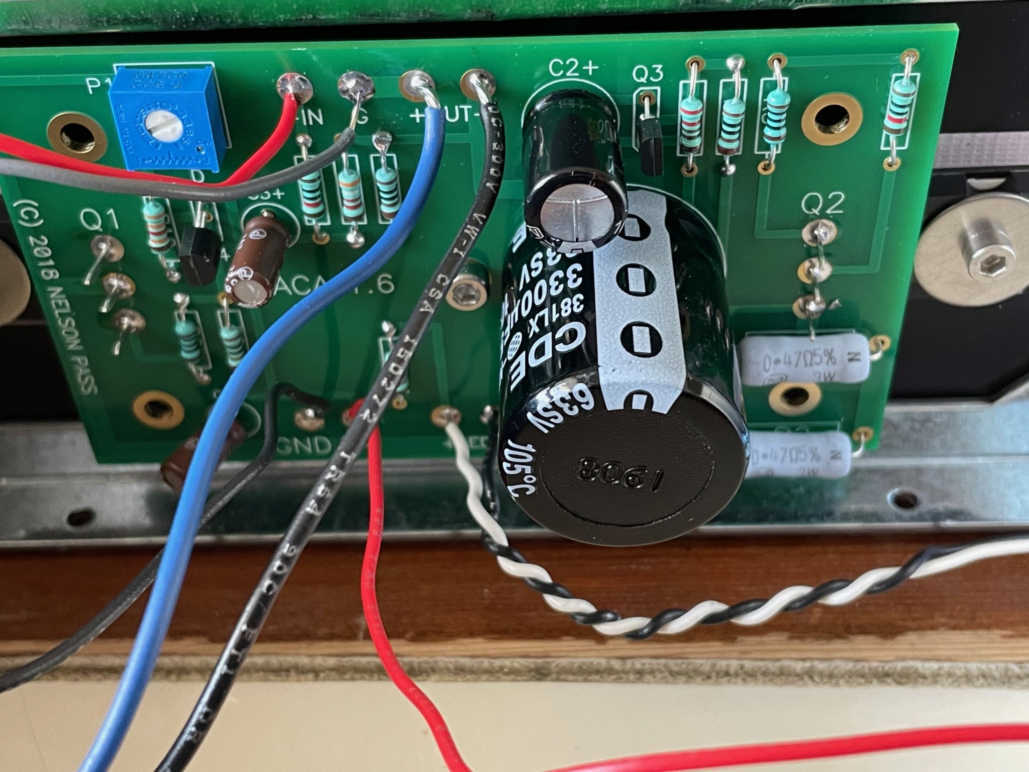

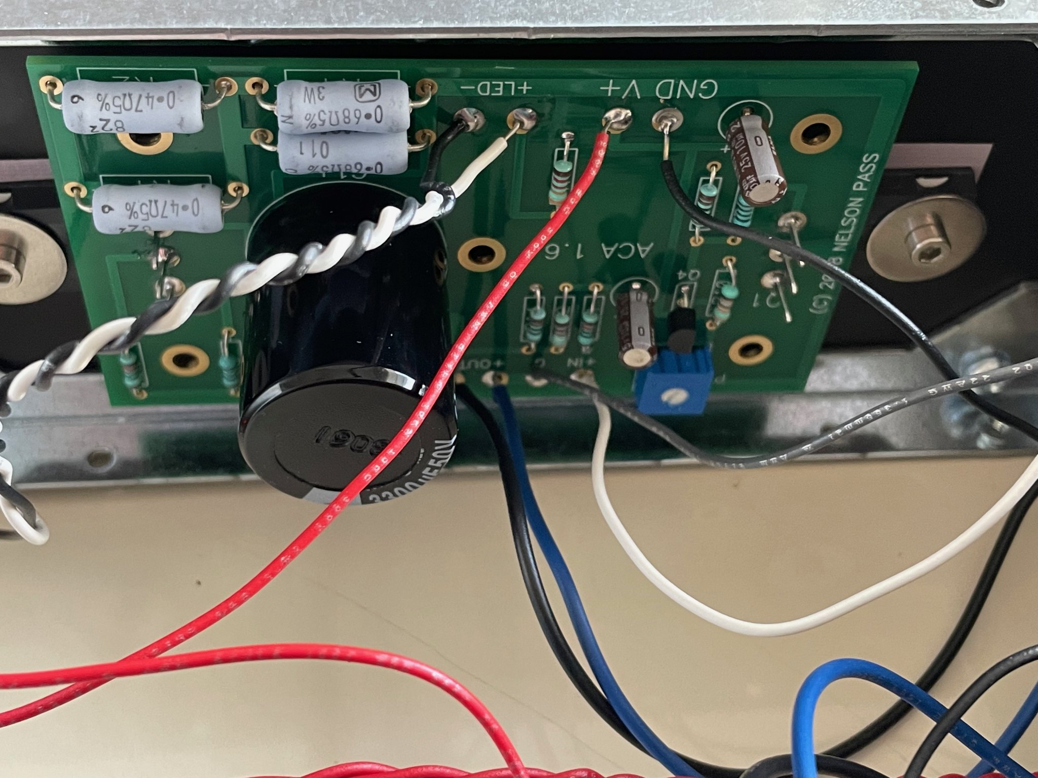

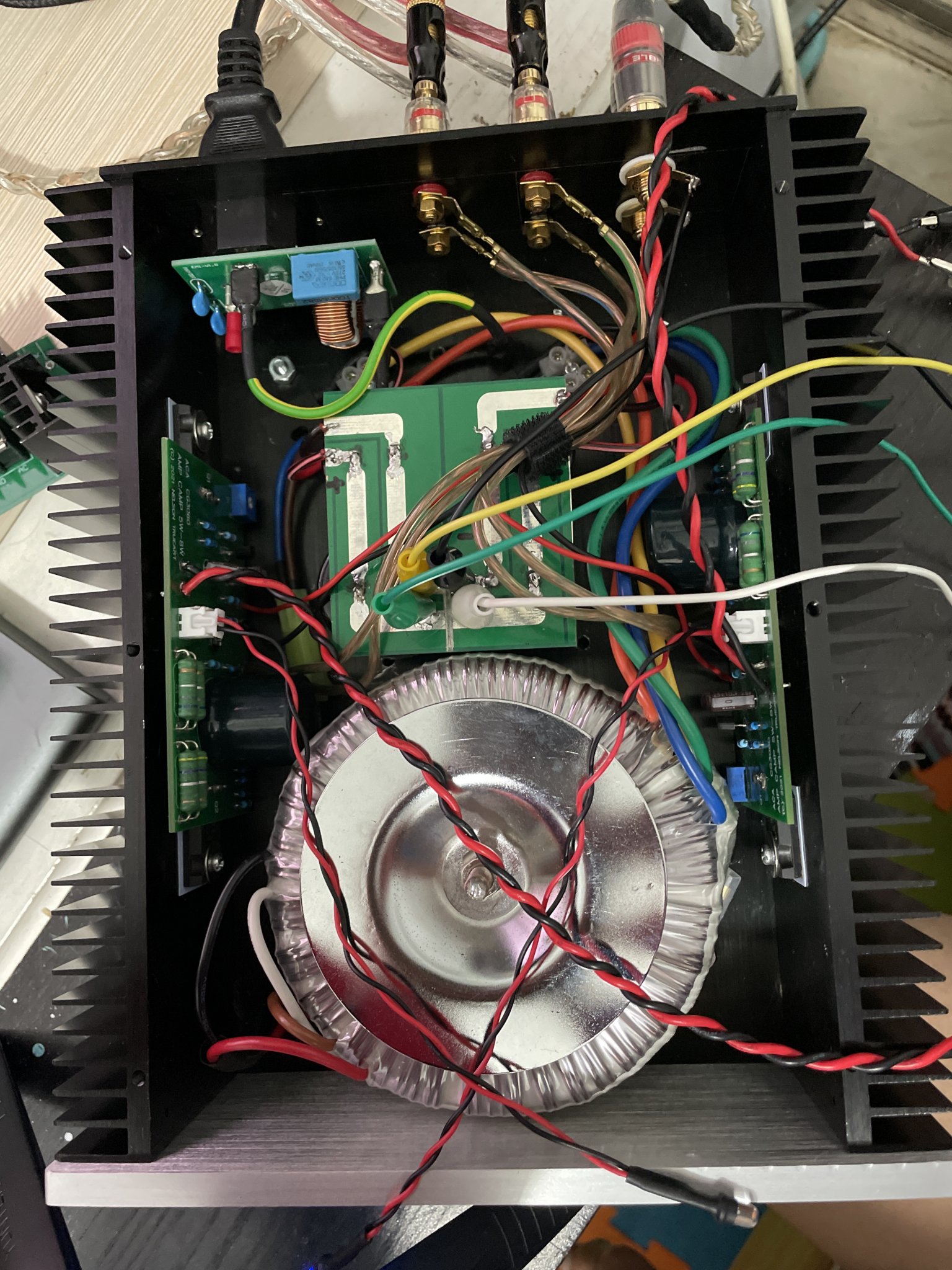

Hi, Just finished my first DIY project the ACA!! Well, not exactly finished... So, when I turned it on after the build in stereo the left channel has about half the volume as the right channel; however when I drop the switch down to mono both speakers have the same level, but mono signal... looking for a place to start with troubleshooting!! Halp!!!

@KevinHeem and @6L6 I am good... turns out the issue was with the source... although not sure why... I was using a macbook pro secra 2015, with a dragonfly blue plugged into usb.... when I used regular headphone out the issue went away... what is odd, is I checked the dragonfly with my headphone w/ no issue... anyway, the amp appears to be working as described... thanks again.
