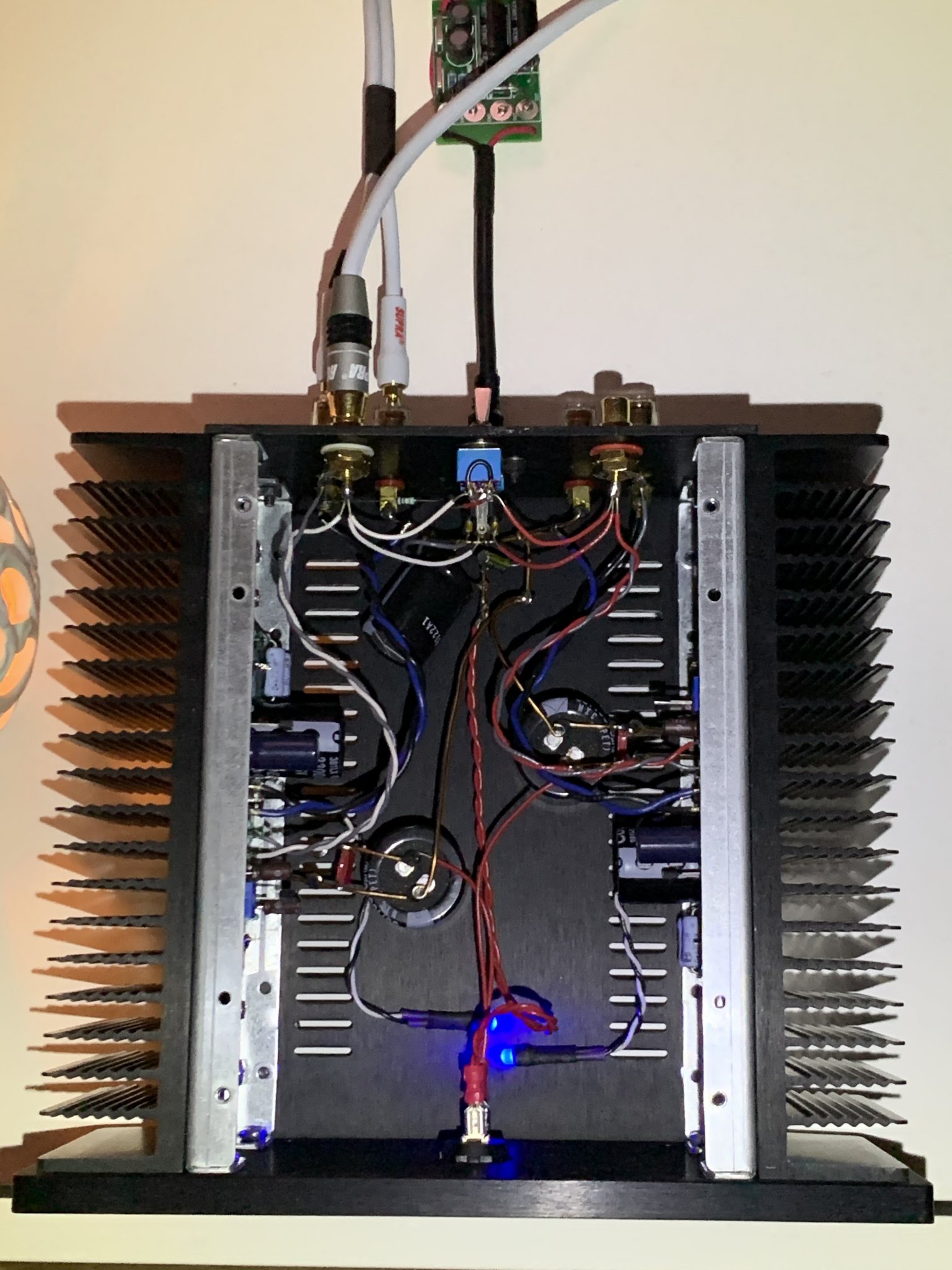

Single input like in bridged mode but two speakers like stereo. Switch stays in bridged mode.
You are checking that the single input is driving both channels. You could also connect one speaker at a time if you feel better that way. The amp with play a mono signal..
Just a thought any chance you are connecting to the incorrect input. Both amps should be connected to input A
The problem may be that only one side is working on the "Weak" amp when it is in the "RCA Bridged" mode. Check both sides are working by connecting speakers like the amp was connected in Stereo mode. The speakers will be out of phase, it's just a test to see if both sides are working.
This was brilliant! So yes, the right channel is not working in the "weak" amp when in RCA bridged mode. I double checked the other amp and it's ok. SO, now the question is why? Any thoughts on where to look first?
SOLVED!!! After figuring out the right channel wasn't working in bridged mode, I traced the connections again and realized that I wired the resistor to the wrong side of the switch! My rookie mistake and I don't know how I missed it looking again and again at the switch wiring. But OMG they sound awesome!! Thanks everyone for their help! And thanks to Papa for a great little amp (and I'm a bit embarrassed that he had to weigh in on my noob mistake but grateful for his assistance to this DIY community!)

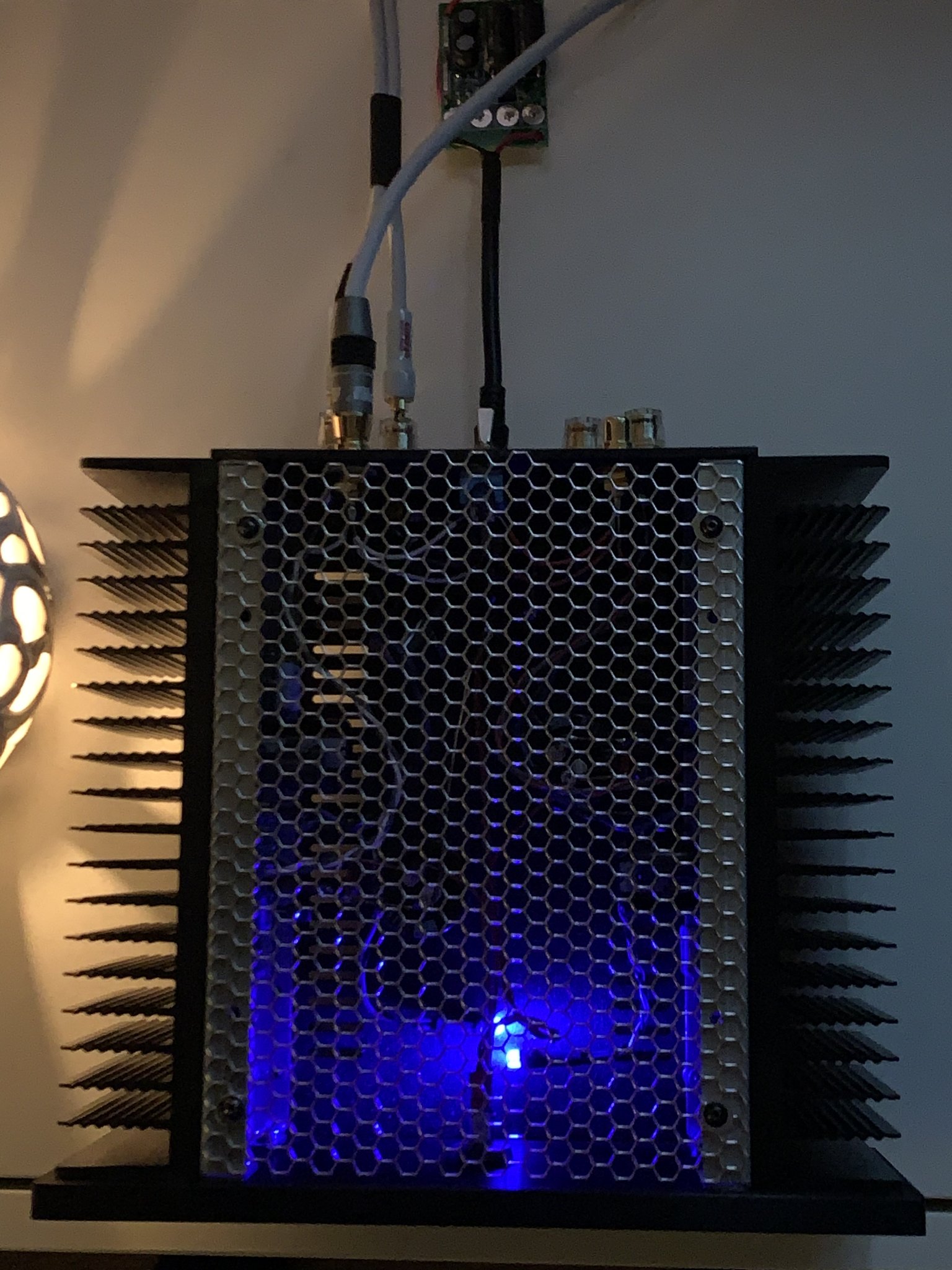

Teh left channel now playing! Parallel mono muscular bass power 🤗
Aluminium hexagonal mesh top makes teh juicy and warm Amp Camp Amp take some of them fresh and funky chillz 😎👍
