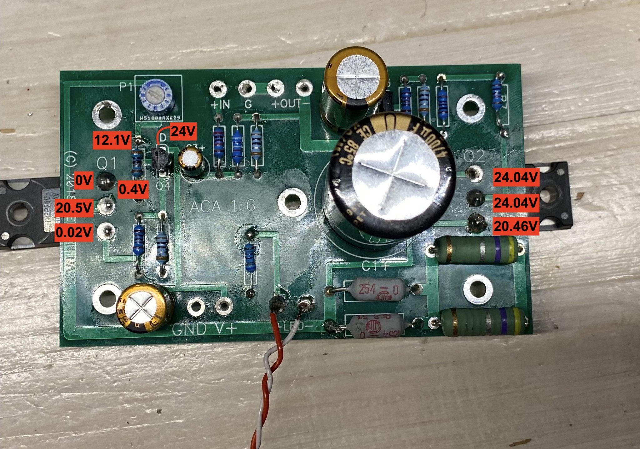

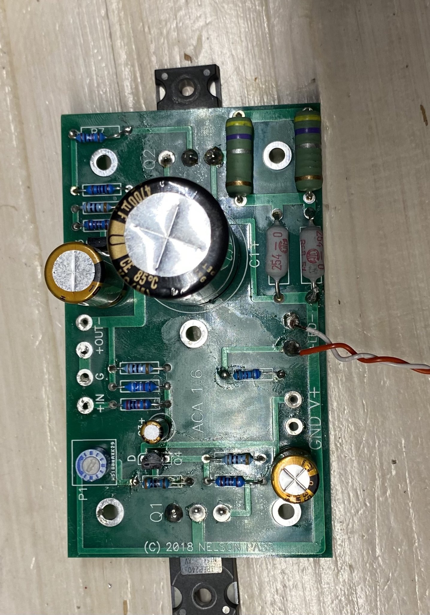

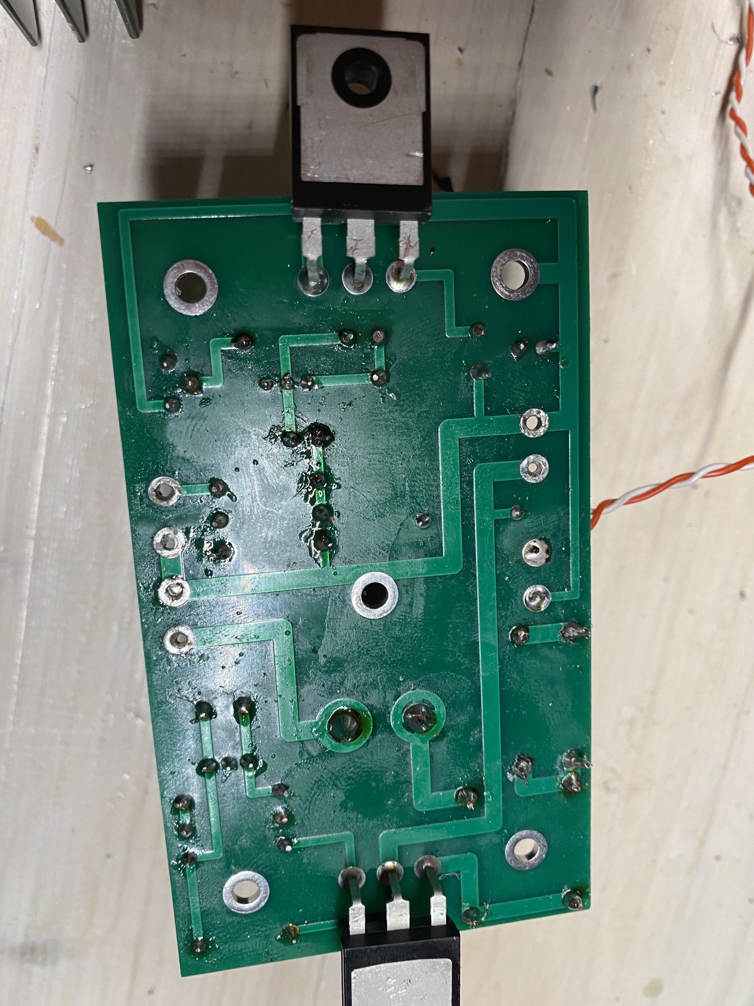

I am very new to the whole electronics-business, and chose to build "premium parts" version of the aca amp as one of my first soldering projects. After plugging it in, it unsurprisingly didn't work. One channel is getting hot, the other stays cold, neither is producing any audible output. I have started measuring resistances and voltages according to the troubleshooting diagrams in the build manual, but I am unsure whether the values also apply for this version. That thing, many values are off by quite a bit. One thing I did noticed and found weird is that the voltage going into R10 is much higher than the voltage coming out. The input value obviously depends on P1, but the output is somewhere in the 200-500 mV, in any case way lower than the expected voltage at the gate of Q1. Another thing is that the voltage on the middle pin of Q1 does not change when turning P1.
I checked most of the connections and could find a cold solder. I have no real idea what to check next, and unfortunately I have only access to two multimeters without diode testing. Testing the transistors is therefore possible, i guess, but I hope there are things I could check before getting into that. I have attached pictures of my mediocre soldering job and a few selected measurements, if this should be of any help. I realise that there could be quite a few issues here, so any help in narrowing down is greatly appreciated!
Working off pictures isn't easy 🙂 but from what I can see there may be an issue around Q4.
Can you check that R6 and R9 are correct. R9 must be 1k and you look to have a 1 ohm there (brown, black, black, silver and brown)
At the ACA, no gold or silver should appear on the five ring resistors,
As Mooly hinted R8, R9 and R14 look suspicious.
