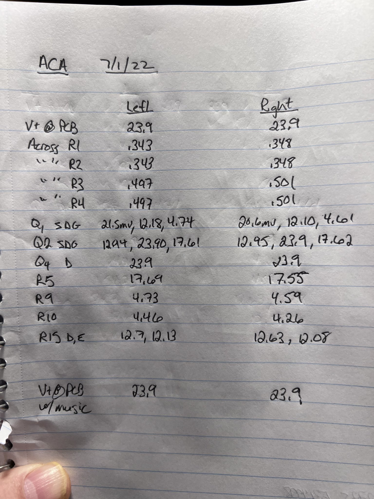

I noticed today that if I tried putting my stock ACA on a pair of 6ohm/92dB speakers that I get the right channel LED slightly pulsing (mostly with the music). I saw this one other time on the same channel with a very easy to drive set of speakers, then it stopped. It only does it with music playing. I don’t notice any noise or difference in volume. Any ideas what to check? I know those 6 ohm speakers are not gonna work, but was curious to see.

What power supply are you using? Is it a suitable SMPS?
The LED changes brightness because of a change in LED current and that can only be because the power supply voltage is being modulated by the music. Although the ACA is Class A the rail current is not a constant.
I did that the first time I saw it happening 6 months or so ago. All the voltages checked out fine against the build documents. I'll check all the voltages again tomorrow. Thanks.With no music playing you need to check the volt drop across either 0.47 ohm or either of the 0.68 ohm resistors for both channels. You should see around 0.37 volts across the 0.47 ohm and around 0.54 across the 0.68 ohm.
That is the first thing to check.
Those voltages are critical because they tell us how much current the ACA is drawing.

As it is the same right channel each time it suggests there is a 'high' resistance connection from the switch to the board? It might be 0.1s of an ohm, but at 1.5 amps it will show. Measure carefully the +ve to -ve voltage at the faulty board, does it fluctuate with music? If it is stable check the LED wiring perhaps?
This is just a shot in the dark, but have you tested your AC line for voltage? You might have a drop in voltage on the actual line itself.Here’s the voltages I measured. The right LED still slightly pulses. It doesn’t go dark. It’s just enough you can tell it’s slightly dimming.
It only happens on the right channel. When I measured it with music playing the voltage at the boards never changed, but the LED would very slightly pulse, so I don’t think it’d be the mains. I’ve never measured it below 120V. Usually it’s 122-124V. I don’t hear it affecting the sound at all. It might be just a flaky LED? It’s just annoying as I notice it when I’m listening and staring at the stereo rack. Maybe some black tape 😁This is just a shot in the dark, but have you tested your AC line for voltage? You might have a drop in voltage on the actual line itself.
Thanks, those voltages all look good and show the basic current draw is fine.Here’s the voltages I measured. The right LED still slightly pulses. It doesn’t go dark. It’s just enough you can tell it’s slightly dimming.
Try what Nelson suggests and I'm also going to add to try swapping the speaker load from left to right just to eliminate anything weird with the right channels load.
I would doubt that really, particularly if the brightness responds to the music and volume level.It might be just a flaky LED?
