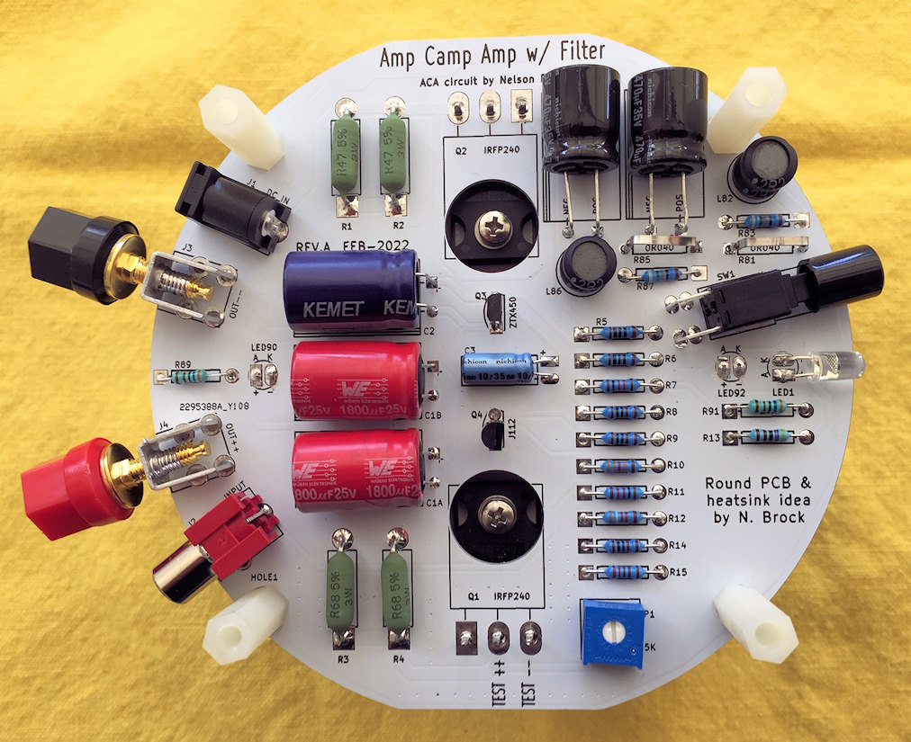

I set the voltage over Q1 to half rail but the same measurement over Q2 is low. 24v PSU, I set to 12v but Q2 is 10.6v.

The V+ wire to the right channel is too short to reach the left channel pad.Can you flip the supplies to the channels, and if so, does the pulsing stay or move?
I tried flipping the speaker connections as well as the inputs. No change. Now that I pay more attention it’s doing it without music once warmed up good. I measured the voltages going into the LED resistors and they are a solid 23.9V. But, on the left channel the LED stays at a constant 2.78V. The right channel fluctuates between 2.64 to 2.72V. I wonder if I just have a bad resistor? The solder joints look good and I’ve chopsticked it to see, but no effect.Thanks, those voltages all look good and show the basic current draw is fine.

edit. Reflowed the solder joints on the LED resistor to no change.
As a quick check I desoldered the negative leg of the LED. Connected a temp blue LED with clips and no flicker. Has to be the LED I think.

It would seem so. LED's are quite heat sensitive. I always use a croc clip as a heat shunt when soldering them if possible.As a quick check I desoldered the negative leg of the LED. Connected a temp blue LED with clips and no flicker. Has to be the LED I think.

This is the first LED I’ve ever had so that. Should have been the first thing I checked. At least everything has been gone over!

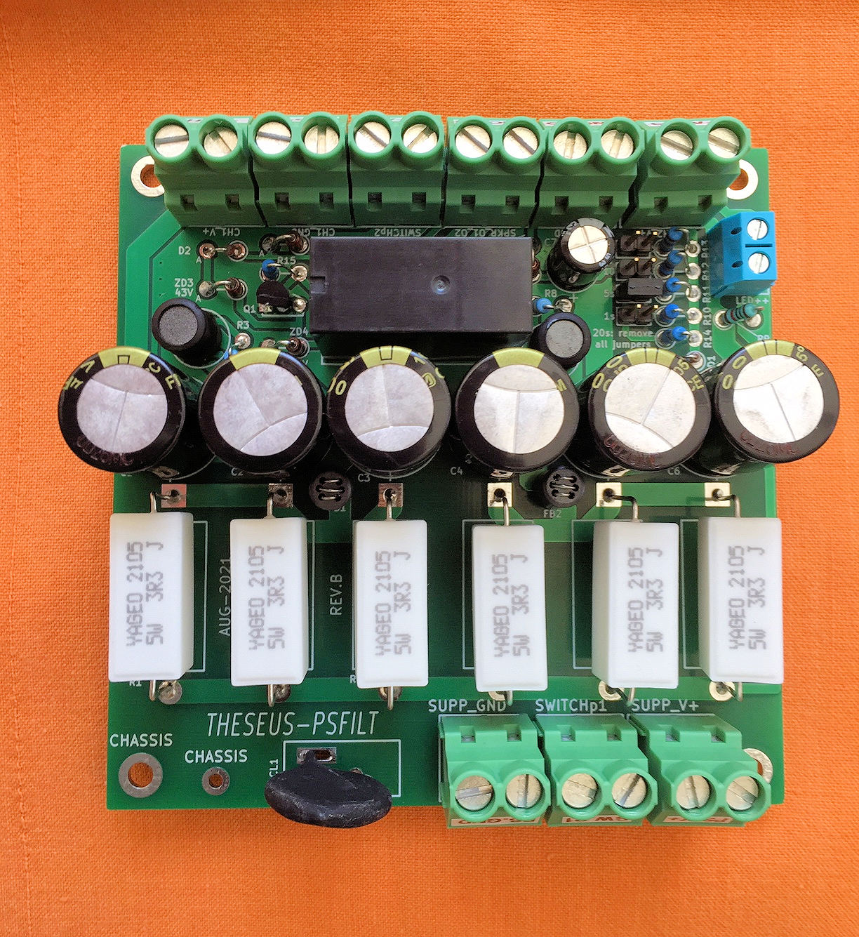

If you're a severely demented lunatic you can insert a Ship Of Theseus PSFILT in series between the SMPS and the "RACAM" / "Nelson Brock Hedgehog with Filter" . That board includes LC filtering, plus RC filtering, plus ferrite bead filtering -- to get rid of both SMPS high frequency noise, and 100/120 Hz mains hum, which it may surprise you to learn, often appears on the output of a switcher: MeanWell 100Hz noise plot from their own test report attached below.
Each of the two PSFILT DC outputs can supply about 2 amps, which is enough for a pair of stock unmodified RACAMs that draw ~1.7 amps each.
