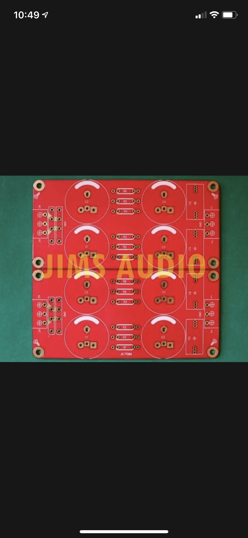

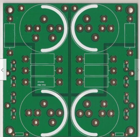

I am going to use the below CRC filter board for a pair of Amp Camp monoblocks but would like to use chokes instead of the resistors. Can someone point me in the right direction for choosing the correct choke?
The seller of the board recommended a 1mH airgap iron core choke but cannot find an exact one mouser.
Each ACA board draws 1A of current. You mentioned monoblocks. Would that be a single board drawing 1A or two boards drawing 2A total?
Your power supply board is capable of two CLC supplies so I assume each CLC section powers one monoblock.
If each monoblock has two amplifier boards drawing 2A total, either of these chokes would work:

If each monoblock has only one amplifier board drawing 1A, this choke would work:
Hammond 154B

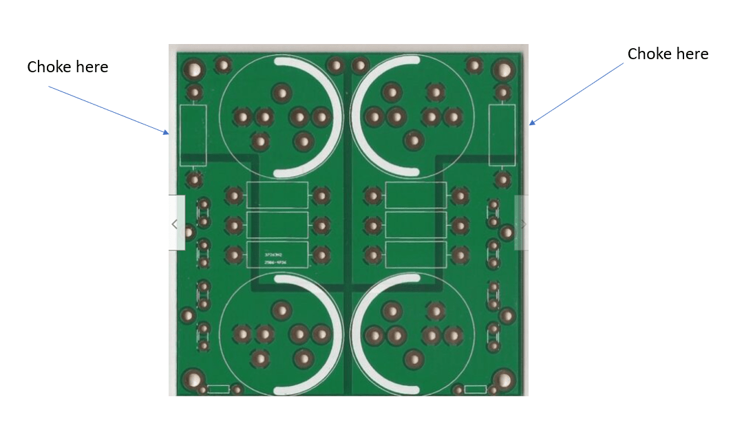

Ok, so you are building dual mono amplifiers so yes, one 154B per channel.
I would connect the chokes to the PS board at the CRC resistor location for CLC.
Yes. The location I pointed out on the board is the exact location the seller described I should put it and it matches the location where the other 3 resistors are.

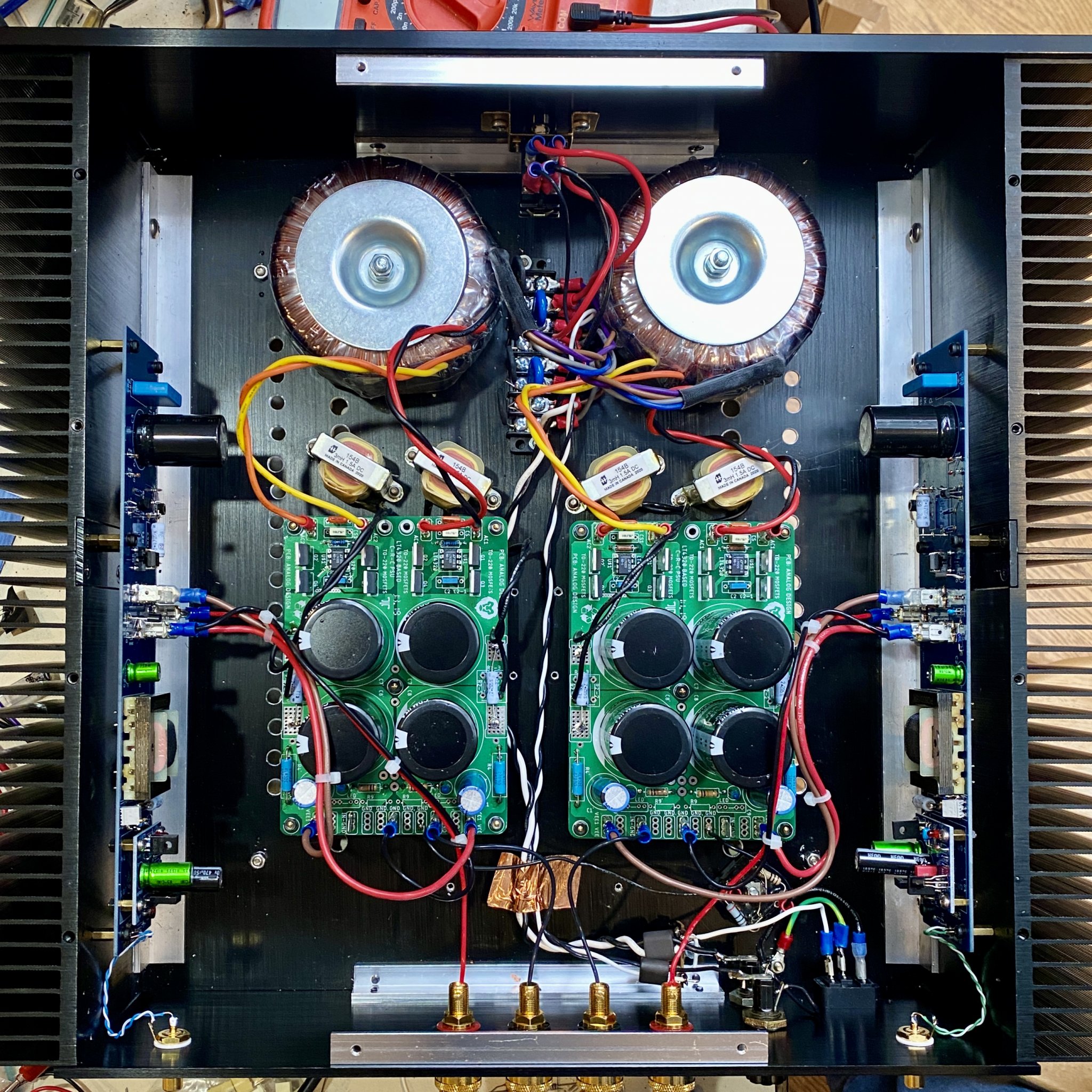

I like the Hammond 154B. I used a set in the re-build of my M2x. Out of an abundance of caution, I added a 2.2 Ohm resistor in parallel with each choke. Helps bleed a small amount of Dc current from the choke and tames any incipient inductive ringing.

The M2x will actually be my next amp and it’s halfway done. Can you show me how you added in the 154bs? I also purchased the sellers dual mono dual rail board and was going to use 22,000uf caps and it would be cool to use 4 of these chokes ipo the resistors if they will also work..
I would recommend using 27,000 uF caps or better for the M2x.
The boards I used incorporated synchronous rectifiers. If you use block style bridge rectifiers, look for ones with a low voltage forward diode drop.
