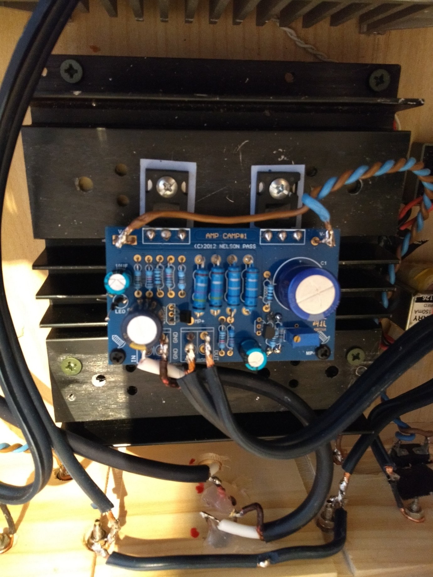

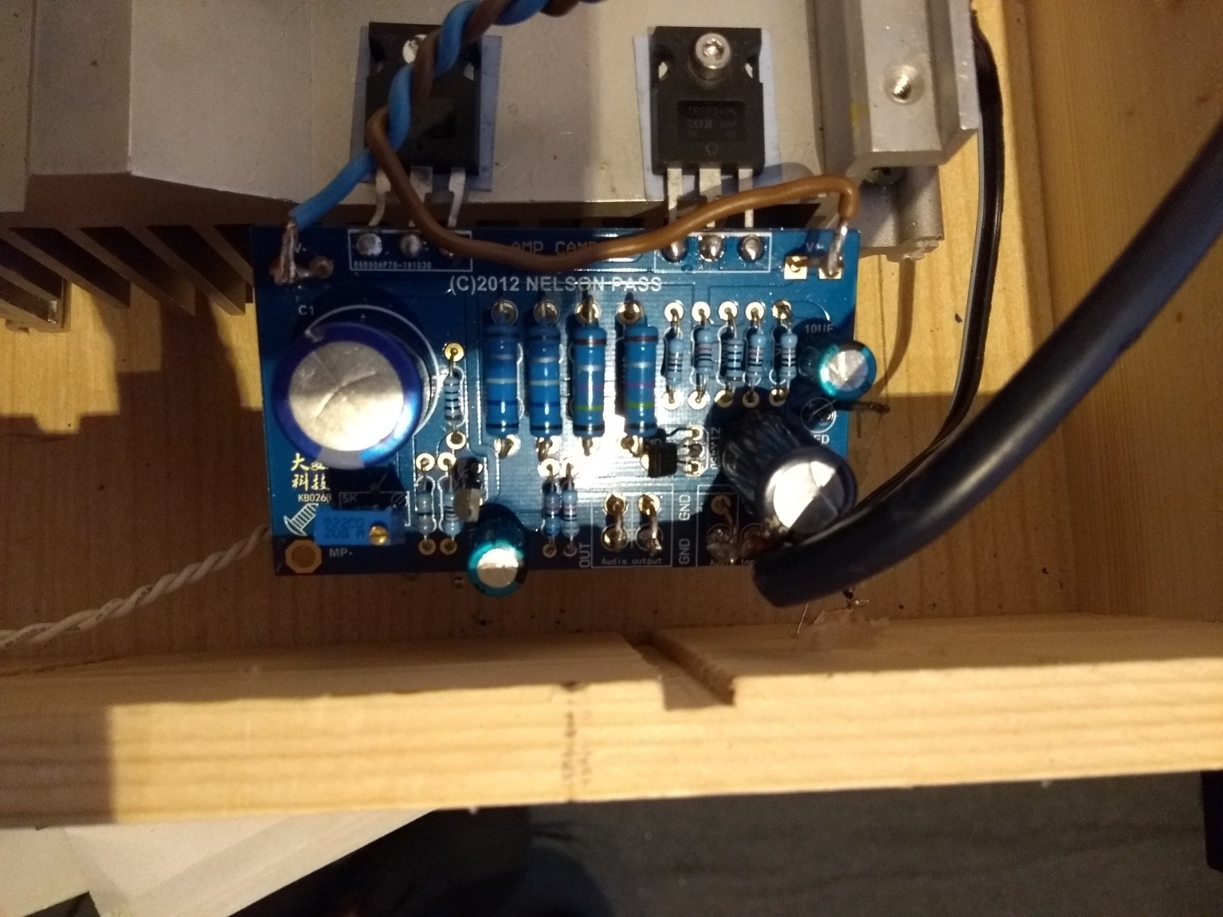

Couple of pics below. if you were to put the two boards side by side you will see the difference. The board on the silver heatsink is the bad board.
If there is doubt then switch off and do a quick resistance check from each transistor lead to the other components they are supposed to connect to and make sure that both boards are the same connectivity wise.
