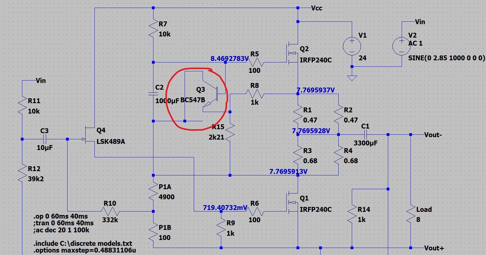

No it is connected to Pin 3 - SWorking off piccies is not easy tbh... however...
Do these join together electrically.
As it should. I just wanted to be sure with you mentioning reversed do-dahs and upside down FET's 🙂
I really don't know what to suggest beyond you checking in detail the connectivity of each pin and part and checking they match the good channel electrically. From a purely theoretical point based on what results you are getting Q3 fitted incorrectly would give the same kind of results that you are seeing, The voltage on the gate of the lower FET would be input FET and preset position dependent but that doesn't change what is happening here.
I'll show you this for interest but remember that in simulation models do not behave exactly like real ones, particularly if incorrectly fitted and biased... however... here is Q3 fitted so that it presents as a forward biased diode from (effectively) gate to source.
I'll look in again tomorrow. Once you have identified in your mind which FET is which just do simple resistance checks from the pins to the parts that are supposed to connect to those pins. That should lead you to Q3.
Check that the same pin position on Q3 connects to the same part as the good channel.
If you can not find any obvious issue then swap Q3 but be sure to check that the pins of Q3 really do go where they should. Use a data sheet diagram for the pin outs for whatever transistor you decide to fit rather than just relying on the board markings.
IT WORKS!
However, I have a little egg on my face 😡.
As I was checking continuity looking at the LT Spice layout It occurred to me that I had not thought about an additional resistor wired under the board between E of the ZTX and R8 (1k)
My mate bought me the first set of boards for christmas (which were not handed) and informed of a tweak that would give an extra watt. Adding a 2.2k resistor as mentioned above. As you know those boards have been working fine,
When I was checking I measured continuity and ohms between E (or what I thought was E of the ZTX and the OR68 resistor that the 2.2k is attached to. The Good and Bad board were showing different readings. I suspected that the leg of the 2.2k was not soldered to E of ZTX. I removed it and resoldered to the other outside leg and BINGO. Looking closely at the solder masks of both boards showed that they are different and despite the screen print suggesting that the ZTX on the bad board be installed in the same orientation that seems not to be the case.
I will give it a proper listen to later, but early indications are that it is fine. No hum and whisper quiet.
Thanks to everyone that helped me out with it is very much appreciated. I suspect that if we were not having a heatwave here in the UK and hanging around the house a lot I may not have been so didligent in my fault finding.

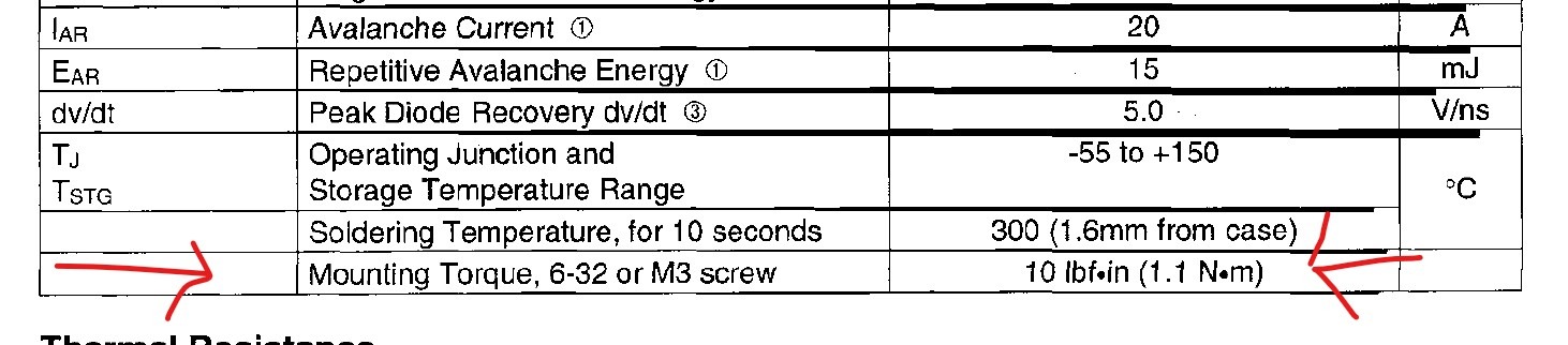

I could be wrong, but I think the purpose of the 'bumper washers' is to apply uniform pressure to the mosfets (against the heatsink) rather than to dissipate heat themselves. A good idea in itself which also makes over-tightening the bolts less likely. (ZenMod has referred to poor quality bolts fracturing while being torqued down - I find it hard to imagine applying that much pressure but you do want max possible heat transfer.)

Its difficult to visualise just what has happened then with the layout differences. I would say it is worth you checking the voltage dropped across the 0.68 and 0.47 ohm resistors is similar to the other channel. I would expect around 0.54 and .38 volts across each of the 0.68 and 0.47 ohm respectively.
It will be as davidjt suggest. The data sheet for the transistors actually gives a mounting torque and it will probably not be as high as you might think.PS Does anyone put large washers on the front face of Q1 and 2 to disspate heat? I did this on the other amp.
Thanks Mooly. I will take some readings. I have just had my first 30 mins with it and these things amaze me. IMO the SQ is up there with some of the best.....mind you my ears are not as good as they once were 🙂
Yes 1Nm is nothing at all really. I do a lot of cycling and my own maintenance and some of these settings are only 7Nm which seems too little to me.

Voltage Drops.Well that's good 🙂
Good Board 0.68
0.48v (consistent across all)
Good Board 0.47
0.33 (Consistent)
Bad Board 0.68
0.48v (Consistent)
Bad Board 0.47
0.33v (Consistent)
Those are all fine and show the bias regulator is working correctly. So each channel is passing just over 1.4A
Q3's characteristics to some extent determine the exact values (the base/emitter voltage needed to bring Q3 into conduction).
So all good 🙂
So all good 🙂
Thanks very much again for your help.Those are all fine and show the bias regulator is working correctly. So each channel is passing just over 1.4A
So all good 🙂
