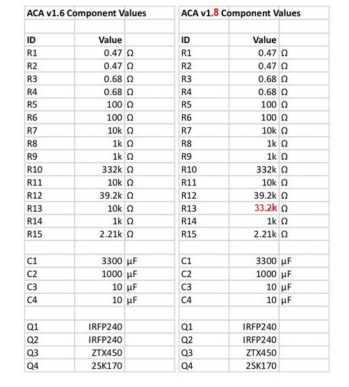

If you only want caps and resistors the parts list is itemised on the build guide (step 1 v1.6) Use 35 volt caps,

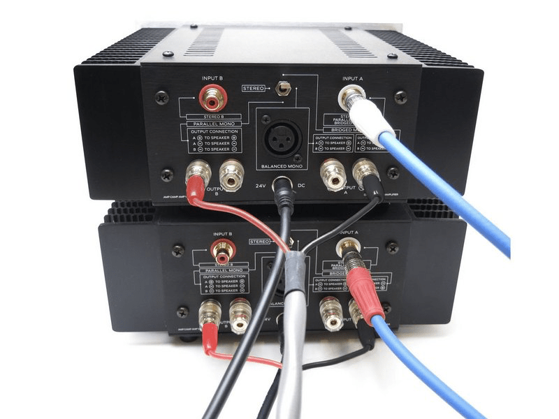

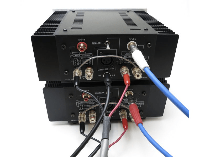

I built two kits and I LOVE them... question what is the difference between "mono bridged" vs "mono parallel" my layman's guess is the one runs the signal through both sides (Channels?) of the amp in parallel vs running it through one and then the other ? Or am I missing the concept completely.
Also the wiring for using the amps in bridged mono seems to reflect one thing in the picture but another in the description on the plate what are the right output configs for
There's Stereo, and then parallel, which is what you think it is, then balanced where each
channel is driven by inverted signals from a balanced source, and bridged, where there's
one single-ended input and the other channel is driven by the output of the channel which
got that input. The last works because each channel phase inverts.

Mono Bridged
Mono Parallel
Note the differences in switch position and speaker hookup in both, and the addition of a wire jumper in parallel.
Thanks 🙂 going to try the bridged tonight the parallel sounds great will be really interesting to compare.View attachment 1007017
