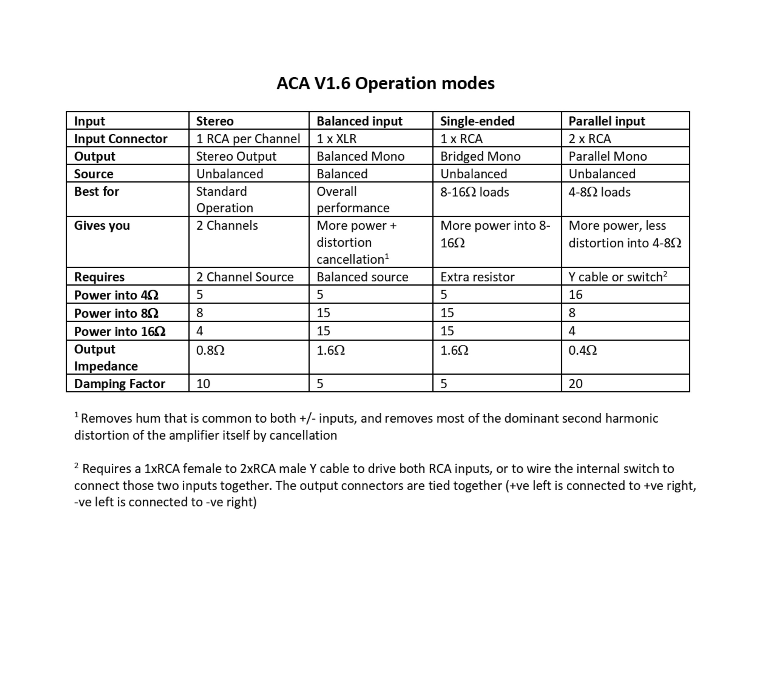

Here is the power output table. (V1.8 and V1.6 are identical.)
You will see there is no advantage in output power using 'bridged' monoblocks. For lower impedance speakers, parallel mode is the better way.

too heavy load when used bridged for 4R
for that, use them in parallel mode ( two channels , both inputs and outputs connected in parallel)
Thanks for the prompt response. This is very helpful to know. My speakers I designed and built, and they are a minimum of 3.1 ohm actually (at about 115Hz) and are below 4 ohm between ~85Hz and ~175Hz. At ~950Hz they dip to 5 ohms and rise from there up to ~6.9 ohms at 20kHz.
They are reasonably sensitive - the woofer is rated at 92dB @ 2.83V. They have wonderful quality, pretty deep bass down to about 30Hz; as they are mass loaded transmission lines.
EDIT: I now see Alan's post, and I have another question about the parallel input mode. My preamp has two pairs of main outputs, so am I correct is thinking that using two pairs of RCA interconnects, to connect the two right channel outputs on the Modulus to each input on one ACA, and the two left outputs to each input on another ACA - would yield up to 16W to each of my speakers? I am assuming the speakers would be connected to the two black (outside) binding posts on each ACA? Or, the amp positive and negative binding posts have to be connected together - internally or with outside jumpers?

Parallel mode is documented if your ACAs are V1.8, just follow the instructions in the V1.8 build guide step #17 (Amp Camp Amp V1.8 Change Information - diyAudio Guides)
If you have V1.6 ACAs, make a link to parallel the inputs using the XLR socket, then link the Black speaker terminals together, the rear switch needs to be 'down'.
You are paralleling both the inputs together and both the outputs together.

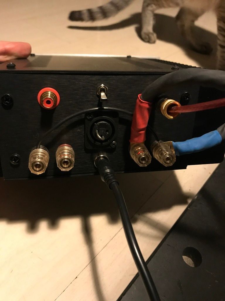

You'll need to explain precisely what you're doing before we can answer your question.
Assuming that you not only flipped the switch, but that you also wired your speakers and inputs appropriately for the associated switch position; there are a few options and likely many more. They are not mutually exclusive. Also, it's not supposed to sound different, but with certain speakers and in certain situations, they can sound different as it approaches clipping and/or if you're running bridged/balanced and nulling some distortion. On the flip side, running parallel, you may hear a difference if you run lower impedance speakers at 'higher' volumes and maybe gain a bit of bass.
Look at some previous posts re: how the signal runs through the two amp boards in the various configurations.

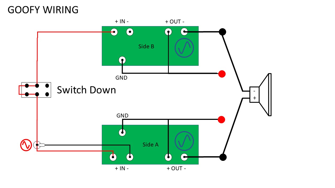

You still have not provided quite enough clarity for me to be sure. There are two bridged configurations. RCA Bridged, and XLR Bridged. I'll assume you wired it correctly for RCA bridged. See diagrams and post pictures if it's unclear.
Specifically, are you saying that you did not change the speaker wiring from RCA bridged (connected to both black terminals) when you tried the switch in all 3 positions and that you used the single RCA input on Side A for all three positions? In my previous answer I stated the assumption that you had run the amp properly and connected your inputs and speakers accordingly.
If you just hooked it up per Mono RCA Bridged and flipped the switch, then that's a different kettle of fish.
Again, see previous posts re: how the signal is routed at the three switch positions. If I've assumed what you've done (this time) correctly, then it's interesting that with one specific switch position that there was not a very noticeable change. With the switch in the 'down' position, (used for Mono RCA parallel) I think you'd have two inverted phase signals of the same amplitude running to each terminal of your speaker. That's again assuming that the speaker is connected to the two black speaker terminals, and if you're using only the one RCA input connected to "side A". That, in theory, should result in no sound at all. My ACAs are not within reach at the moment, or I'd try it myself.
Edited to add - See below for a diagram of how I think you may have done it, and the expected result.
I'm also assuming you built 1.8, and that you've wired it per the guide / correctly.
