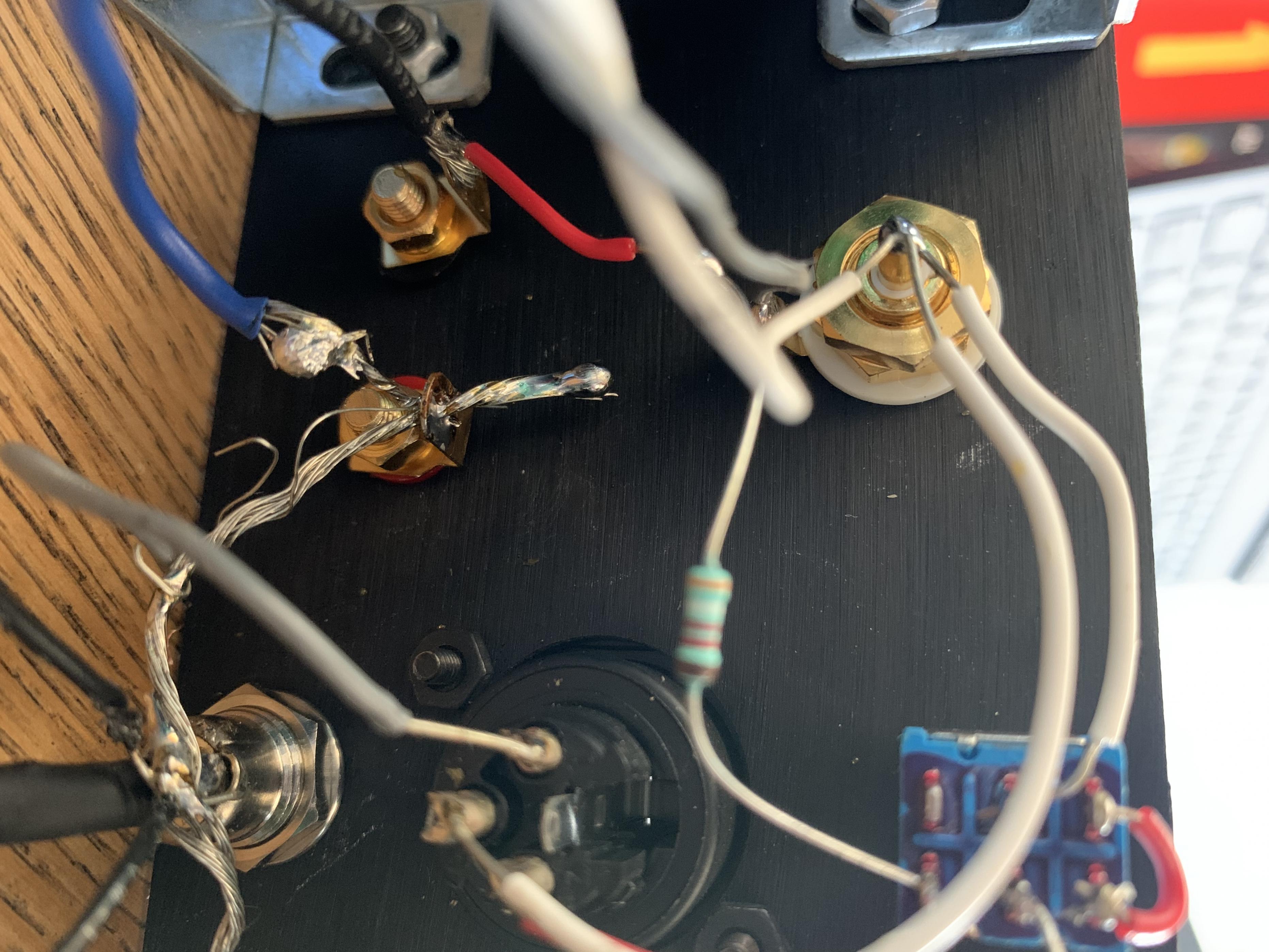

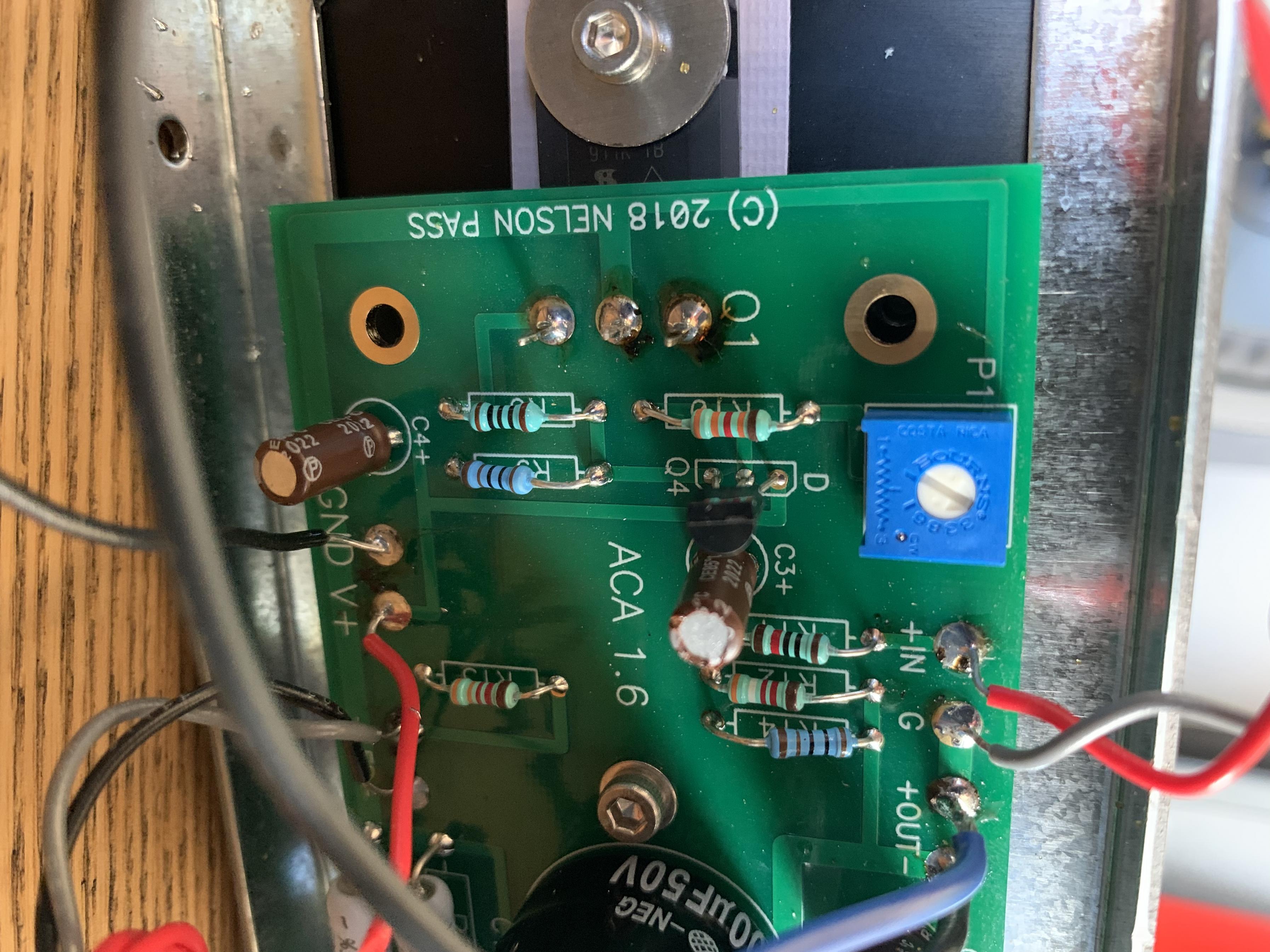

Please post some better pictures, of the back panel from the wiring side and flat on of each ACA board.

Sorry about the previous lack of pictures, it's been a bit of a nightmare to get them to upload. So the resistance of the speaker terminals being fed by the red RCA channel is 350 ohms red to black, and for the terminals being fed by white RCA the resistance is 980 ohms. For the RCA's themselves measuring center to outer, the resistance is 50k ohms for both the red and the white.
I did try flipping RCA inputs, that didn't change anything (I tested using a mono track), and regarding individually turning up the volume, there isn't any distortion. The white channel is the louder channel. Regarding transistor temperatures. It was a little bit difficult to tell, but they all seemed equally hot.
Thanks again for the help, I really appreciate it!

The 350Ω reading on the Red channel is wrong.
If your meter reads nearly 1kΩ on the White channel you should have the same result from the Red. Please try it again and give it 60 seconds or so for the meter to give the highest reading. (I should have mentioned the rear switch needs to be in the centre position for these tests.)
If you still get the low reading there is something wrong round the R11, R12 and R14 areas.
Have a very careful look down the back of the Red channel board and make sure there are no leads touching the chassis or bridging tracks on the board.
Check they are the correct values and measure them with your meter.
Sorry to mention, but there are a few 'problems in waiting' with several of the wires to the rear panel, either loose strands or poor solder connections. They might not be the immediate issue, but they will be future faults.
"Sorry to mention, but there are a few 'problems in waiting' with several of the wires to the rear panel, either loose strands or poor solder connections. They might not be the immediate issue, but they will be future faults."
+1 You said it much nicer then I was going to.

I did the check again and they come out almost identical this time. I'm not sure what I did differently last time, as I waited till it reached steady state and the switch has been in the center the whole time (as far as I am aware).
I agree that the wiring at the rear panel is not great, I've never soldered before and I found doing the wiring as opposed to the PCB was much more difficult.

Well I realized that I had neglected to do one of your checks, Alan, which was to switch the cable wires. And sure enough, the issue didn't switch with the wires like they should have, so I thought it might be a speaker issue, so leaving the wires in place at the amp, I switched the speakers, but the issue didn't switch with the speakers. I have a REL subwoofer that inputs from the amplifier level, so in order to eliminate variables, I removed its connection and now the problem is gone. So now it's time to figure out what's going on there.
