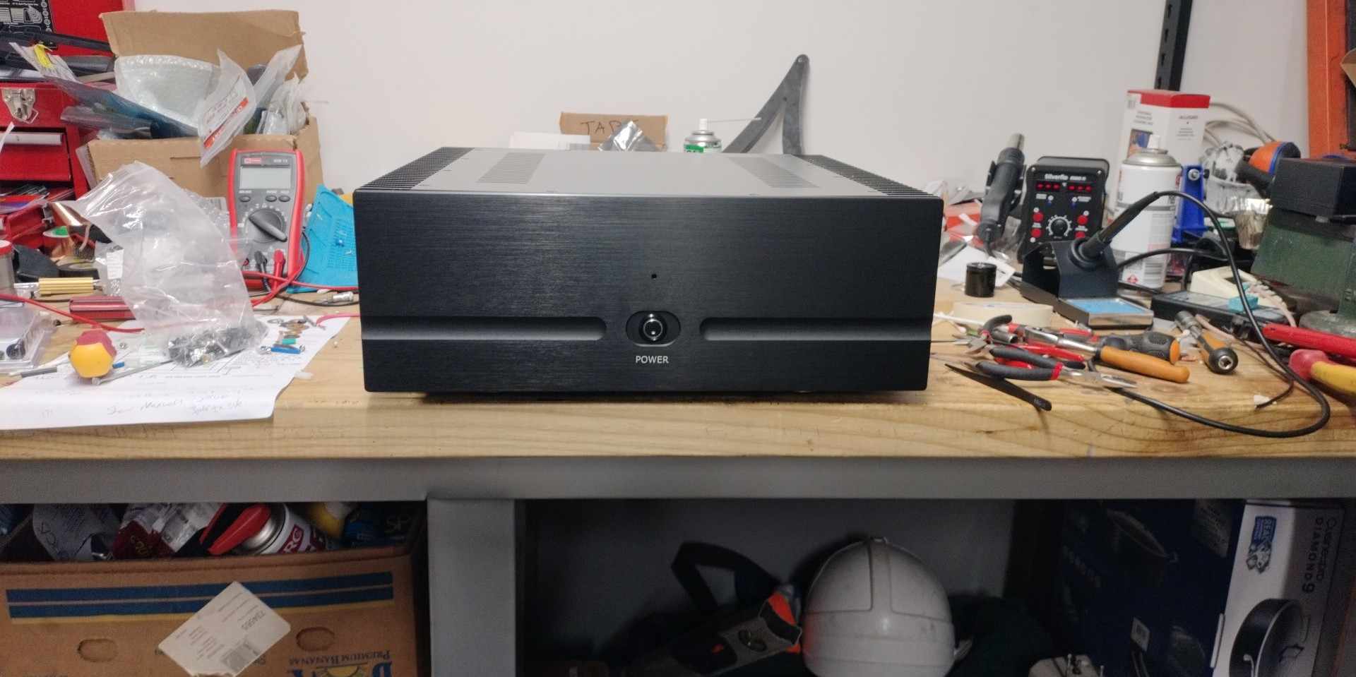

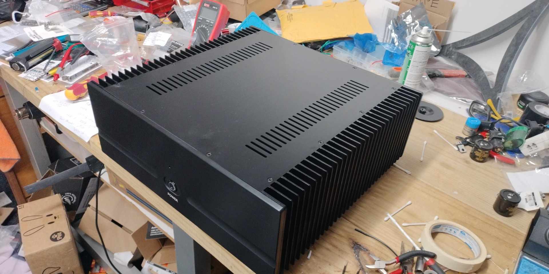

Just want to thank the community on here as new amp has been working well and sounding amazing espythanks to @ItsAllInMyHead @chermann. Have included a pic and vid. Super happy onto the next project.

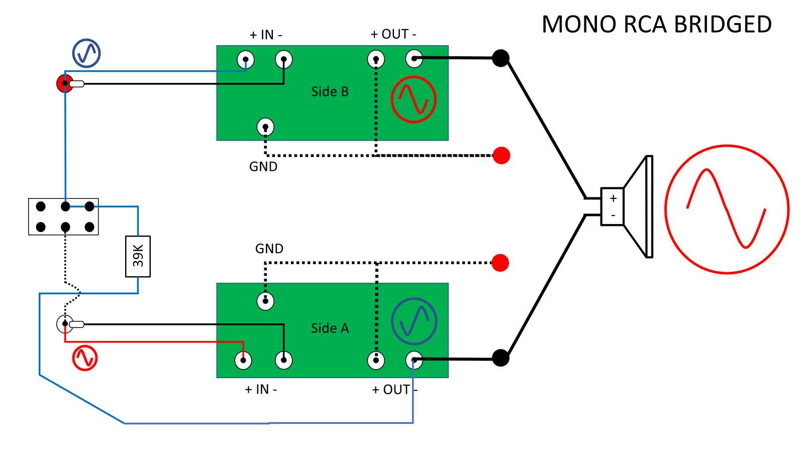

I have built 2 ACAs but without the switch shown in the pic above. Sorry for a dumb question but how would I wire them both for Mono bridged output?Looks fine to me. This is the diagram I made.
@Loudthud posted a suggested update to that resistor value with some sound reasoning. I did it to mine.
^ Not a dumb question at all. You'd wire them exactly as in that diagram. Just follow the "blue" line that runs from the output of Side A through the resistor and back to the input of Side B. You just won't have a switch and you can ignore the connections to the XLR etc. You don't even need two RCA jacks.
I know that's a pretty quick answer... and there must be something more that you need re: the "how", but I'm not sure what's unclear. Maybe sketch up what you're thinking or take a pic.

Beautiful chassis. Clean and elegant!

So, as of just a few short minutes ago, i am absolutely gob smacked with how amazing 2 aca's in parallel mono sounds!!
At least for my system, bridged mono sounded good but was not nearly as earth shattering as parallel..

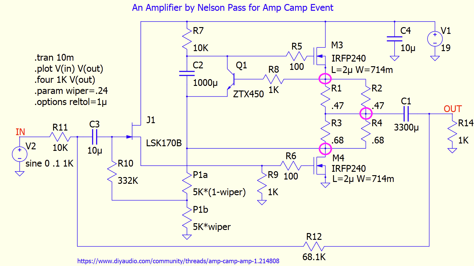

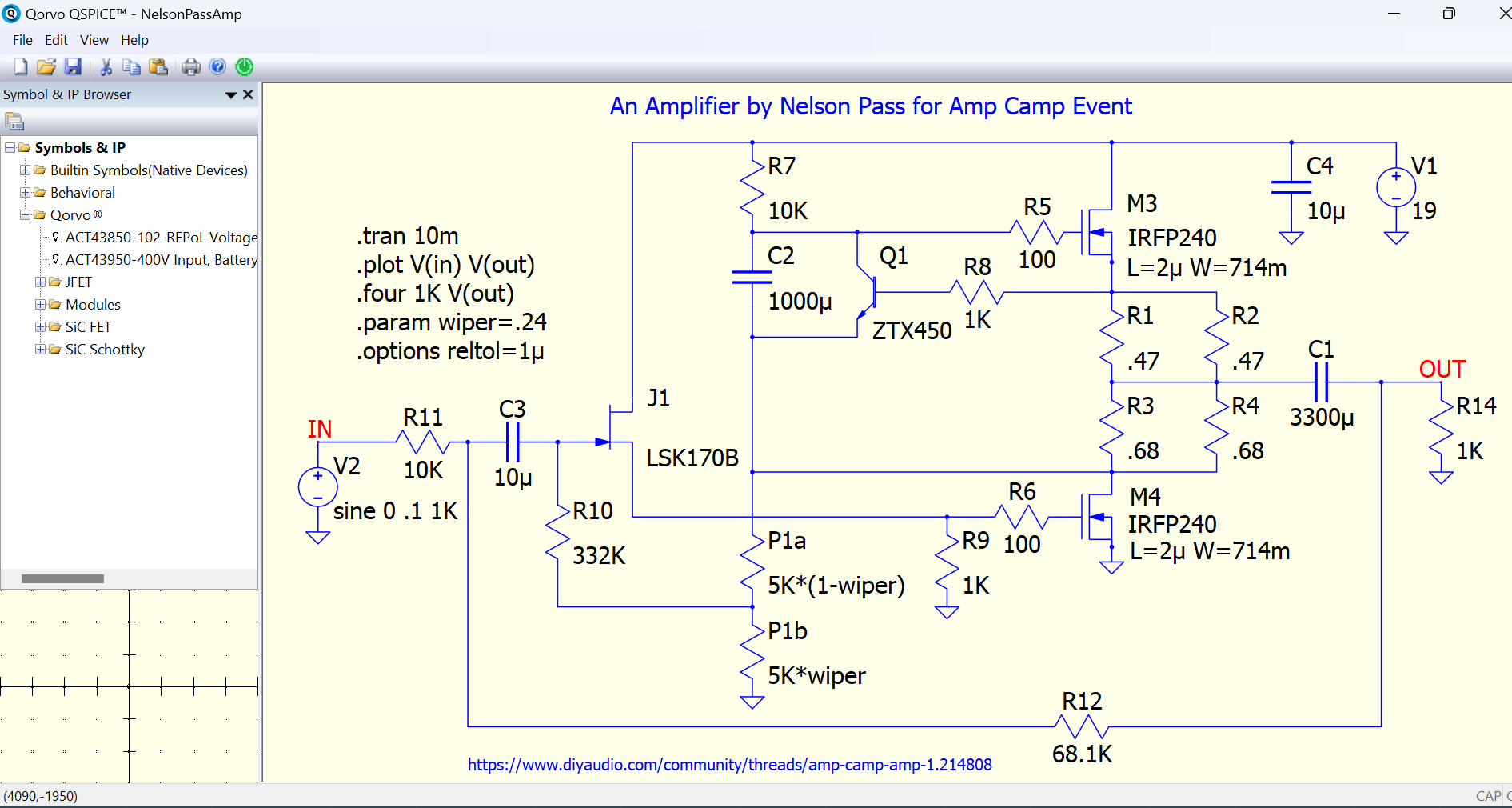

We at Linear Systems have something a bit unusual to share. For years, we’ve collaborated with our friends at DIYaudio to support their educational projects, including the Amp Camp Amp by the legendary designer Nelson Pass. We’ve now captured the Amp Camp Amp schematic (with Nelson’s blessing) into the fantastic new circuit simulation software developed for Qorvo by our old friend Mike Engelhardt, the author of LTspice. Mike has included the schematic capture in the QSPICE demo schematic library (File/Open Demo Schematic/Nelson Pass Amp). QSPICE is free, allowing you to modify the JFET bias and run simulations. Check it out here: https://lnkd.in/eq5EVv46
Thank you Tim! That's very thoughtful of you.
I would like to feebly request one little change: please consider eliminating "four way connection dots" from your circuit schematic. The dots (which indicate "We Are All Connected Together") are small and difficult to see on a high resolution monitor; worse, they're impossible to see after printing, especially when printed at home using an old printer whose ink is also old and whose paper is cheap.

Hi Mark, I'll try to do that, still very much learning the art of schematic capture. Best, Tim
Sorry for the super noob question, I’m just starting my diy journey. I too have the forte III’s. How would one wire a pair in parallel vs using them in bridged mode?
