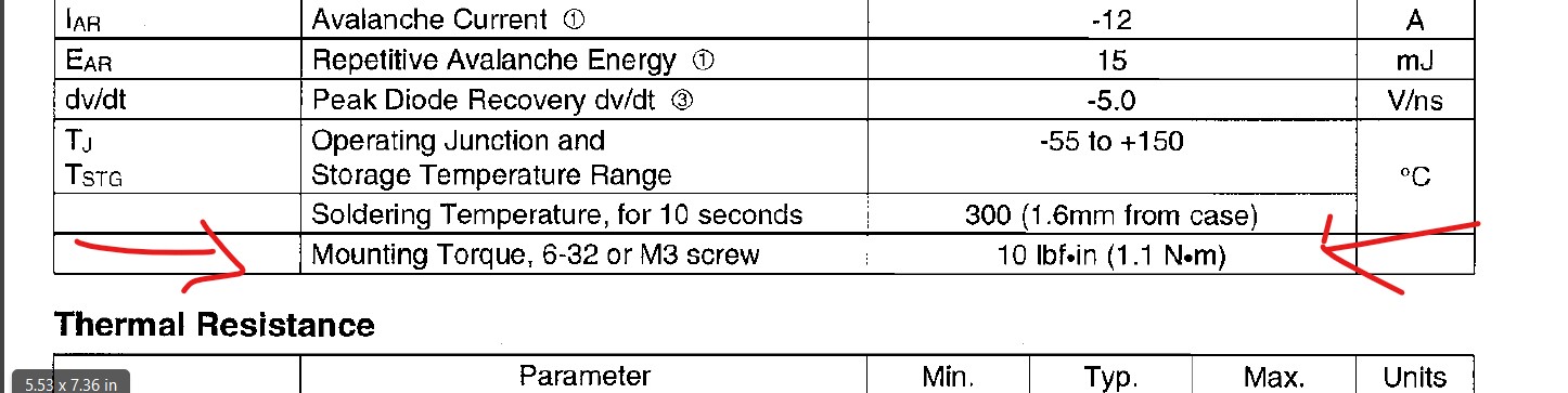

But, how would I translate this into „horsepower“ [emoji1320] ?
= how do I get a feeling of how much torque I am applying through the screwdriver/wrench, or even better, is there a method to kind of approximately measure it without expensive torque-wrench?
Something like (hypothetical): when tightening an M3 with a specific) wrench, 1.1 N/m are applied when the wrenches edge is 5mm into the pushing finger. Or, more objectively, whe screwing an M3 into a 5mm MDF, 1.1 N/m are needed to ‚overtighten the thread‘
If we had some approx measures like these to adjust the touch+feel…
Administrator
Joined 2007
1.1 N/m is 0.8 foot pounds so a good approximation is a 1pound or 454 gram weight suspended off the end of a 12 inch/30cm ruler. Its pretty close.
Hold the other end of the ruler and it lets you gauge what that level of torque feels like.
If you have a socket set with a 30cm handle then dangle the weight off the end and let that alone tighten the nut.
It's probably a lot less 'tight' than you think.

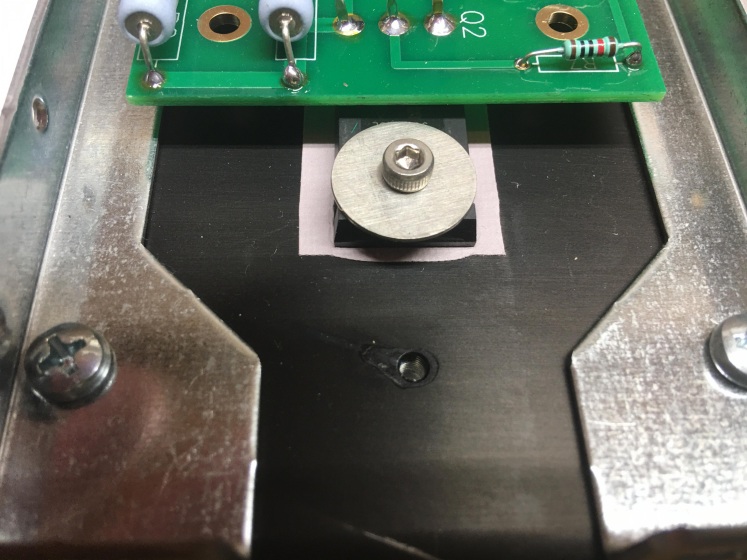

Torque figures are often given in data sheets and it can be surprisingly low.
Hi Mooly,
I have a torque screwdriver that was set for 10 in lbs when I installed the screw holding the transistor. The thing is, the torque figure in the transistor data sheet gives you the maximum before stressing the part. What we want to know is the maximum torque you can put on the Keratherm part before it deforms. I have looked at the Kerafol "Keratherm® Red" data sheet and it contains no information on this.
