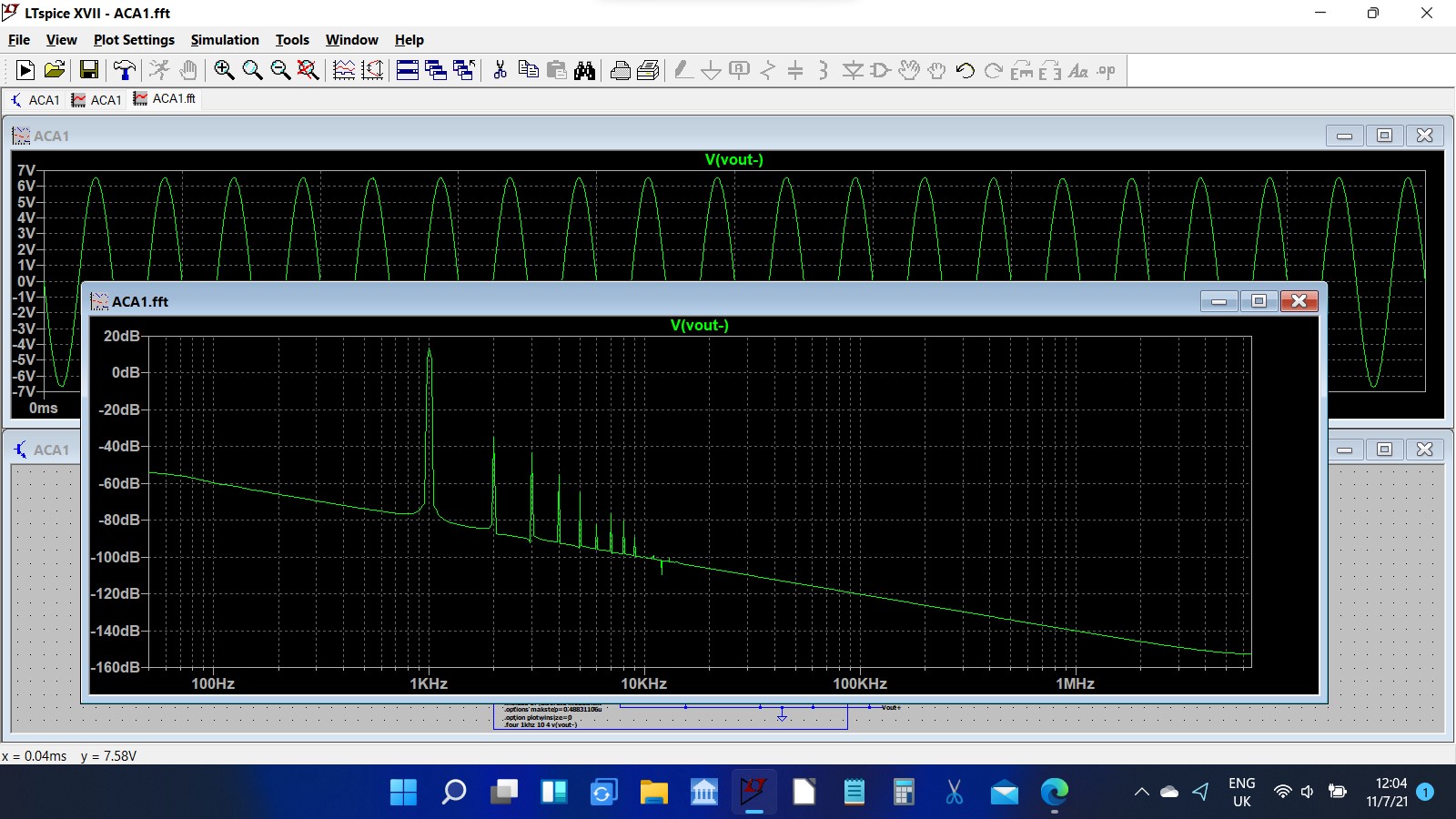

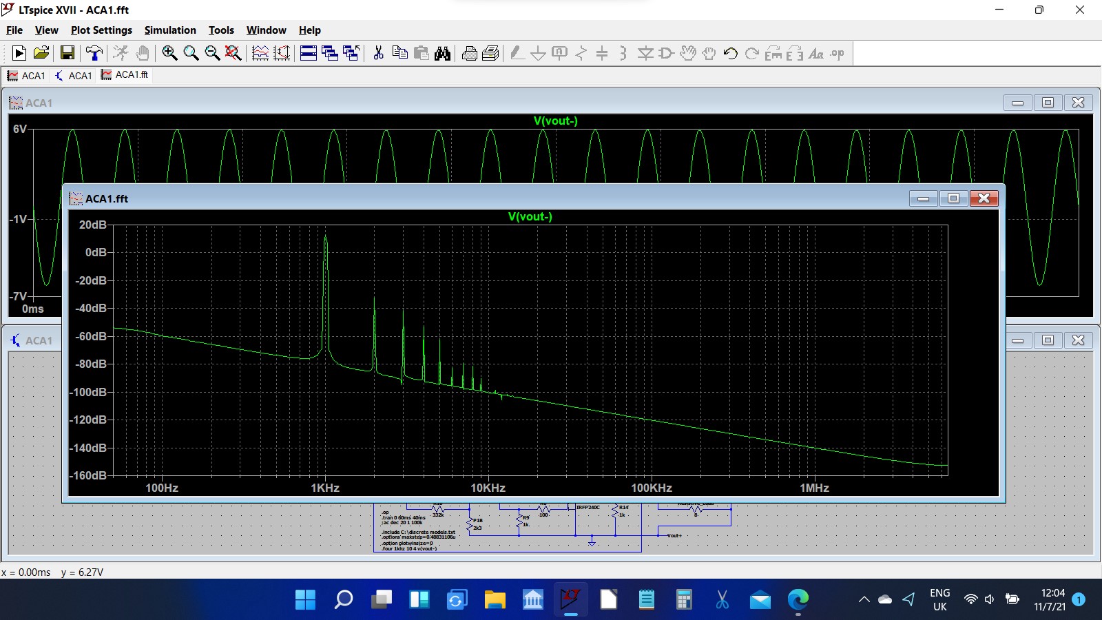

The voltage gain G is approximately given by R12/R11 so we have 39.2/10 which is 3.9.
In other words 1 volt in gives 3.9 volts out or 11.8db.
In practice it is a bit lower because of the low loop gain of the ACA and the addition of a load. It is about 10db for an 8 ohm load.
A 56k would give about 13db gain.
Going to 82k would double the voltage gain and the distortion is little changed really.
Try it 🙂
This shows 2v input with 39k2 and 1v input with 82k.
