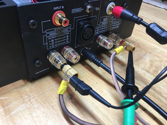

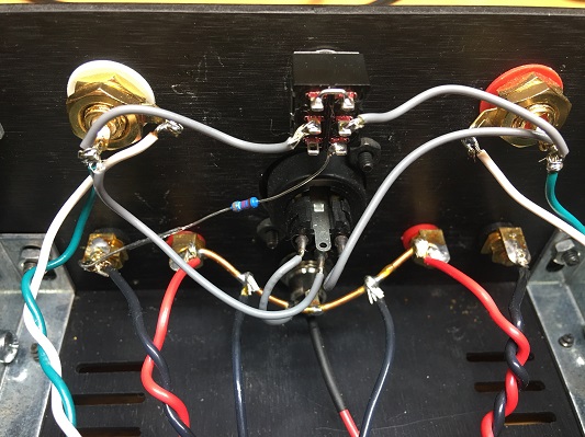

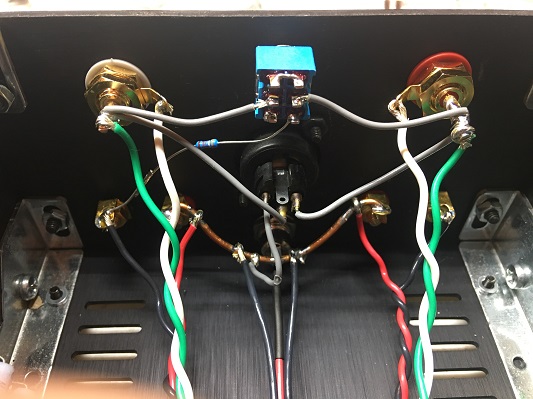

I built a second ACA (version 1.8) to go along with my ACA 1.6 (now modified to version 1.8). Everything seems to work fine except in measuring Mono RCA Bridged and Mono RCA Parallel I'm only getting slightly better performance than measuring one stereo channel. Is there something fundamentally wrong with the way I have the back panel wired or the way I'm measuring?
At a glance the back panel looks fine. Are you making the appropriate jumper connections for the speaker leads? When looking at the mono block RCA input, are you changing the speaker and measurement leads to the two outer posts (one on each channel) ? If not, you'd only be measuring one channel. So measure between the far outer black posts. There is no connection to the Red posts in that configuration.

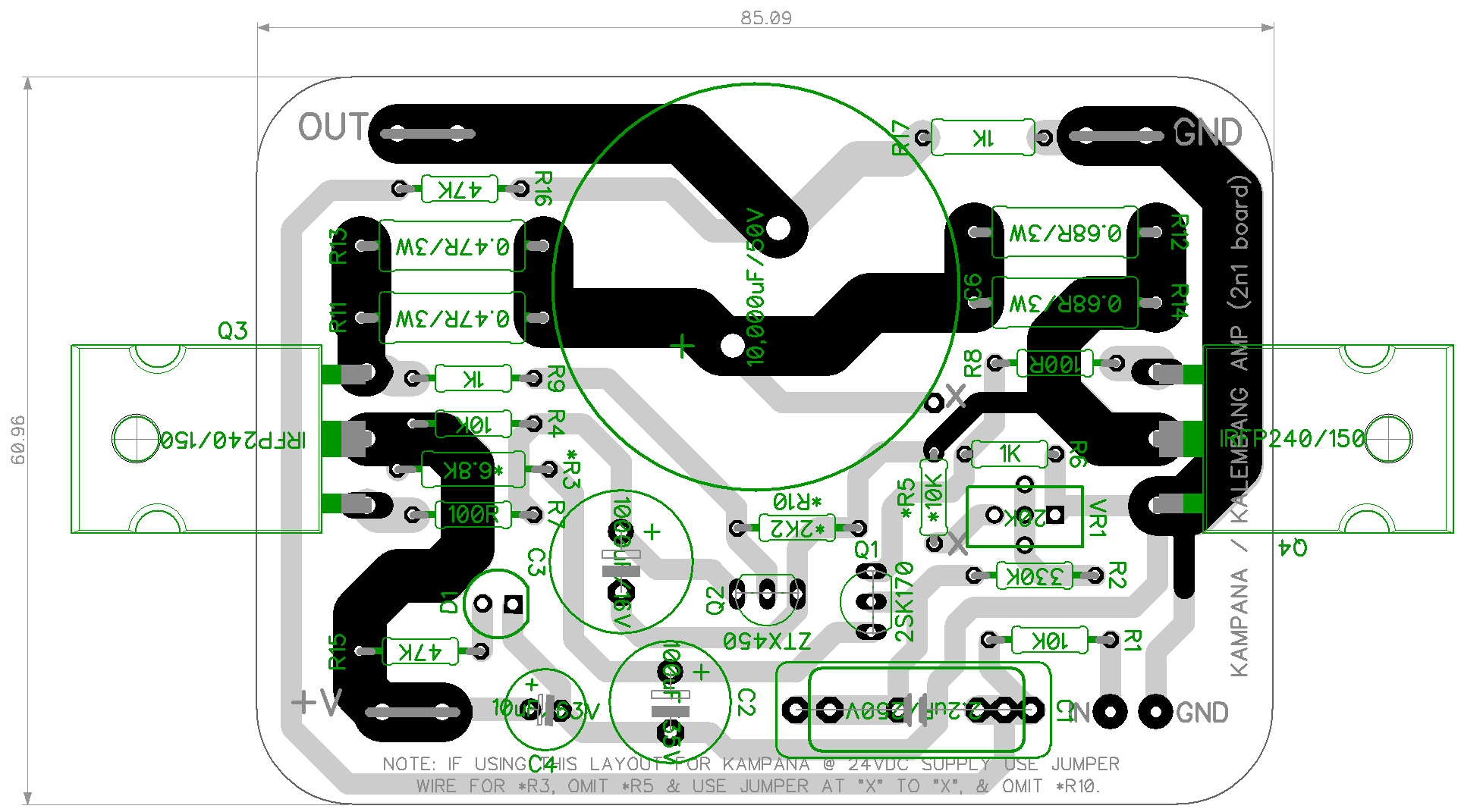

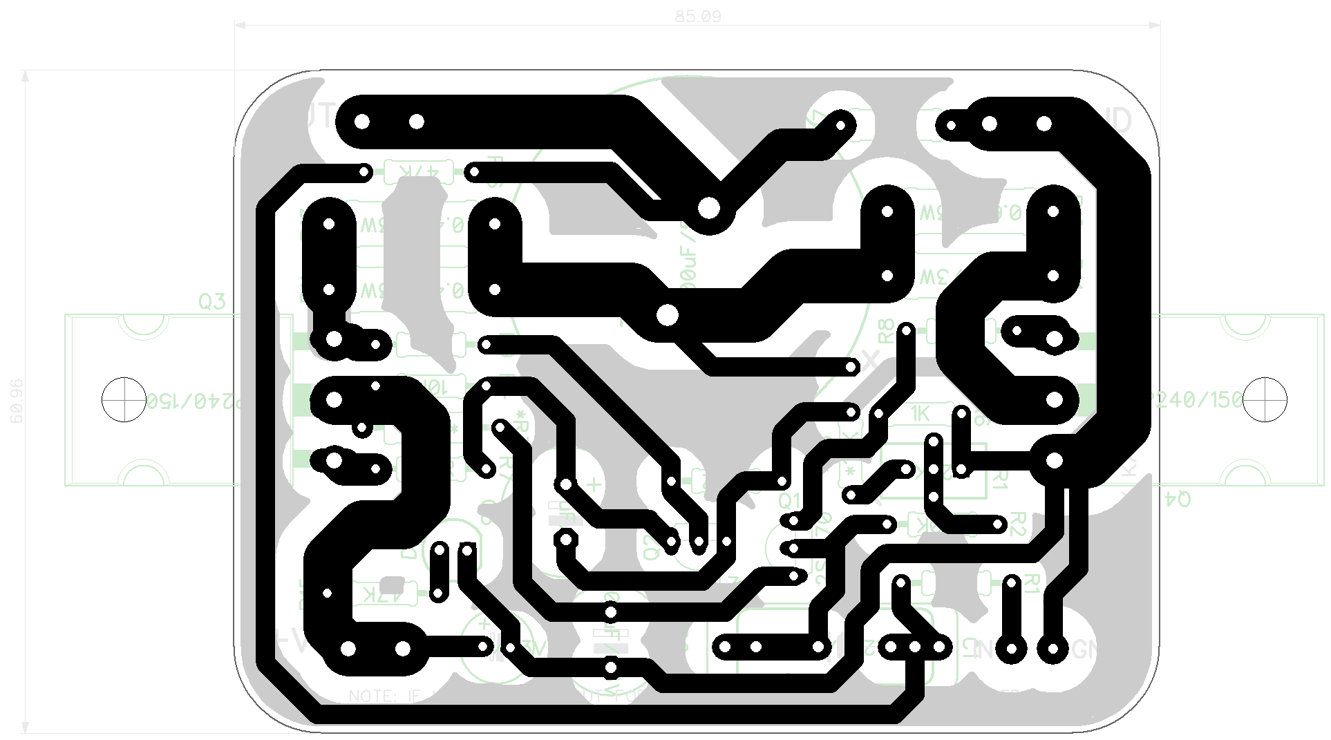

new 48vdc ACA, aka Kampana, new board layout......

Right! I've got an 8 ohm dummy load across speaker terminals (A-,B-). Scope probe attached at output A- and probe ground attached to B-. Wave form clips at about 2.5V input and about 8V output. That equates to about 8 watts.
Shouldn't I be able to push the output voltage to something like 11V?
Am I missing something here?
Check this out. I think you are missing a jumper that joins the two - outputs together.

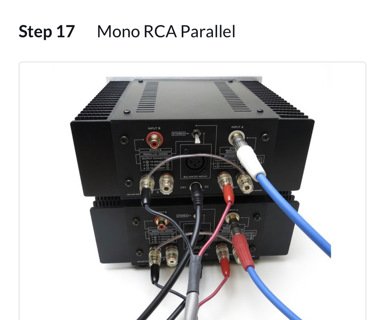

Sorry for the multiple replies - the paralell mono block mode ties the two negative posts together and you use one of those two and a positive post.
If I understand it all correctly: One way allows for more current for lower impedance loads. One allows for more voltage for higher impedance loads. My speakers which are rated at 4 ohms sound really nice when I use the parallel mono block mode in the picture.
So I guess to answer your initial question. You might measure the current as well as the voltage rather than just the voltage. Try it both ways and see which one is more sonically pleasing in your situation. There is a big difference in fidelity between the parallel and bridged for my speakers. Might be opposite in your case.
https://cdn.shopify.com/s/files/1/1006/5046/files/ACA_Monoblock_Operation_RevA.pdf
I’ve seen that chart before as well but I believe that’s for version 1.6 only. My assumption is that the new switch and wiring of version 1.8 eliminate the need for this Y connector. I’ll go on to speculate that in version 1.8 (having the top two pins of the switch connected with a jumper) joins the right and left inputs together when the switch is in the up position.
While it does yes eliminate the need for a Y connector - You will still need to connect the two - posts together to sum the outputs of the two amplifiers with wire for the parallel mono mode. The + posts are done internally.
