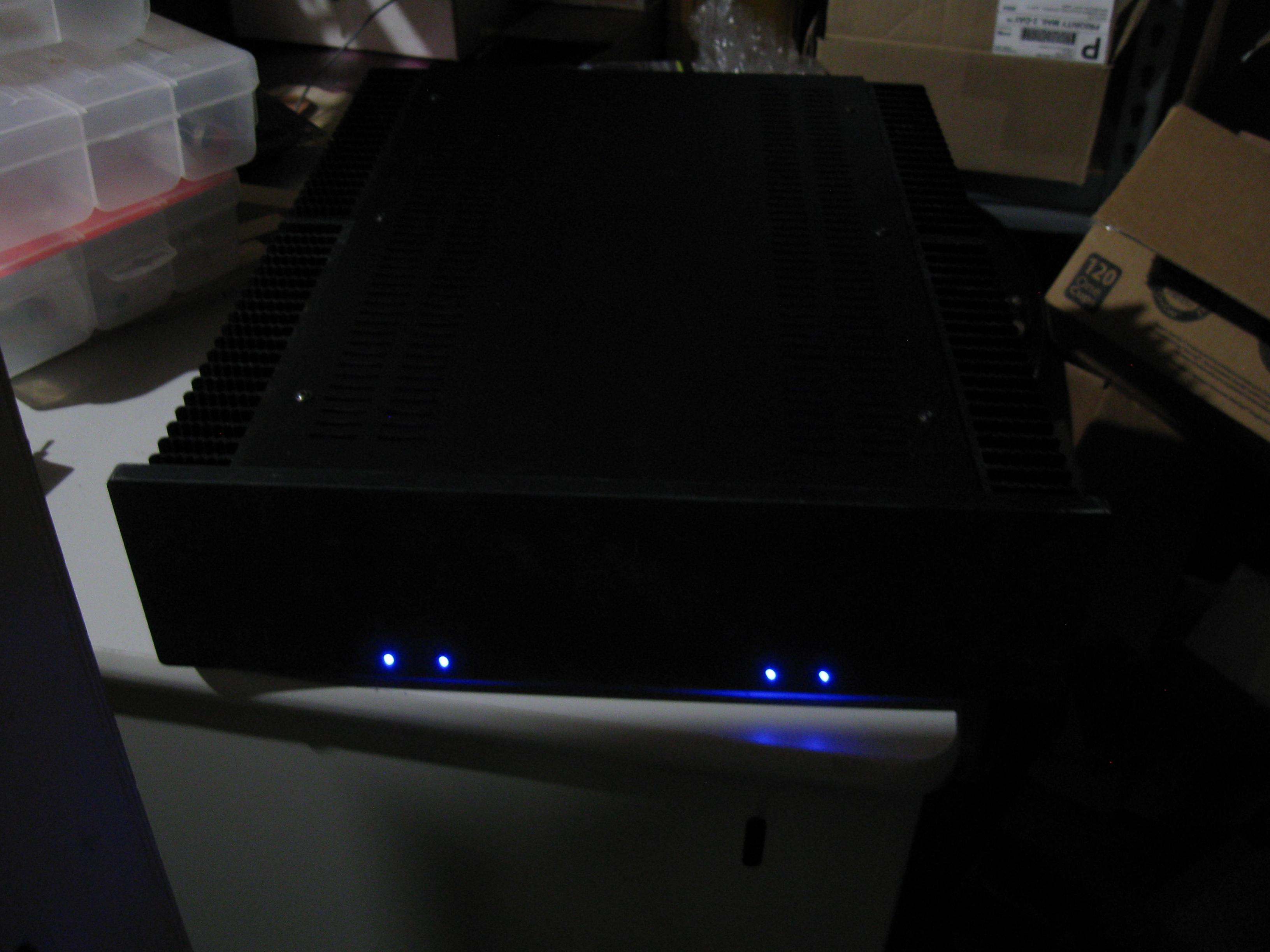

But you guys rock more \m/. Thank you for all your help and patience. Yes Mooly we got there in the end 🙂
I can only imagine this is like child birth because once I switched it on, all the pain, sweat, tears and yes, even some blood … was instantly forgotten. Mono block mode sounds incredible!
the simplicity and ease of build, a single gain/power stage made this ACA a clear winner, the closest a solid state amp can come close to the sound of a tube amp...
...the closest a solid state amp can come close to the sound of a tube amp...

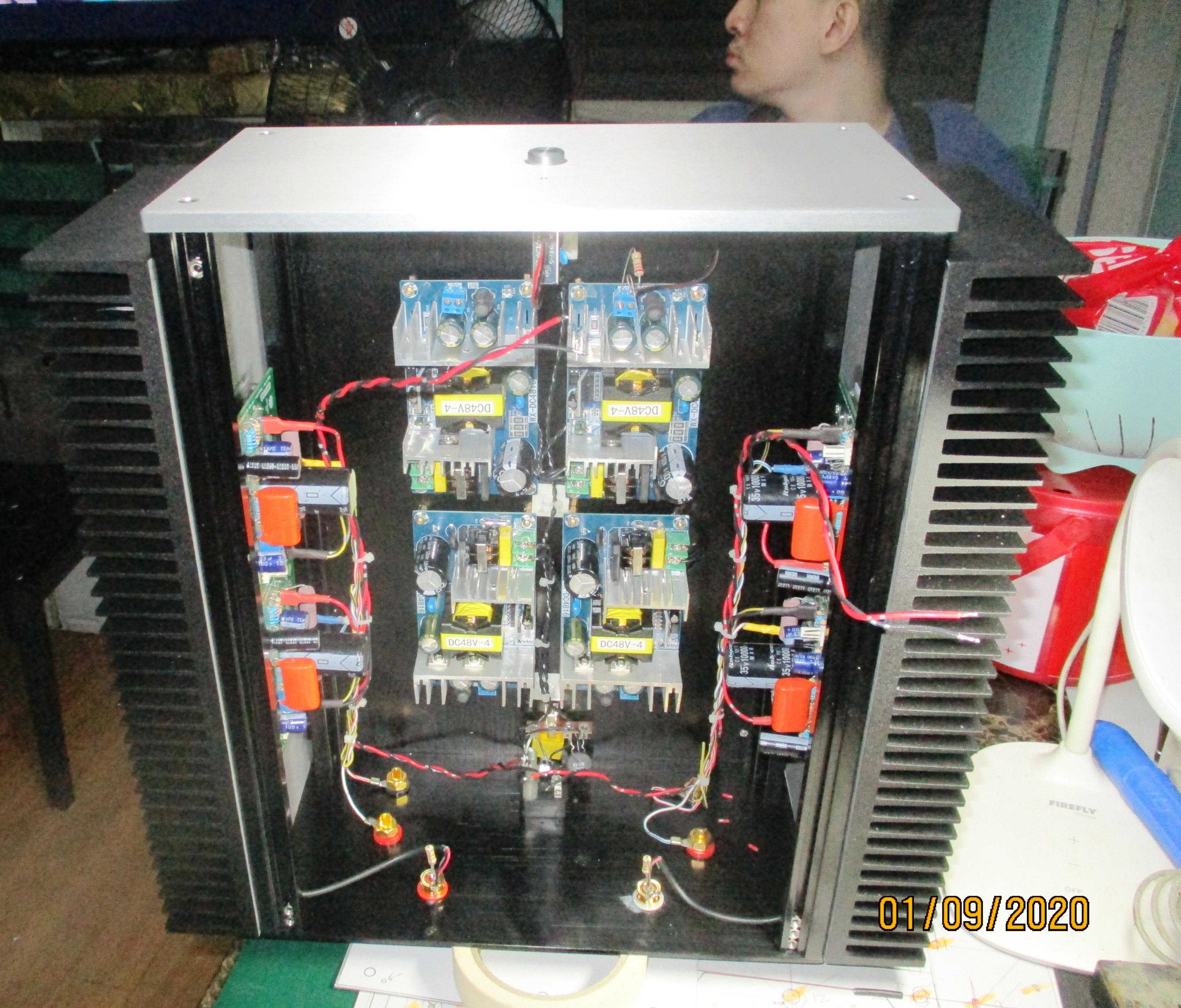

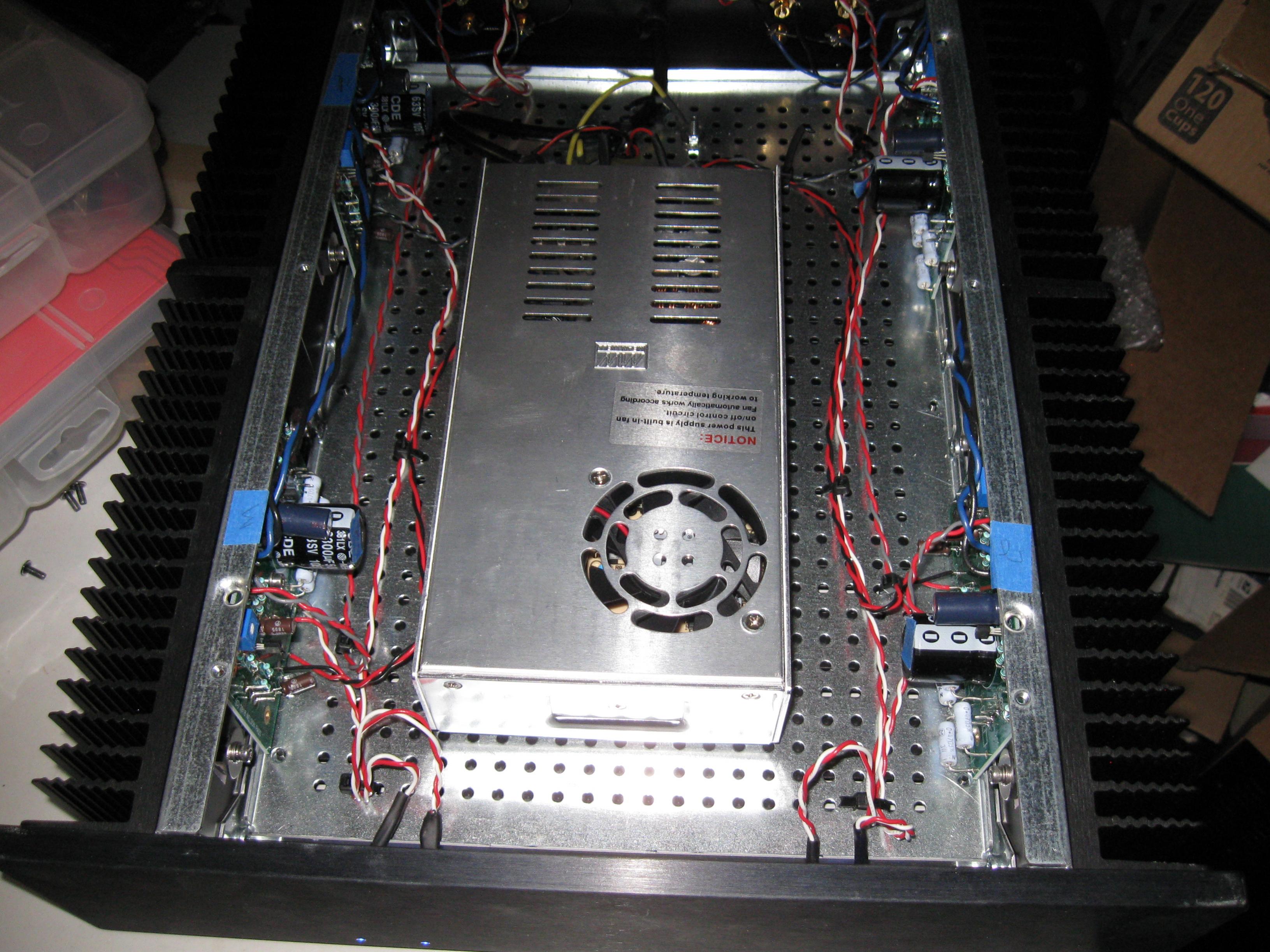

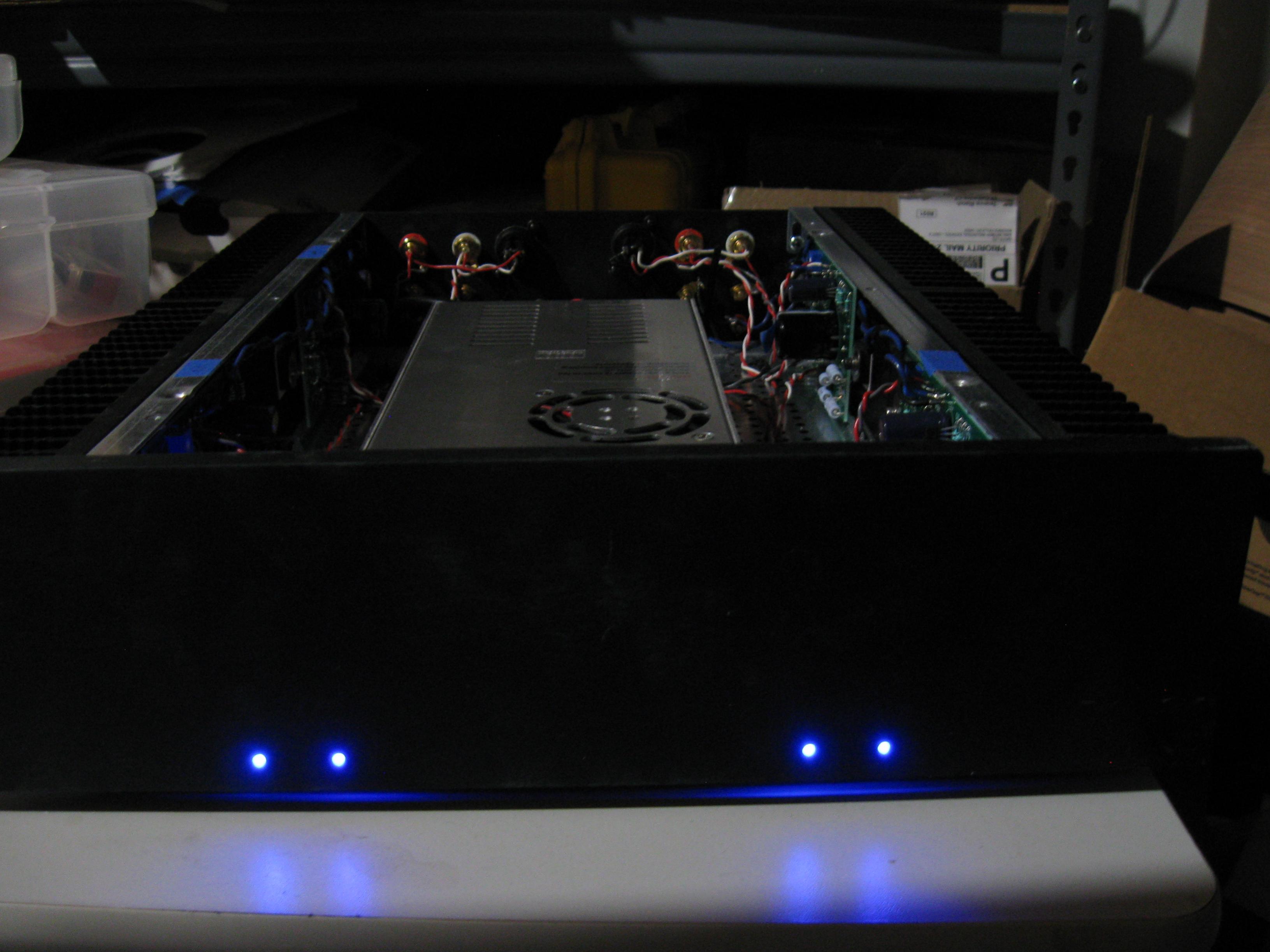

Well yes and no. I build a four channel ACA in a bigger chassis. Used a Mini Disspante 330 X 400 2U chassis as it has four heat sinks the same size the ACA chassis. It is powered by a mean well 24V 14 amp SMPS. I will try to load an image later.

Has anyone built two ACA's in one chassis?
me, i built 4 channels in one chassis....48vdc ACA, we call Kampana....
I’d love to see a future kit that was two ACA modules in one full size 17/19” chassis with integrated power supplies. Would expect the kit to retail for 2-3x of a single ACA kit.

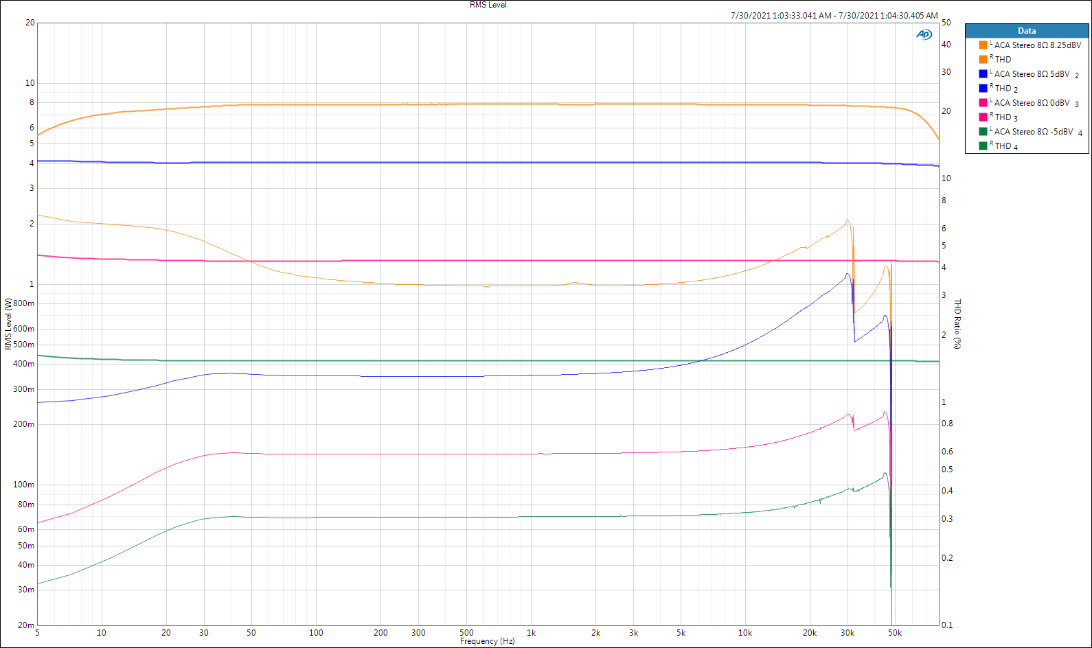

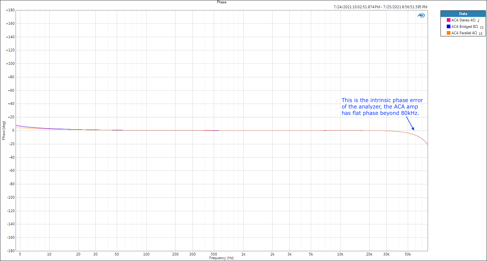

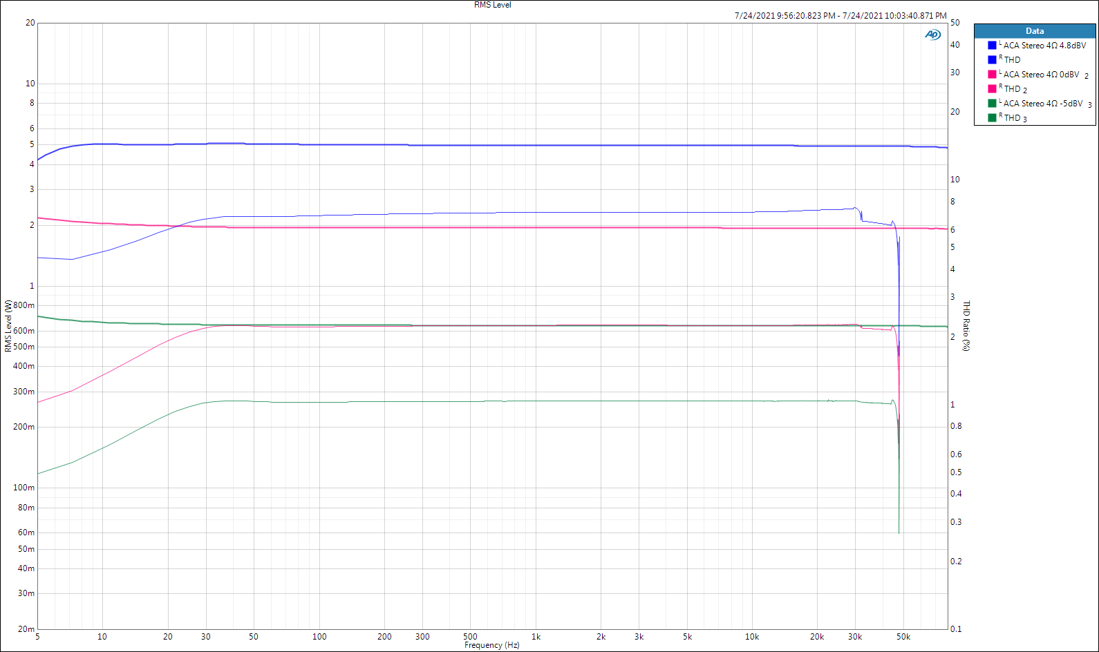

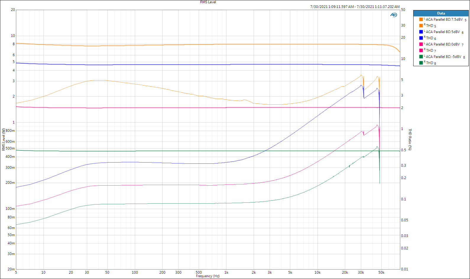

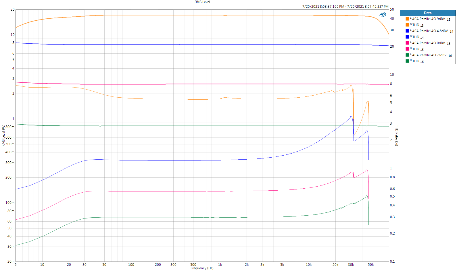

The following measurements of my ACA amps are the kind of thing most folks start with, but I'm concluding with: transfer function and THD.
I chose the max wattage levels to approximate the specs seen in the "ACA V1.6 Operation modes" doc and then made lower level measurements at 5dB increments down to -5dBV drive voltage. See the plot legends for details and pay attention to the THD scales, I used a couple of different ranges to help with clarity.
As I've mentioned in a couple of prior posts in this thread, the distortion these amps produce is the most benign I've ever heard from an audio device, including tube designs. Thus I think the max level specs were probably done by ear as much as meter.

Phase is effectively perfect
Stereo into 8Ω
Stereo into 4Ω
Bridged into 8Ω
Parallel into 8Ω
Parallel into 4Ω
