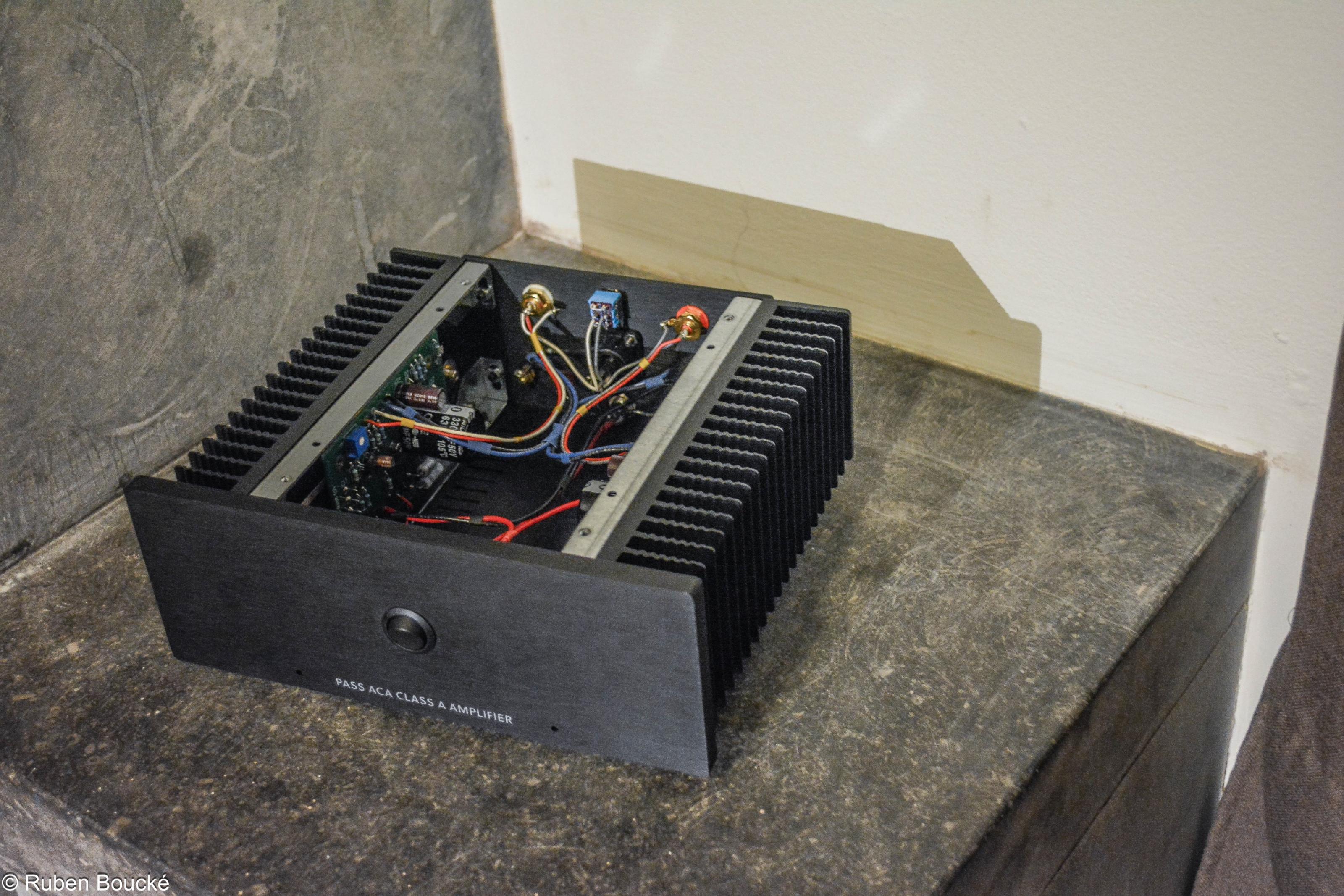

We'll see! It got quite late so after the unboxing, running over the BOM and parts and some rambling about personal techniques and someone from around here joining in too (!) I ended up getting the resistors on the first board mounted and then sent people over to a friend with a raid.
It's nice to know my knowledge is good enough that while trying to check the board for any misplaced components I can kind of spot stuff being wrong just by knowing what can and can't be right. I never thought I'd rack up this much intuitive electronics knowledge but I still did!

Well, i'm very happy with it, running it in stereo now with my CHN110 MLTL's. Volume is limited of course (but loud enough for my room on normal listening levels). The sound is close to the Prima Luna tube amp i have, but less soft, more edgy transistor sound, but with the harmonics i love. I heared quiet a few class A amps (Sugden A21, Pass Labs XA and XS, Musical Fidelity A1, ...) before that cost way to much money for me, but this one is not worse I have the impression (just lower power than some). For it's price is a steal, and i'm very happy with how my friend HumbleDeer assembled it with a precision and eye for detail i could not do.
A second one is certainly what i will do in the (near) future. But first i got quiet a few other projects that i need to finish now woodprices are dropping again after the covid madness...

Volume is limited? I sure damn enjoyed some roots on them.Well, i'm very happy with it, running it in stereo now with my CHN110 MLTL's. Volume is limited of course.
You know where to ring the bell. Always happy to have some fun making amp porn. We now have some extra plywood, too, to make some nice designs of things and bobs. Not to forget that I have these sheets of 'veneer' (it's actually the packing material they use to ship plywood in) to use tactfully.A second one is certainly what i will do in the (near) future. But first i got quiet a few other projects that i need to finish now woodprices are dropping again after the covid madness...
Well, you won't do house parties with this amp and a 89dB sensitive speakers, but for general listening without an active preamp (like i do now with my passive preamp) it's surely loud enough. But 2 in mono will give more headroom and options to use this amp...
There are mods you can do to increase the gain just a bit, if you wish. Or we continue with those preamps. 🙂
Let's do that preamp first, i like it like it is and when i have the second the power doubles which will be enough for me...
The volume is mostly limited by the lackluster output from your DAC; you need to drive it to nearly the full 2v RMS and I don't think it does that.
