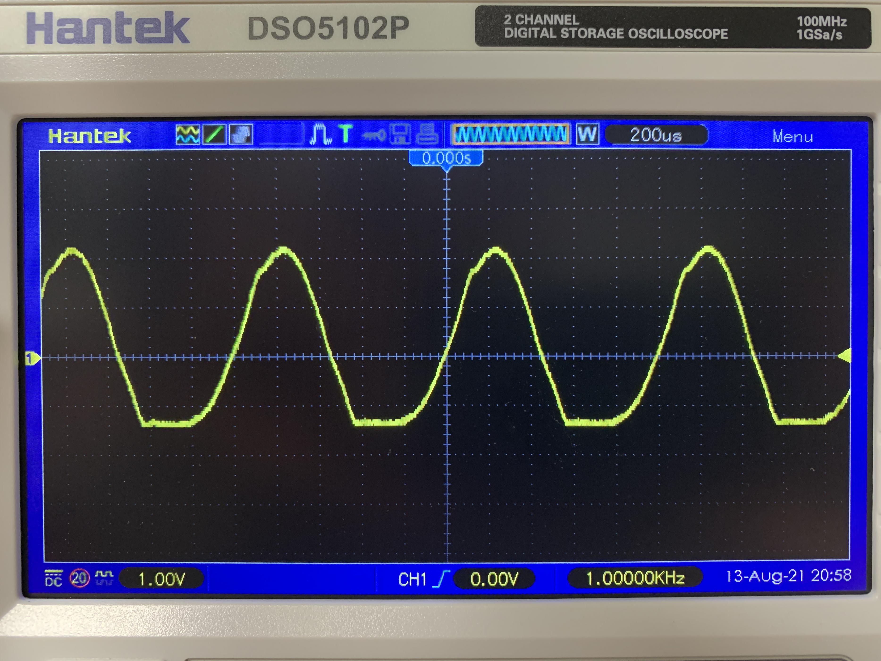

Hello... apologies if this has been addressed before, but I'm troubleshooting a 1.8 build and I'm at my wits end. This is the second of 2 monoblocks... first has no issues, and they were built exactly the same way.
This one has significant distortion, as evidenced by the attached image which should be a perfect 1kHz sine wave... any thoughts? Thanks in advance!

Try turning up the bias a solid 200mV regardless of what the meter says and see if this disappears. Diagnosis trick.
Edit: You do need to put a load on the output to set the bias reliably because without that, the natural environme ntal impact on the impedance is going to throw you off. Loading it down with a speaker gives it a "much stronger impedance to load"; it eliminates the fact that it gets more sensitive to changes in the bias voltage measurement when not loaded.

origin of your JFets?
SE or bridge?
done regular checkout - soldering, values and part positioning?

Thanks... the bias (originally set with no load) was ~12.1V. When I rechecked with 8ohm dummy load, it measured 12.34V. I dialed it back in to 12V... no change in distortion. I then turned it up .2V per your first suggestion; also no change.

The 12v setting is really the 'midpoint' adjustment and tbh even several volts away from the optimum will make little subjective difference to the point audible distortion sets in.
Bias (as in standing or quiescent current) is a critical value for the ACA but it is also non adjustable.
If the midpoint is OK and the bias current OK which is checked by measuring the volt drop across R1 and R3 and also making sure these four low value resistors (R1 to R4) are correct in value then it should work.
Are you sure you haven't a construction error shorting the output to ground????
