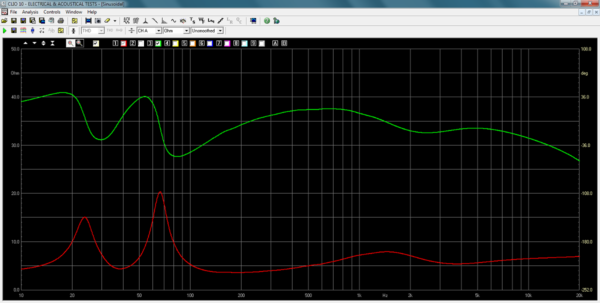

Bridged vs parallel vs speakers impedance-phase curves
Hi all, i am trying to learn the best choice for these speakers. Initially thought the nomex, with double woofer and nominal 4ohm impedance, would have preferred the paralleled aca, but.... Look please at the bass control area 30-90hz...it shows much higher impedance than 4ohms. To cut a long story short, will i leave my ear decide, or if i use aca bridged for more power it will bring the amp in difficult zone driving those? Thanxs
your photo shows that your speakers are either ported, or TL, or Voigt.
those two peaks show that.
your speaker is tuned to around 40 Hz.
ignore the two peaks, the minimum impedance is the valley after the second peak, and it is within norm.
the rest of the impedance looks very smooth and would not be a problem for ACA in parallel.

They are nomex 164mkii and their designer indicated that he drove them on his amp 8 ohm tap, hence i thought i could try the aca bridged or will it be better too hard for aca's?

OK, Troels Nomex, vented 2.5 way.
He says nom. impedance 4 ohm, min. 3.2.
ACA in parallel mode will drive them fine, in bridged mode will have difficulty.
You either use ACA parallel or look for a different Pass amp, like M2, F4, F5 and some of the Alephs.
Another way is to convert your speakers to 3way, but that might not be that easy.
The best option IMHO is parallel ACA which means building one more ACA amp, and running them in parallel mode as mono blocks.
I can assure you the sound will be magnificent.
