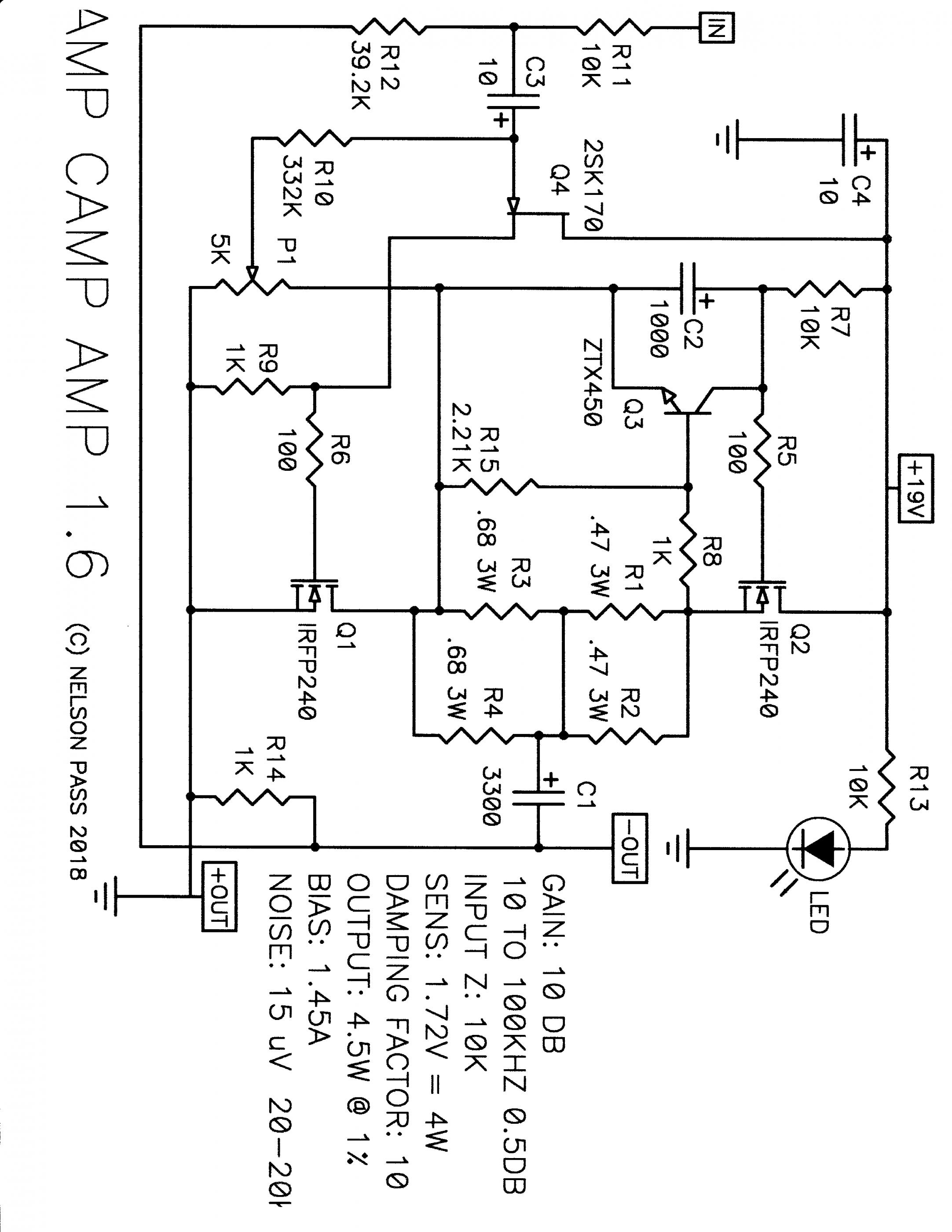

I would be grateful for confirmation on the following schematics " that I do not require the resistor modification" on the ACA clone schematic. I have attached the ACA clone schematic and the ACA V1.6 schematic. My brain says that they are equivalent in the area of R116 vs R15. See attached
R116 on the clone is R15 on the Official build. (2.2KΩ)

6L6: I just needed confirmation that R116 on the ACA clone and R15 on the ACA V1.6 accomplished the same function, and I did not need to retrofit the R15 modification on the ACA clone board. I believe I am good to go with the clone boards.

Hi MM,
I´ve done the modification following customer (I don´t recall who, ZM?) recommendation.
So R116 is R15.
JP
So R116 is R15.
