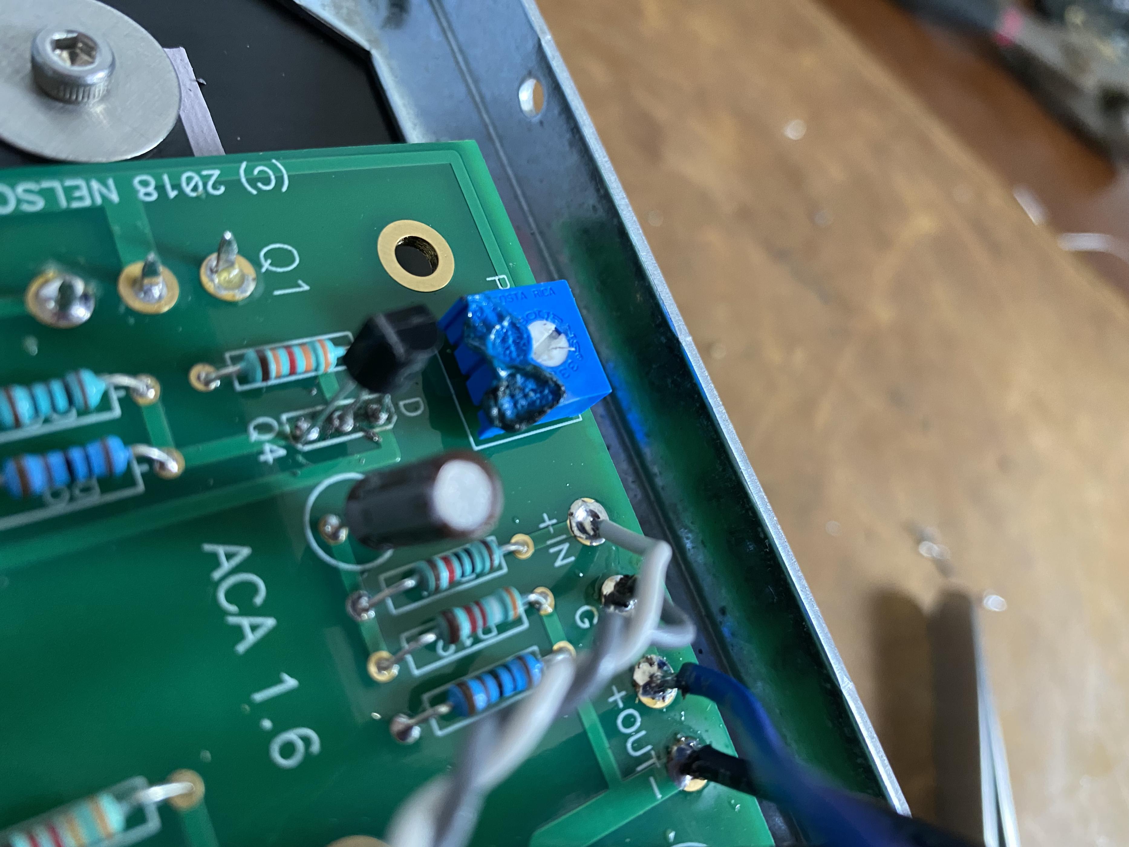

It very much looks as if you have Q3 and Q4 mixed up.
Well spotted 🙂
Yes great eye! I do have those mixed up. I do not have a solder sucker so can't correct this and see if it fixes the issue unless someone knows how to make a solder sucker.

So we await... I don't want to put a dampener on anything but I can't see how those can pull R7 down. There is no low enough impedance path to do that.
I do have another theory but that will have to wait until its all built up correctly and which is actually related to how you are measuring the voltages.
One step at a time 🙂

So I got the first three switched before I bent the middle leg of one of the JFETs. So close but will let you know after I get DIY to send me more parts.

Do you think I cooked the bias controller (sorry for the lack of the correct name)

The trimpot… it sure took a hit!
Not sure if this works on an installed pot, but try measuring from the backside (one point being the center, the other is either ground or signal, adding the values returns the pot‘s total resistance)—but resistors soldered in a circuit are often difficult/impossible to measure…

No it broke at the junction metal to plastic of whatever the housing is. I know I have three back in there.
Does this need to be replaced?
We've all done that or similar at some time 🙂 I used to melt transistors and caps doing that 😱
Electrically it is probably fine. The damage looks more cosmetic than anything.
This could be a good opportunity to try and get to the bottom of the weird voltage readings on R7. It would also let you test the preset in circuit.
With Q3 and Q4 removed you remove the ability of Q1 to turn on, although it would briefly conduct as the 1000uF cap C2 charges.
So with Q3 and Q4 removed and by adding one link to short out the outer two pins of Q1 you make the amp safe to switch on.
