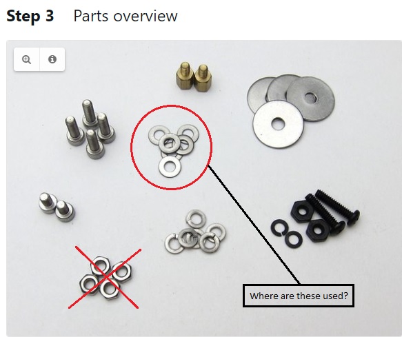

I just received my kit and am checking inventory and I can't see where these 6 flat washers are used (See Attached). The inventory didn't match exactly with the pictures in the instructions, but from the comments on the steps, it seems to be okay, but no mention of these 6 flat washers.
They go on the 3M bolts holding the large FETs down.
So; 3M bolt - small flat washer - spring washer - penny washer - transistor / FET.
Really does not matter if you leave them out...
