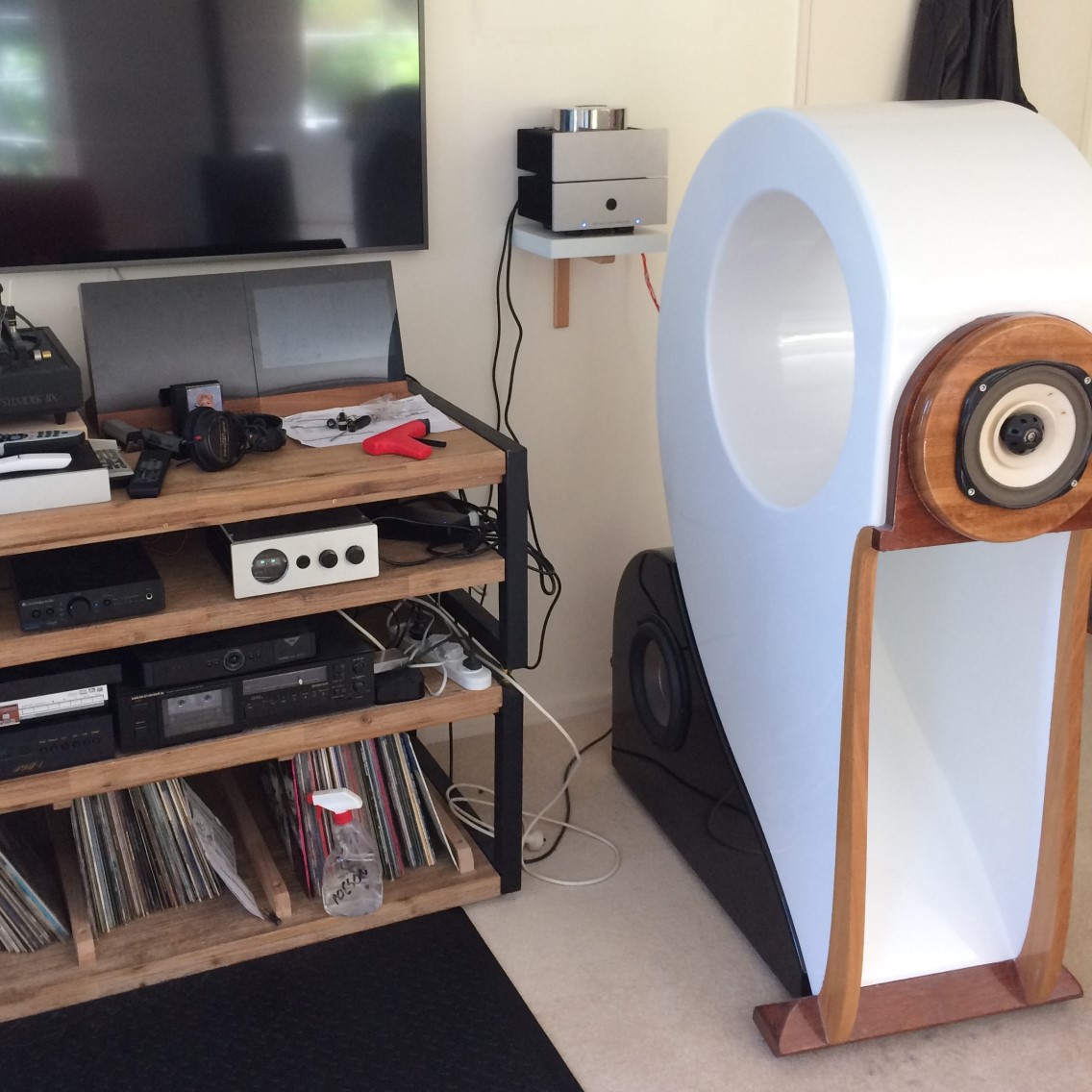

Well Naim Uniti Atom Pre-amp/streamer/headphone amp ordered and uniti core CD ripper. XLR from the Naim into the ACA should be good, built in streamer and DAC should be better than Cambridge DAC Magic and Apple TV box i'm having to use at the moment. Keeping fingers crossed that the built in Pre-amp comes close to the Nutube which it would replace in the system. Big gamble but with Tidal subscription and pretty tiny record/cd/tape collection it makes sense.
I went through the steps again and found use for 2 washers with the 2 smaller hex head bolts/screws for the center of the PCBs... are the remaining 4 flat washers used anywhere?
Is it important to have those screws and washers on the PCB? It holds well with the end screws and the solder.
jh
The amp inside the Atom is awesome and a diff sound than the ACA. If you just want to run the ACA I am using bluesound node 2i and Denefrips Aeries 2 dac into the Freya pre-amp.
Atom HE edition it different it has multiple headphone sockets and a pair of XLR output sockets. It's a dedicated Headphone Amp that can be used as a Pre-Amp. It runs class A as a Pre-Amp. The Pre-Amp circuitry I supposed to be a step up from the standard Atom set up too. It's said to be just slightly on the warm side of being neutral.
My Speakers are Carfae Horn Replicas good for 106db/per watt and with seperate 100watt plate amps built in to drive subwoofers. Crossover set on the plate amp. The back loaded horn Creates a mechanical baffle step so there's nothing between the driver and the amps. So the little ACA's don't see much load at all. Bass with Korg Nutube as pre-amp is very sharp and defined with huge high wide sound stage with lots of depth.
Using the ACA in balanced mode should kill any distortion according to the operating modes information. So the big question is if The Atom HE driving the ACA in balanced mode will sound as good as Nutube driving in unbalanced.
Amp has to go from Austalian importer and distributor to NZ and through Auckland which is under total lockdown. Fengers crossed for a deliver that's not too delayed.
