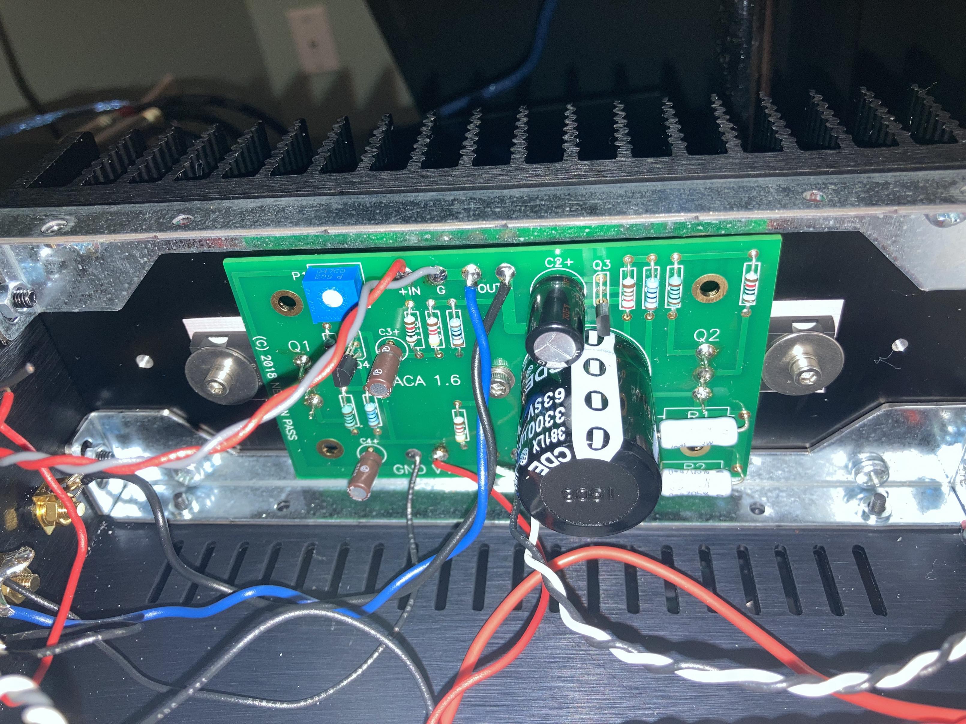

So I've got myself into a bit of a pickle after building this amplifier (v1.8 stereo). The left channel was at a much lower (10-12dB) output than the right channel, even though both were at right around 12.01-12.02V bias and no distortion was detected. Checked/reflowed all solder joints, made sure correct values were in their correct places (both boards identical in band markers for resistors). When completely disconnected from power (this bit has me confused) and both RCAs and speaker leads connected, only the weaker left channel produces an audible hum through a set of fairly large horns (ground loop from inputs all the way through to the outputs?) I even went as far as to completely disconnect the bridge/parallel switch and run straight left/right input into the boards and remove the boards from the heatsinks.
Another oddity, this hum appears when both or *either* RCA input is connected.
I'm honestly not sure where to begin. Attempted using multiple sources to similar effect.

You say you hear a hum with no power connected? Is that really what you meant? What are you driving the amp with?
With no speakers connected. Run a tone into both sides of the amp and measure the AC voltage at each speaker terminal.
Pictures of both boards, the back panel both sides might help the ace trouble finders on this site track your issue.
Last question from me is: - do the horns have an amp built into them? Mostly, hums come from ungrounded or electrically unbalanced in some way inputs. Since you indicate this happens with the amp when there is no power. It suggests something upstream from the ACA amp, is feeding the horn.

Yes, both measure 7.2 ohms DCR on a meter, nominal 8 ohm impedance. Both horns are passive B&C DE75PTN compression drivers mounted in ME60 horns.
The power switch is off and the 24V supply is completely disconnected.
I understand that the hum may be from the source (a DSP), but it makes very little sense that the hum would be audible if connecting *either* the right or left RCA and only having the hum present in the left channel in both cases.
Using a calibrated microphone equidistant to both horns and a sine wave generator (my DMM is finicky with AC voltage measurements, sometimes I wish I never sold my Leader scope), measured response is around 11-12dB down in the left channel at 1kHz. This deviation is reduced as frequency increases to around 3-4dB down at 5kHz. This behavior is not seen using another amplifier as a reference (6SN7/6L6GC tube).
Attached are some photos, forgive the slightly burnt wire ends (top-of-the-board soldering is not my strong suit). Switch in the back was removed from the input circuit to troubleshoot.
Right out of the hatch, the red RCA input connection looks like there is a solder bridge from the center conductor to ground. It appears that the connection to the XLR connector is lifted, but laying across the center conductor and ground.
Hah, apologies. That's a trick of the angle. The blob is some solder on a leftover wire end from a quick snip.
Also, I put the XLR jack in upside-down (or rightside-up depending on if you like pin 3 at the top).
Attached is a photo from a different angle.
OK - I see you have disconnected all of the leads to the switch, except the one from the speaker terminal that goes through the high value resistor.
Any chance there is an internal short in that switch that is passing the signal through the resistor to ground?
The resistor is dangling in free air and not connected. De-soldered the bit of wire going to it from the speaker terminal.
Shorting across Q1 source-drain, P1 and R14 all cut the hum completely, as expected, as it nearly shorts across the speaker outputs at those points (save for that low ~.3 ohm resistance in series for the first two).

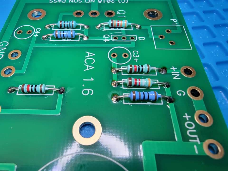

Making progress on my first ACA build. I practiced on a practice board, but of course it doesn't turn out as good when when it counts. When soldering from the bottom, I can't get the solder to flow enough to the other side to cover the pad. Is there a trick to this? If I use more solder, I get balls. I ended up soldering again on the other side to cover the pad, except for the big cap that sits flat. This is only my 2nd time (after the practice board) soldering on a PCB. Any tips or advice is most welcome.
Nothing jumps out at me - the -12db and the output hum from either input are indeed perplexing. The last thing I can think of tonight is to lift wires connected to the black speaker posts. One of them may have some kind of partial mechanical failure to ground. It sure seems mechanical - whatever "it" is. There are some other folks here that I am sure will jump in here and get you going. Will keep thinking about it.

First build some shorting RCA plugs and plug them in the input.
That will eliminated the suspicion that other equipment may cause the hum.
Building an RCA Input Shorting Plug -
Shorting plugs – PS Audio
You don't need to follow the instructions re. resistor value exactly, can even replace them with a piece of wire, the idea is to short the input to ground.
Then proceed with more fault finding.
@ Alekk
Start with the easy things.
First measure the resistance from the Red speaker socket to the Black speaker socket, both channels. I should be 500 to 1000Ω. It may take a few seconds to give a full reading.
Second measure the resistance at the RCA sockets. One meter probe on the outer gold ring , the other probe onto the centre pin. That should be about 50KΩ for both channels.
What do you get?

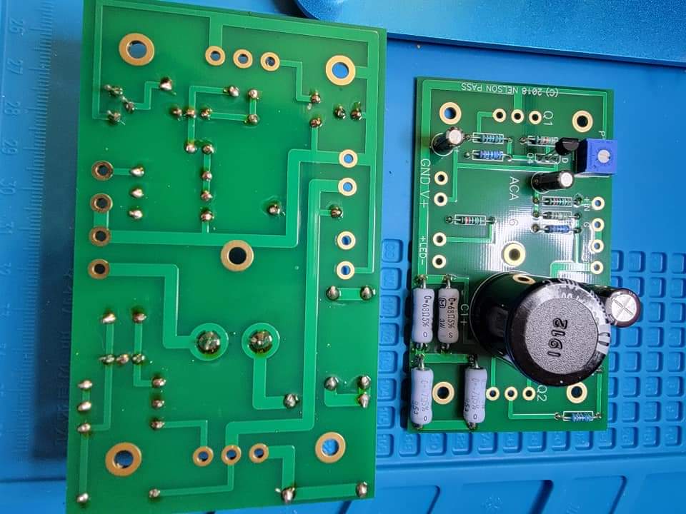

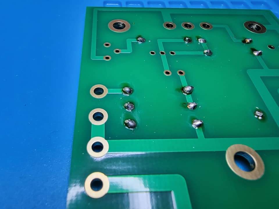

I'm relatively new to this...only started late last year and done maybe 1000 or so total solder connections. As such, if someone who is a real pro wants to correct me...let them!
100% had the same issues you had - and to fix it you need more heat and/or more time. I was very scared to too much heat harming things, but just takes practice to get things 'feeling' right. I use a soldering station (meaning I have a temperature control, and most of what I am doing is at 650 degrees (some would use a little higher, like 700, or maybe a little lower, like 600...but most people seem to be closer to the 700 mark). I am using Kester 24-6040-0027 (you can Google that number to see the details) solder and it is a dream to work with in terms of how well it flows and how consistent it is. WAY better than the generic stuff you get free in a kit.
Anyway, you are off to a good start. When making those solder connections, I would have the tip of the soldering iron TOUCHING the lead (of the resistor, for example) AND the solder pad on the PCB. Just a second or two, touch the solder to the very tip and it would immediately start to flow.
I think what might be happening is you are pulling the tip away too fast, leaving it on an extra 1-2 seconds should do the trick. If you have good light, you will actually see the solder sink down a bit (as it flows thru the hole), then you can lift the tip away. Flip the PCB over and you will see some solder coming out the other side of the hole, meaning you have a very strong and solid connection.
You can also reflow those connections. With a hot soldering iron tip, touch some fresh solder to the tip (easier to re-melt what is on the PCB), touch it to the solder joint. It will quickly liquify...but hold it for another few seconds and you will see the level drop a bit, and that should do the trick! You have a lot of solder on those joints, so you might not need to add any more...however you can feed in a little more once it liquifies if needed.
Going back to an easier comment (my worry about too much heat hurting a component) - you will notice the power switch calls out being careful...and the LEDs are also a little sensitive. Starting out, I'd rather be a little on the light side until you have more confidence on how much heat is too much.
I built a few kits like this to start with. I did not damage a single component, meaning things are probably more durable than you think. If you watch videos online about BAD technique, you see you basically have to leave the hot tip on the connection...and wait...and wait. Like 5+ seconds more than needed. It might be worth buying a kit like this and TRYING to damage something to see what the limit is!

7/10 for a first shot at soldering. Nothing to worry about from an electrical point of view, plenty of solder so a good bond with no gaps. Practice will get you better looking results.
As canonken says, use the best quality solder, 60/40 (tin/lead) not lead free types.
Keep your greasy fingers off the pads and component leads, wipe with alcohol of in doubt.
Tin the bit of the iron with a little solder before each joint, just enough to 'wet' the tip. That helps heat up the pad and lead when you touch the work. Once the tip builds up a scum or dirty flux residue, wipe it clean and re-wet the tip.
Wait for the work to heat up then apply the solder wire. You soon get a feel for how long to wait depending on the dissipation of the work piece. If hot enough the solder will just flow and also 'wick' to the other side of the joint.
Leave the iron just a second longer then pull away. (It is hard to damage modern components with too much heat.)
A good joint will be shiny and full. A poor joint will be dull or crystalline and shallow. Re-flow if you are not happy, we all have to from time to time, no shame.

Re-measured in slightly better conditions (save for the LF rumble), -9dB left channel compared to the right at 1kHz
Not denying that the hum may be from the source. The symptom specifically is that the hum is traveling through the right channel board/ input wiring (with the left channel input exhibiting the same behavior) to the left channel board, but the hum is not present in the right channel board ever. I can take a short video to clarify.
Both measured as expected, 50k at the input, 1k at the output.
Test point measurements attached, both boards measure nearly identically.
