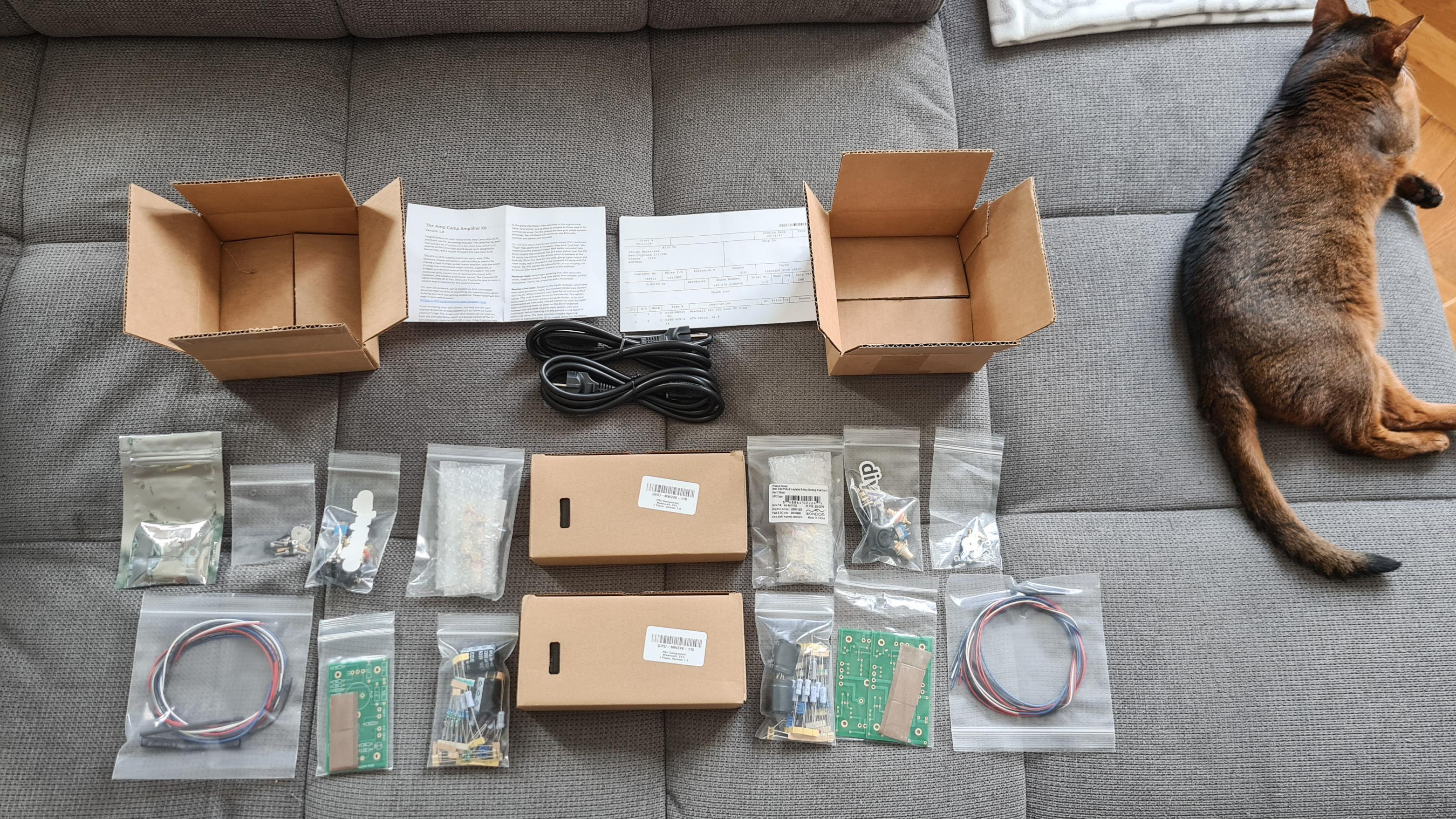

today - just moments ago - I received my two kits which I will build for 2x15W bridged. I am really curious but also sure that they will sound great 😀
Sadly, one kit came without transistors (silver bag). I hope that the store will find a solution.
Here is what came (minus cat😀).

With a cat in your home, check under (and on top) of every piece of furniture and appliance. Mine always managed to store things under the oven. Then check every dark, hidden corner of your home. If you find your car keys from years ago, then that's even better. If all else fails, check the litter box...
I'm sure the store will get you a set out ASAP. Make sure to e-mail them directly for fastest service.
Enjoy the build and the music!
Well, she was'nt in the near vicinity while I opened the boxes. So not her fault... this time 😀
Yes, I of course sent an e-mail immediately.
Luckily, I can start with the build of one amp, and it will be fun 🙂
Istvan

Maybe a stupid question, is there a remote chance that the silver bag contains the parts of BOTH amps? Maybe if you did it on a single order they combine your pieces to prevent more plastic waste?Hello,
Istvan
No, the kits are packed one per box, and there is only the amount for one amp in the bag.
