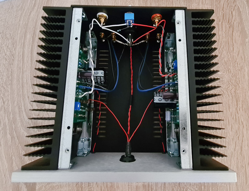

I just finished my first ACA V1.8 😀 it was a real fun build.
However, now I try to set the DC balance and I notice some strange behaviour. After turning on the DC goes up to about 12-13V but it begins to decrease immediately. It is the case with both channels.
Do you have a good advice for me? Or should I just wait for a while after turning on?

Yep just leave it on away from drafts but with room for air to get around it. The pots are very sensitive just the the tiniest pressure with barely visible movement will see the meter start moving. If you’ve got more than one meter it helps to have both sides hooked up at the same time. It’s a game of patience very tiny movements with a bit of waiting and watching each time will get you on target faster. It might take you an hour and you might not get to 12volt- if you can get to 11.8 or 12.1 both sides then turn everything off and wire it up for some tunes.and enjoy.
Nice work! Steve covered it, but don't be in a hurry. It will be all over the place when you power on...then settle down (voltage stops changing) - that is when you want to start to adjust. It is really hard to get it to 12.00 volts...but if you get it really close (I think I got to 11.95 on both channels) fine.

thank you, it was my meter...
Now the DC is set at 11,97V on both channels, I think it is good enough for the start.
One thing: the big 3300 uF caps are warm, is it normal?

Never touched the caps when switched bu the whole thing gets very warm. 8.00am Sunday morning. in NZ. I see your in Austria definitely time for some tunes and a beer.

give that time to warm up, i mean the heatsinks, then you can start adjusting, 1/2 b+ is the goal....
imo, adjustments using the scope is best, looking for the most symmetrical and maximum peak to peak sine wave...this is around 1/2 of b+...

are you sure you did not solder that in backwards, i takes a long time for that cap to pop if you get it wrong, that cap should not get real warmer than ambient....
@ Tony that’s way beyond the scope understanding and equipment levels of most of the kit builders. It would need some detailed instructions and advice on signal generators and scopes that are adequate for the job adding a lot of cost to getting the kit built. In the meantime ACA sounds pretty awesome setup with simple multimeter. I’m sure your correct but doesn’t help me or any other builders understand how to do what your suggesting. Would love a good explanation and photos of waveforms etc.
i am giving you options, you can use it if so inclined, otherwise having no test equipment is no hindrance to getting this amp set up, a dc voltmeter is all that is needed....
