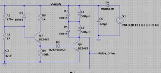

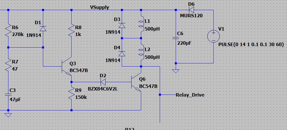

after finishing one of my ACA-kits there is one important question left: what about the DC protection? The turn-on/off noise is okay for me, and there would be a solution with a 100000uF cap. But the DC protection is not solved until now. Would the DC protection board/circuit from the store work with the ACA properly (or the question should be, would the ACA work properly)?

You don't need DC protection as such, the ACA can not endanger a speaker with DC.
What you need is a speaker delay to stop you hearing the noise at switch on which the store circuit should do OK although I'm not sure what the recommended voltage range is... but that should be a minor issue.
It does seem a bit overkill though and the board would take a lot of space up.
Have a look at post #32 here:
A possible approach to adding a silent start/shutdown to the ACA
This could be built into the ACA with the parts neatly soldered to the relay.
Thank you Mooly.
It has more parts than the whole ACA 😀
But maybe I could use the turn on delay circuit, without the DC protection. However, the turn on/off noise is not a problem for me.

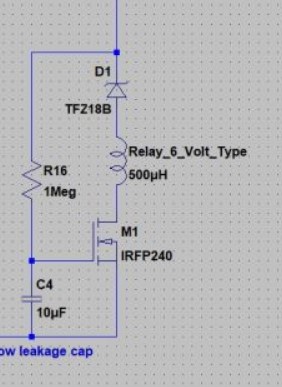

Mooly the first image with the MOSFET does not mitigate turn-off thumps; only turn-on thumps.
Neither does the second one with the BC547B, thanks to D6 and C6. The local supply stays high after the power is switched off, and it gradually falls according to an RC exponential decay, where C is 220uF and R is the sum of the coil resistances of the two relays. If the relays use 400mW coils, a typical value, then each coil is 90 ohms and so the RC decay time is 40 milliseconds. Way too slow when (A) the supply is an SMPS; (B) the amp is class-A biased at more than an ampere; (C) there is relatively little supply filter capacitance downstream of the On/Off switch.
Oh... this was the ACA WITH the delay circuit... 😀

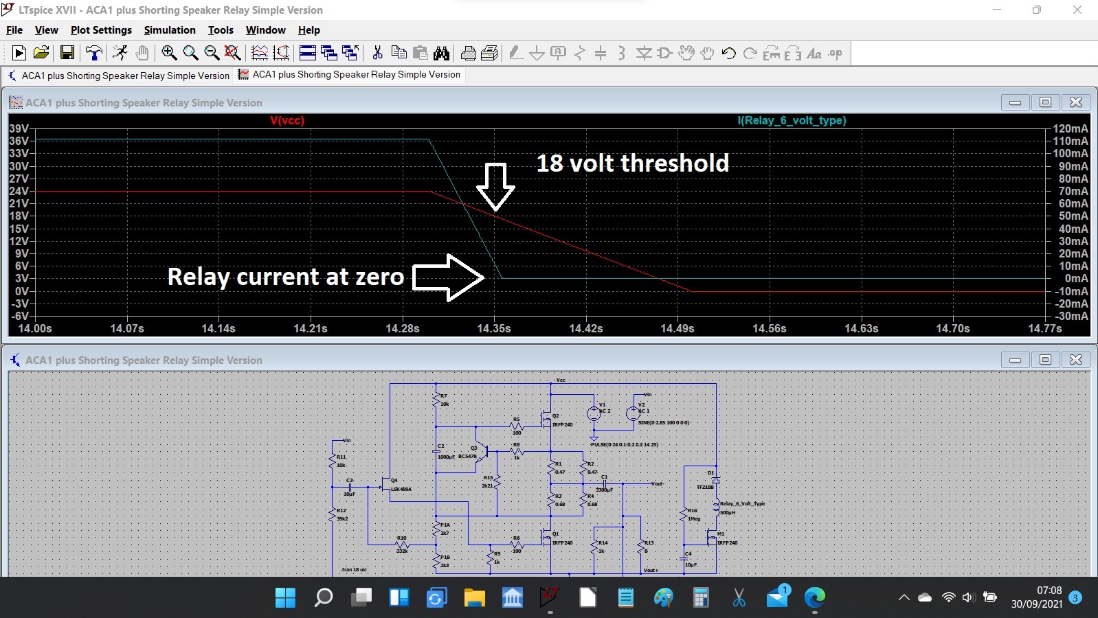

I think it would tbh. The recommended ACA power supply (the SMPS) will have a very short time constant given the high current draw of the ACA and the rails will collapse pretty smartly on power off.
As soon as the 24v rail starts to fall the relay current decreases and the 18v Zener ensures that once an 18v rail threshold is reached the relay drops out.
This shows the rail falling over 0.2 seconds.
Each ACA channel board draws 1.45 amperes; when the on/off switch disconnects them from the SMPS, this current discharges the +24V supply rail, and the rail falls according to I = C * deltaV / deltaT.
The discharge current I equals 2*1.45 = 2.9 amperes
The total capacitance C equals 2*10 = 20 microfarads ... ... remember, the on/off switch disconnects the amp from all of the capacitance inside the SMPS
So the slope of the ramp down is (deltaV / deltaT) = (I / C) = 2.9 / 2E-5 = 1.45E+5 volts per second. That's 24 volts in 170 microseconds.
I have a feeling that if you run your simulation again, installing a switch between the supply voltage source and the supply rail (now fitted with 20uF and a 2.9A current sink), you'll find that the relay current falls to 20% of its peak value when the supply voltage is WAAAAAY below 18V. You'll also see a scary fast falling edge on the supply rail.
