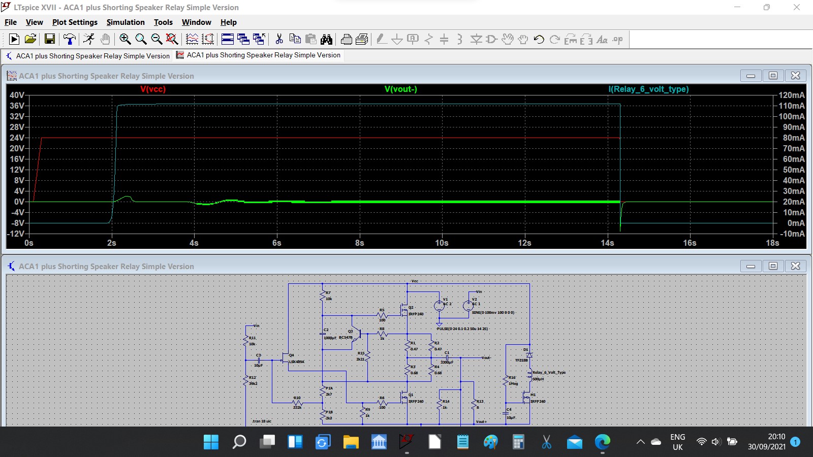

My test could be invalid, if switching off the AC input to the supply makes it that way. I leave the panel switch on and use a power strip instead. You may also glean some useful information from that scenario as well… : )
^ If removing the AC power to the SMPS gives a fade out of the LED then the rail is falling more slowly and in that situation the simple idea could work on supressing power off noise.
It is when the rail collapses instantly that we might run into trouble. By the time the relay opens the noise may well have happened... although it would still be really interesting to try it for real. That large speaker coupling cap would take far longer to discharge than the relay drop out time would be. Maybe the noise is only just beginning as the rail hits zero.

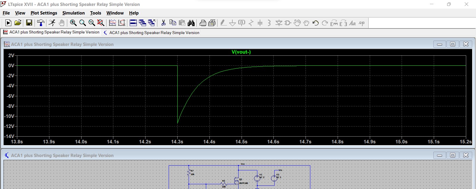

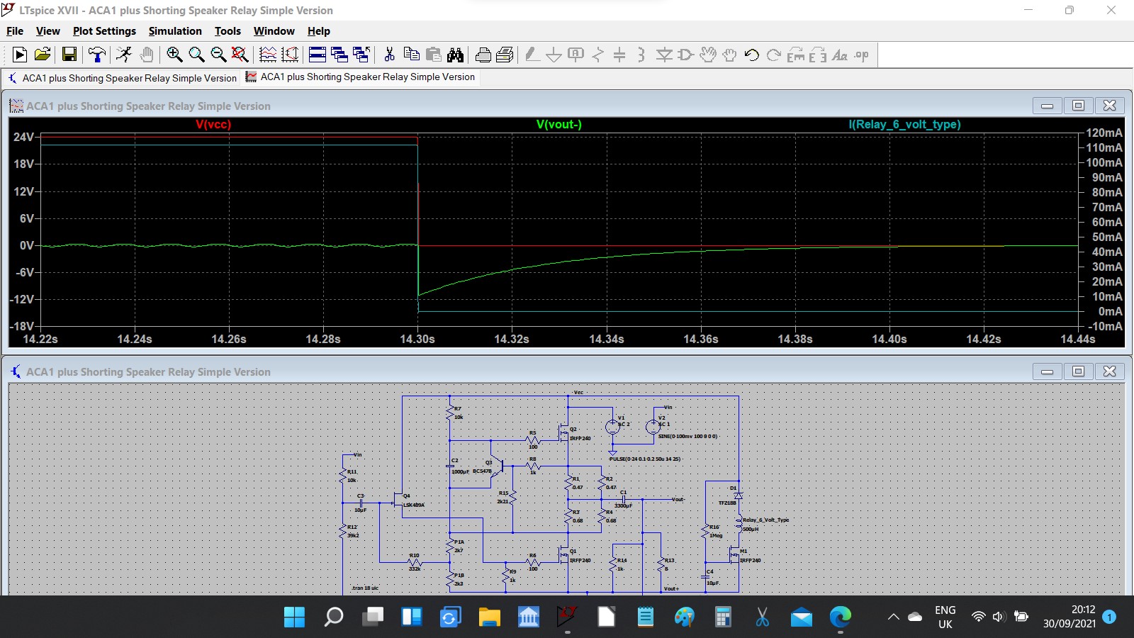

I'll post this for interest. Here is the ACA with just 100mv audio (green trace). The red trace is the supply and the bluish one is the relay coil current.
You can see the supply disappear 15 seconds in (the ACA gets turned off). I've set the supply fall time to just 50 microseconds so its quick.

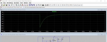

Notice the amplitude of the spike to the speaker. It dips to almost -12 volts as all the charge in the speaker coupling cap is pulled back through the speaker.
Second image is a close up of that transition. The relay current is reduced to zero quickly but I wonder how long a real relay would take to drop out.
One for another day... I have another idea as well that may or may not work or meet with approval.

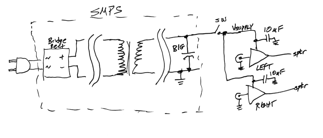

The amp output (positive terminal of the 3300 uF output coupling capacitor) instantly falls from +12V to GND. The negative terminal of the output cap follows the positive terminal {that's what caps do}, and instantly falls from GND to -12V. Since the negative side of the output cap is connected to the loudspeaker, the loudspeaker reproduces this 12 volt step-down waveform. It issues a pop sound.
Here's a picture showing why the SMPS caps are unimportant when the front panel switch changes from on to off.
