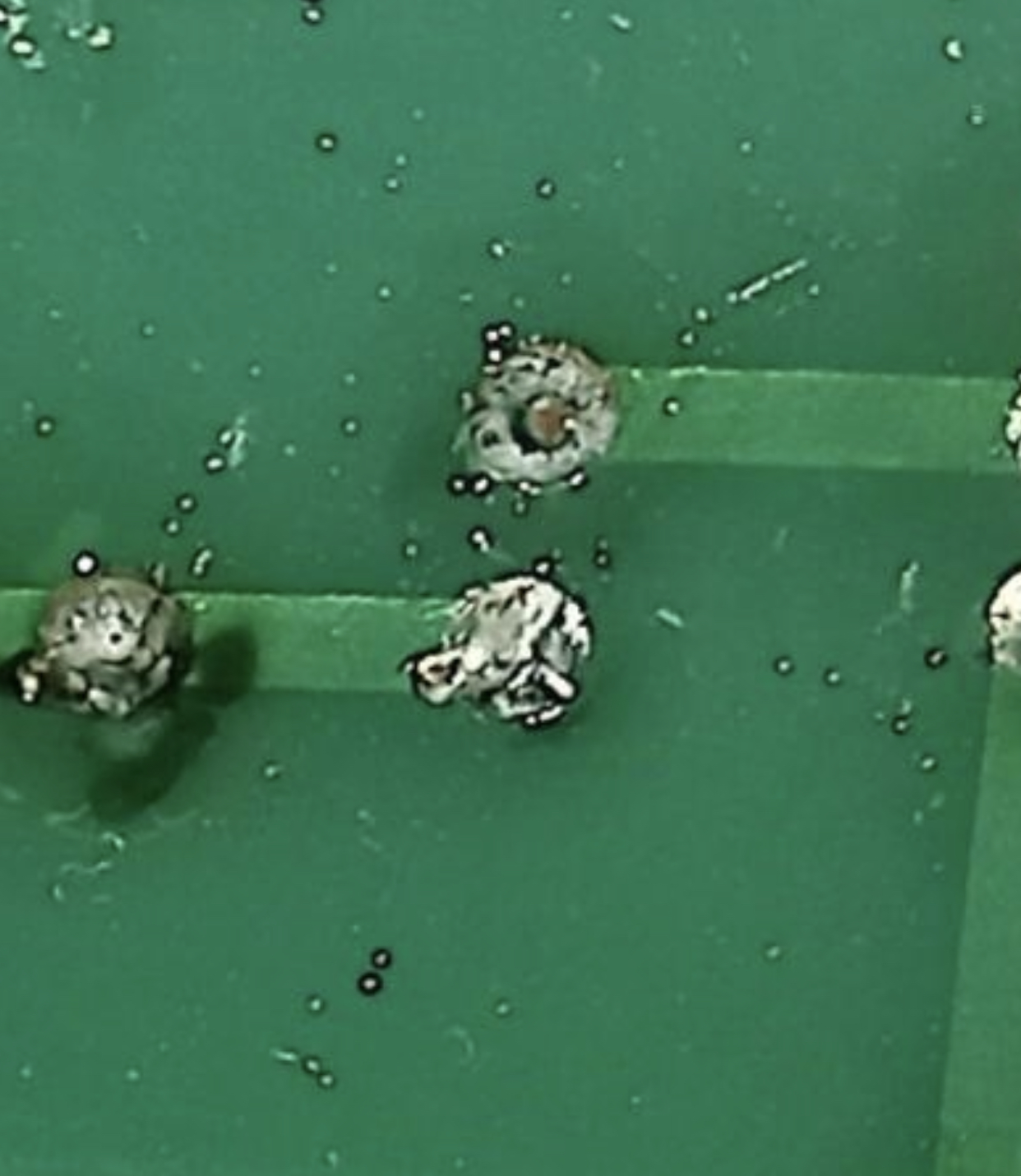

It seems to me that the PCB is a little burnt close to Q2 and it doesn't seem like it is because of a soldering iron being too close.
I saw that burn mark also. Thought it might just be a shadow, but it does seem to be blackened on the PCB.

I read yesterday that someone spotted this connection on C3.
Did you re-solder and see if your amp came back to life after? I didn't see any response so maybe you missed that suggestion? You sure are not going to get any current to flow through that junction for very long!
I did miss it, thanks, It looks awful on the photo but didn't spot it when I checked the actual board at the weekend, will resolder tomorrow.

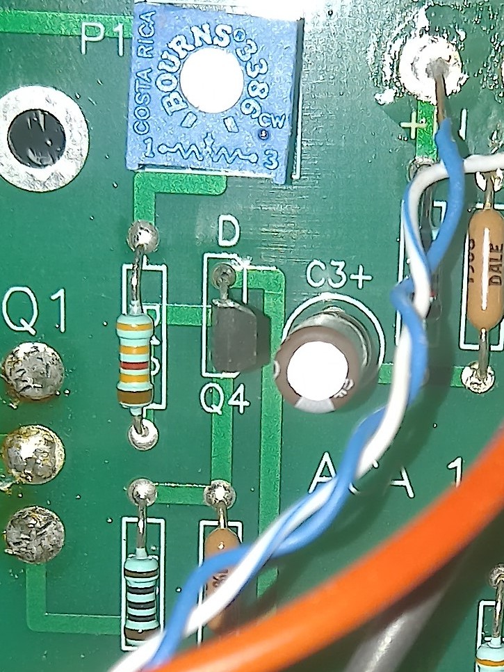

Toshiba K370. I built 2 identical ACAs at the same time, all ran well for several months, the other is still ok.Out of interest (and it might be significant?) what device did you use for the LSK170 / 2SK170 Q4?
Normally they both have a flat front and rounded rear body. The picture shows a clear flat on the rear face.
Alas what I hoped was the simple solution hasn't worked, I reflowed the dodgy joint but still no joy.
