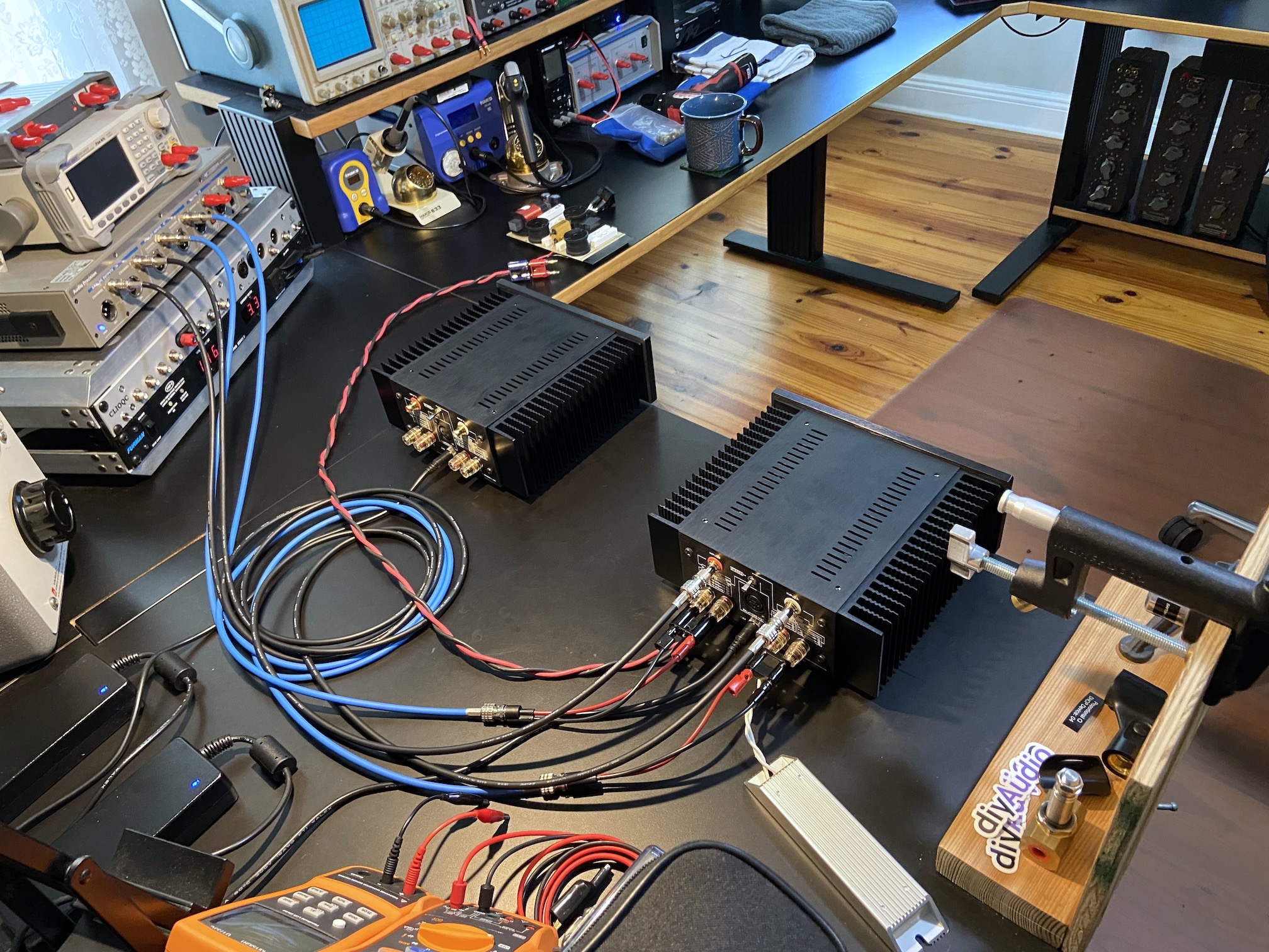

Hello!

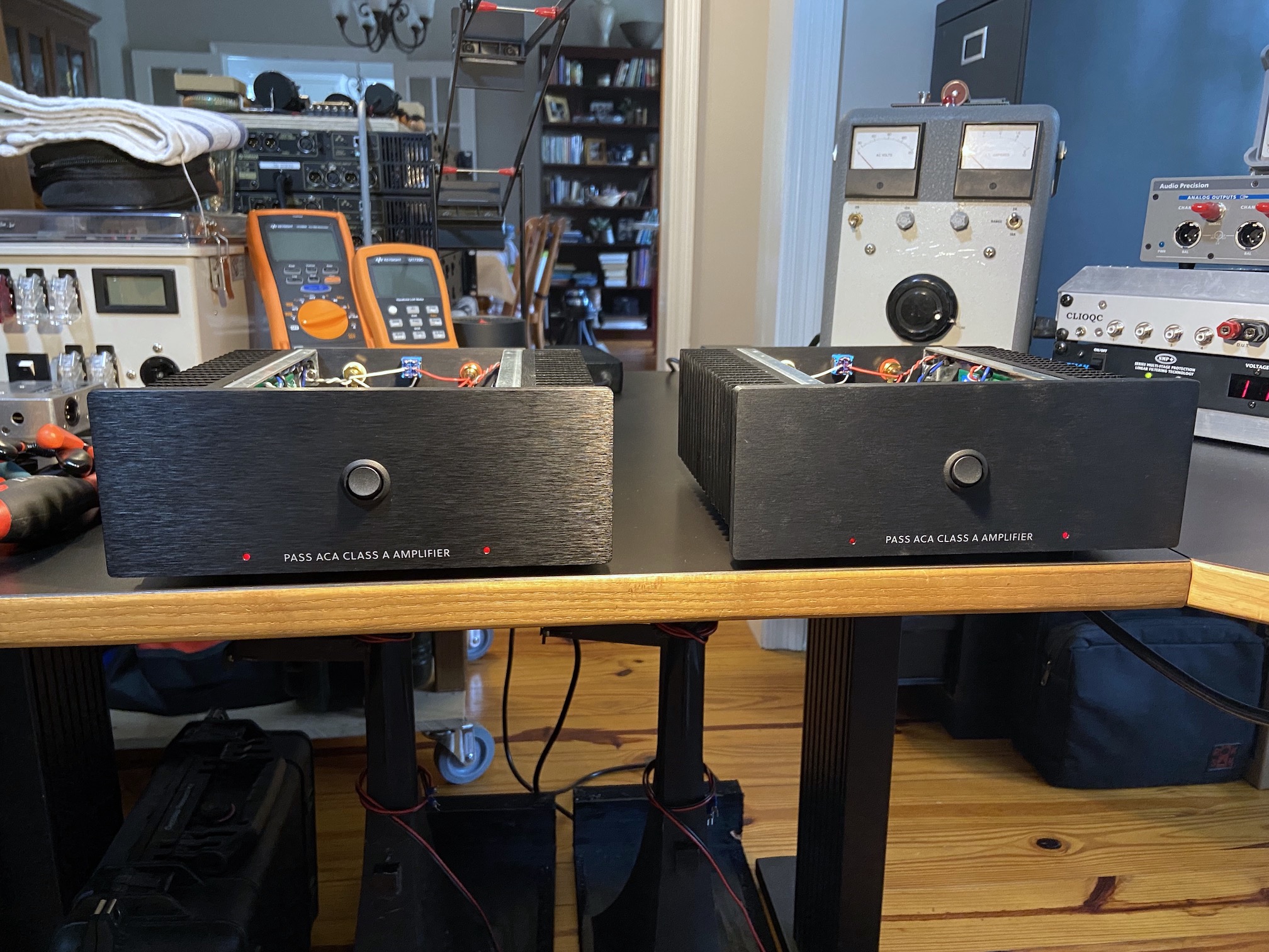

I just finished building a pair of ACA amps. It took 3 days because I've never done a ground up build before and I didn't want to screw it up. Oddly nothing blew up when I turned them on for the first time yesterday and they measure correctly as well as virtually identically in each of the (3) modes of operation. Amazing.
My initial application will be the high frequency section of a pair of biamplified Klipschorns with 8Ω B&C DE750 drivers on Dave Harris Tractrix horns covering 450Hz-16kHz or so. Their 108dB 1 watt sensitivity indicates that the little ACA amps should provide plenty of SPL. I'll be using a larger amp for the low frequency sections.
The thing that caught my interest in these amps was Nelson Pass and his particular take on high-end amplification that I've yet to experience. The low cost of the amp kits sealed it.
I'm a measurement nut. I haven't even listened to the amps yet and wanted to be dead sure they worked properly first - because I don't trust the guy that built them. I also wanted to see what Papa Pass's amplification philosophy looked like through analyzers that I've been using in audio for decades, professionally and as a hobbyist.
The ACA amp is fascinating. It is the definition of a minimalist design and how it handles overload is the most graceful thing I've ever measured. Tomorrow I will have my first chance to listen to the amps and my expectation is that I won't notice the distortion until it's 5 or 10 times higher than any other amp I have. I restored a pair of MC275's a while ago and they have a subjectively soft overload quality. My measurements today indicate that the little ACA amps are better still in this regard by a large margin. We'll see.

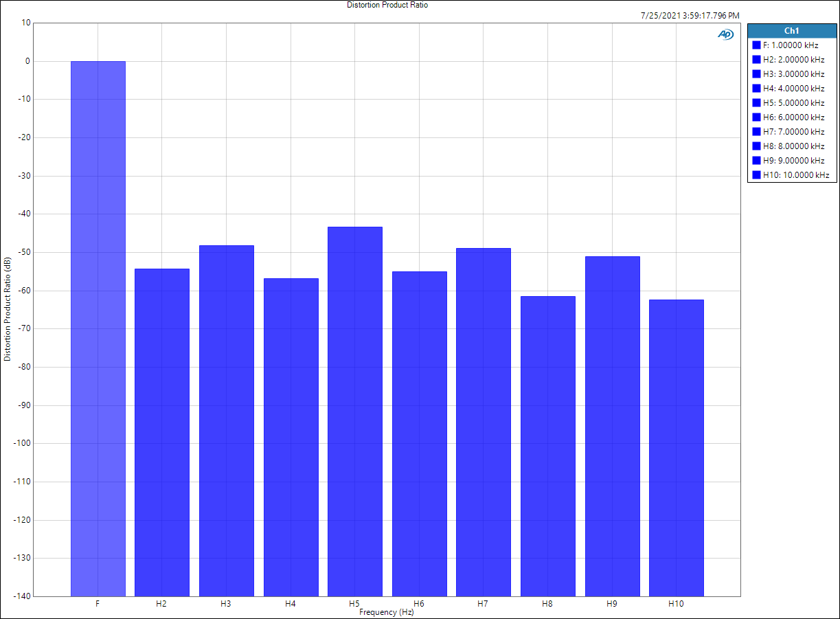

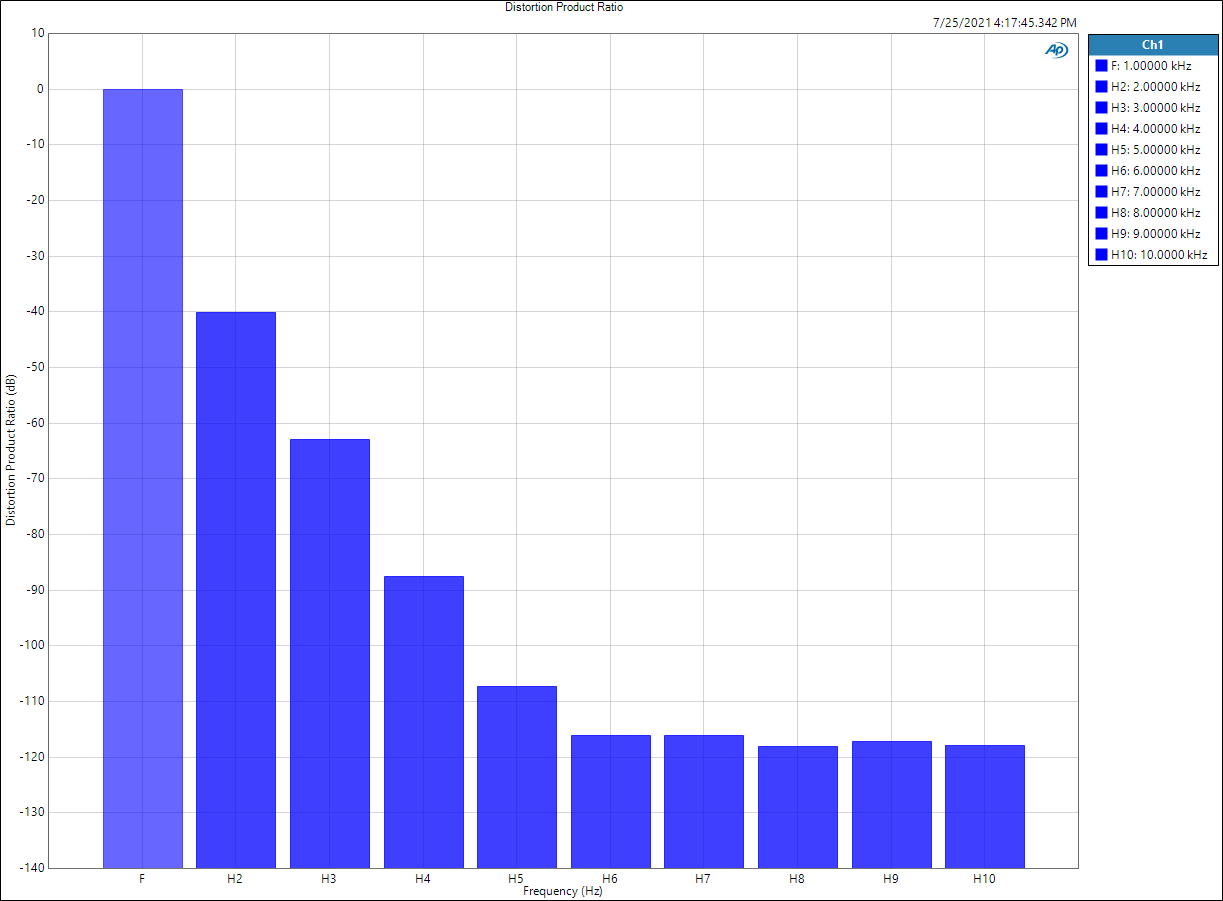

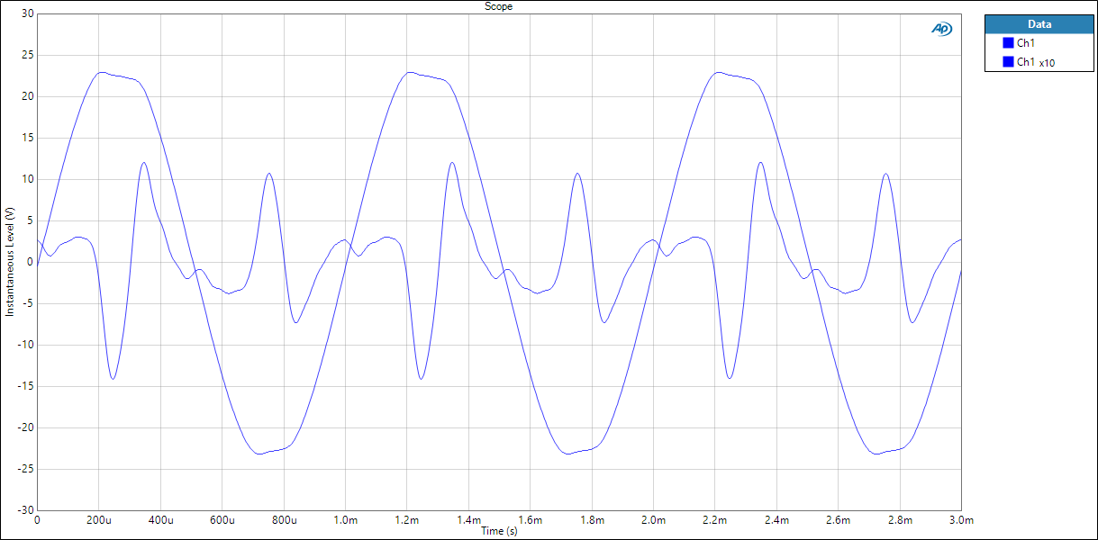

Compare the 1kHz 1% THD harmonic output of the MC275 into 4Ω with the ACA amp at the same frequency, THD level and load. Both amps in stereo mode, both channels driven.
MC275
ACA Amp

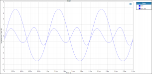

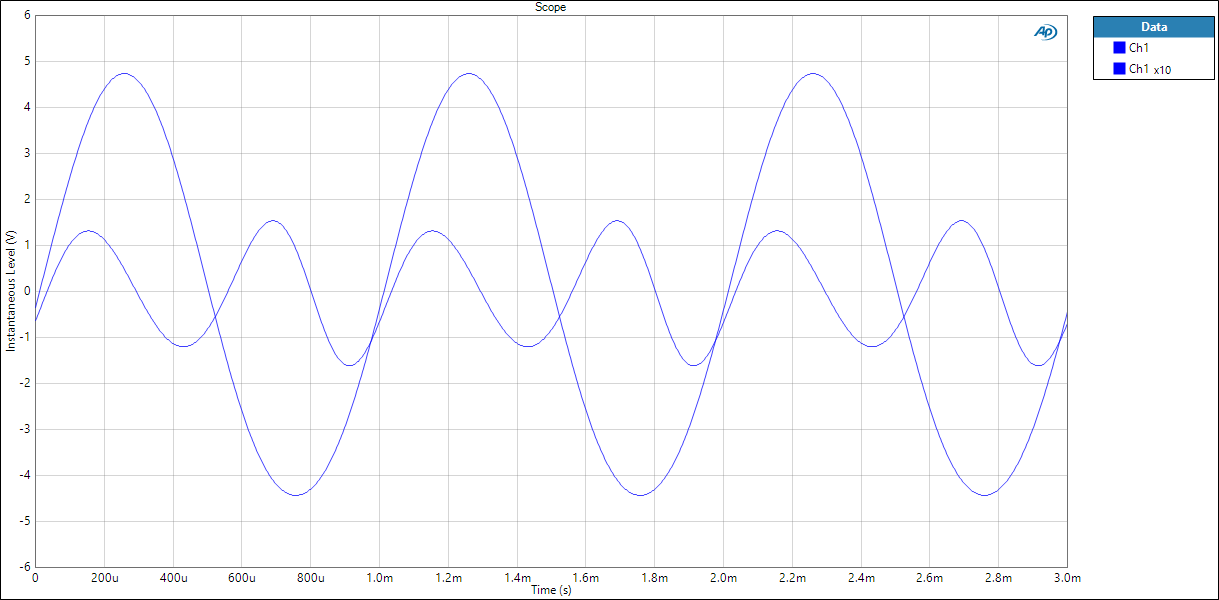

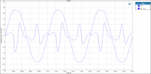

Now compare the scope output of these two amps at 1kHz and 3% THD (the higher THD level accentuates the differences). The smaller waveform is the distortion component raised 20dB (10x).
MC275
ACA Amp

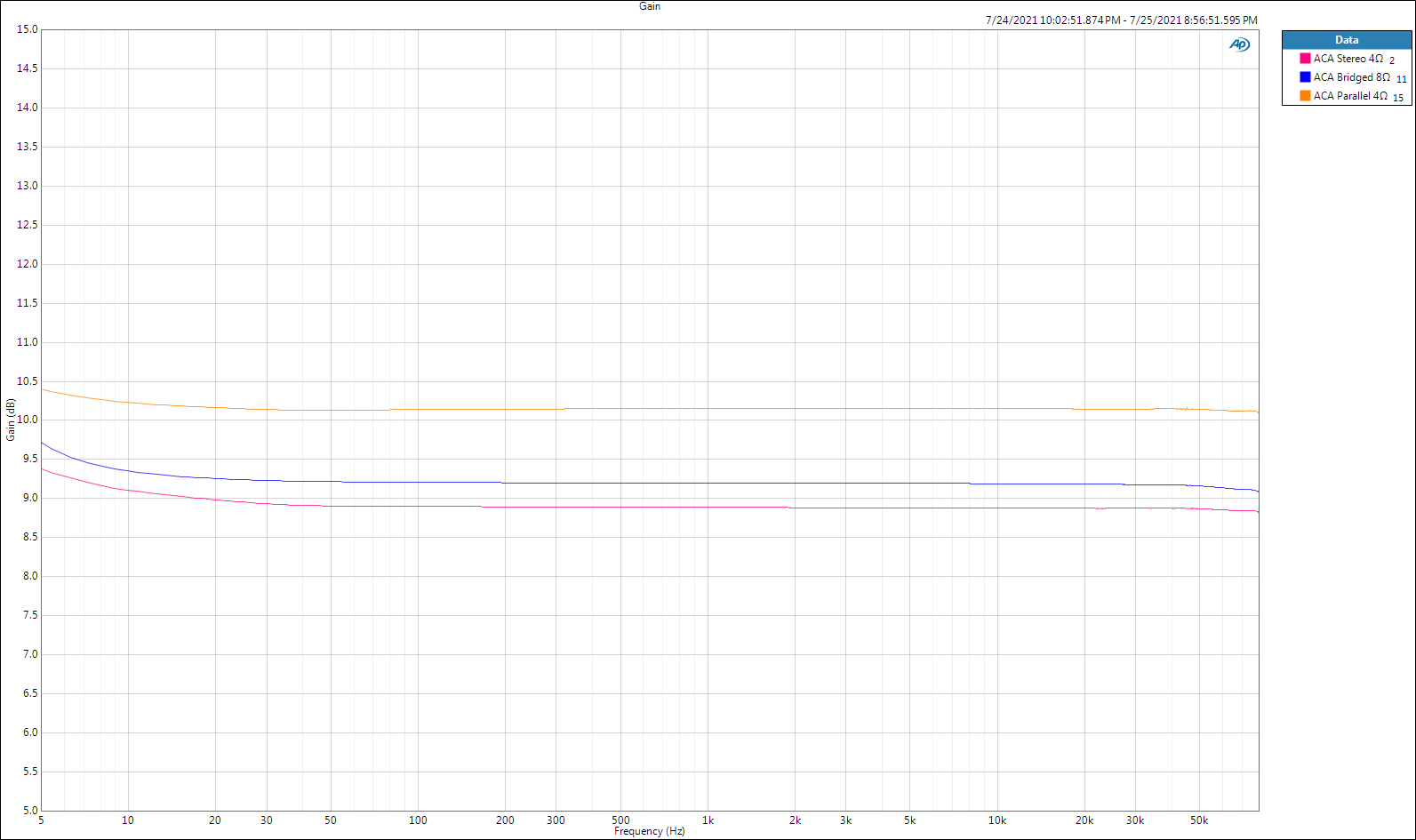

The gain of these ACA amps is about 9dB Stereo or Bridged and about 10dB in Parallel mode. The circuit gains are about the same across modes, thus the additional gain in Parallel mode is due to the halved output impedance (relative to Stereo mode). By this reasoning, you'd expect Bridged mode to have the least gain because of its doubled output impedance (relative to Stereo mode), but I used an 8Ω load resistor in that case, thus the slightly higher gain than Stereo mode. I prefer very low amp gains like this because it improves the gain structure (S/N) of the system assuming your preamp can provide the voltage needed to drive the amp to its max. output. The Benchmark ACB2 amp is probably the S/N champ and it has a 9.2dB gain option to achieve this. Papa Pass hit several useful birds at once with the low gain stone.
Stereo, Bridged and Parallel mode gains measured into 4Ω, 8Ω and 4Ω respectively

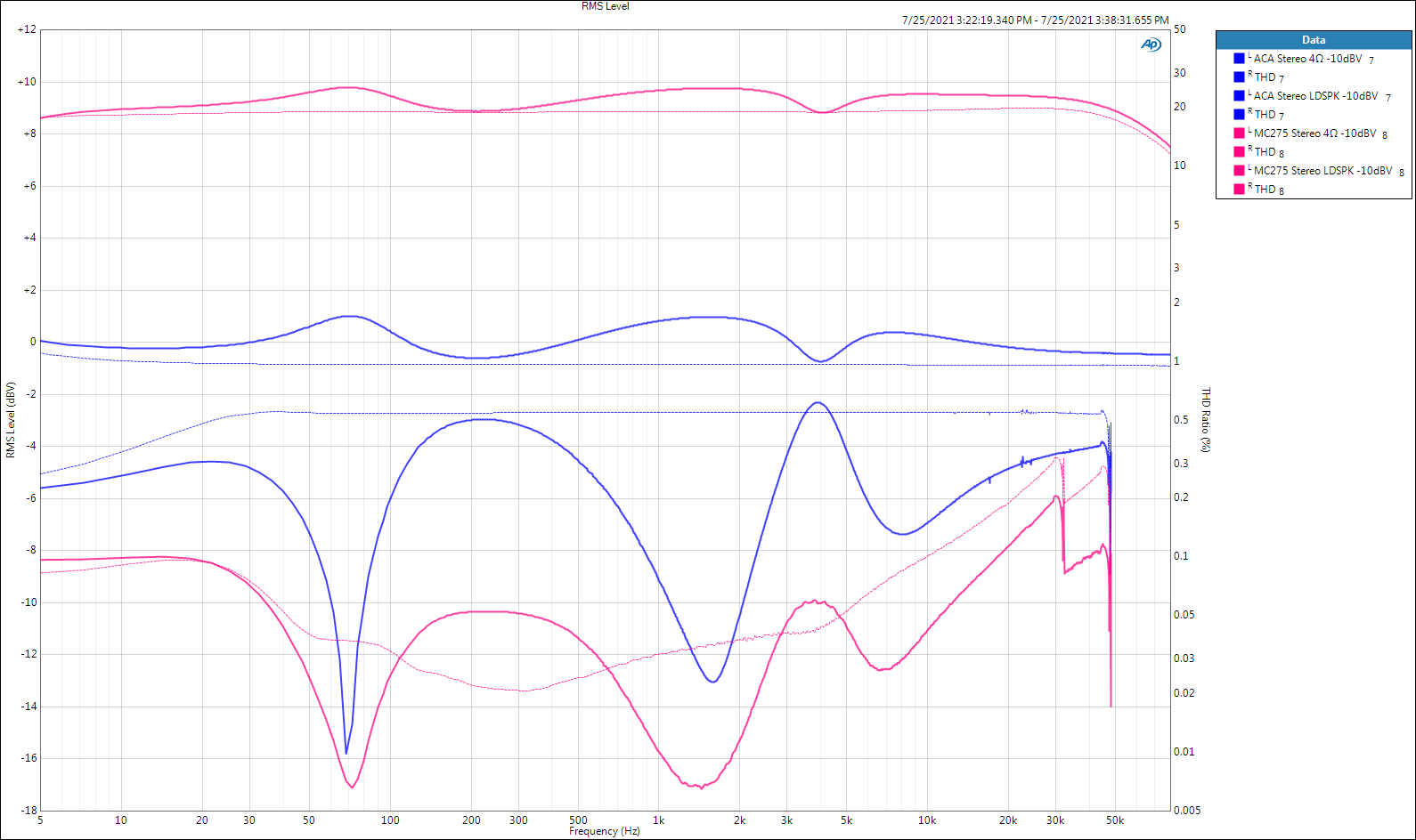

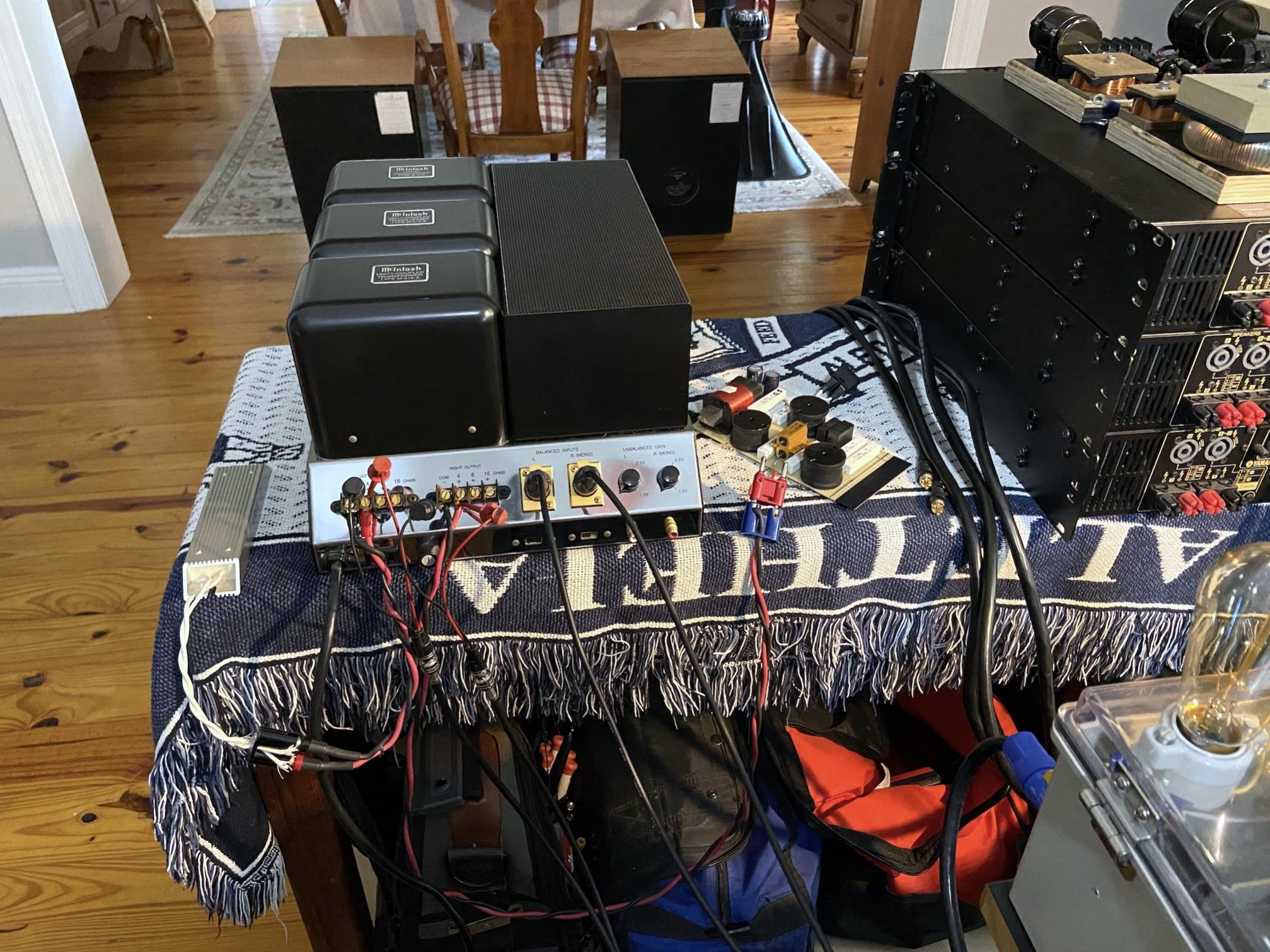

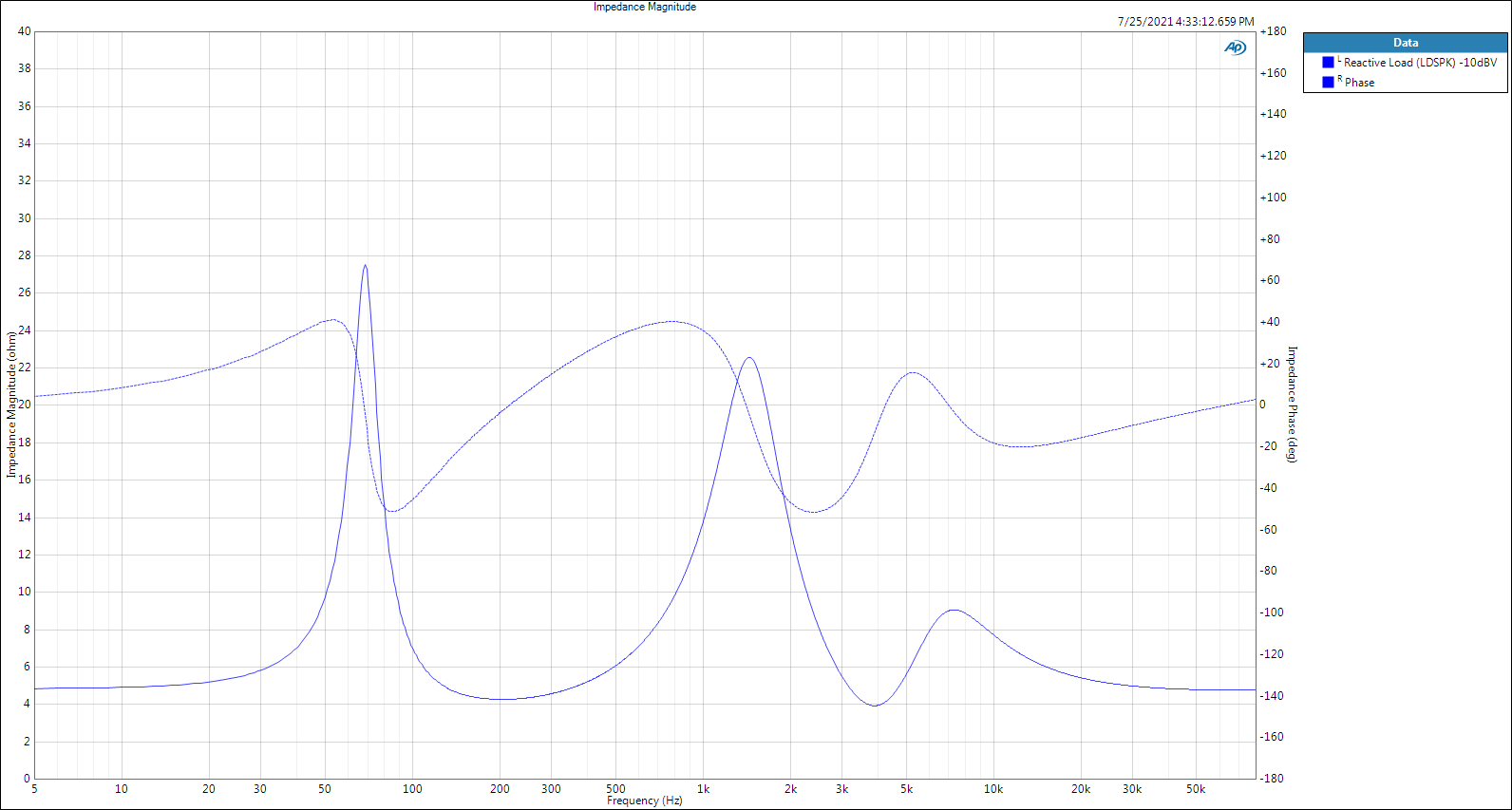

Going further with the gain concept and the ACA Amp / MC275 comparison, I set both amps in Stereo mode with their left channels loaded by a 4Ω resistor and their right channels loaded by a nominal 4Ω 2-way moving coil loudspeaker simulation circuit.
Impedance of the LDSPK simulator
While damping factor is a red herring, the output impedance used to calculate it is not. The reason it's important is that it forms a voltage divider with the load, and when that load's impedance is variable, as it is with loudspeakers, it causes a variable frequency response - effectively a form of EQ. The lower an amp's output impedance, the less the effect, although... if the "EQ" sounds better, who am I to say it's "wrong"? :) IMO, this effect is a primary reason some people prefer tube amps over solid state and vice-versa. The ACA amp has tube amp-like output impedance, thus will undoubtedly prove the best of both worlds for some and the worst for others.
You'll notice a bit more "EQ" variation with the ACA amp vs. the MC275, indicating the MC275 has a little lower output impedance across its 4Ω output terminals than the ACA amp in stereo mode. Not shown is the fact that the ACA amp in Parallel mode has lower output impedance than the MC275, thus less magnitude variation.
Magnitude and THD at -10dBV drive levels into 4Ω (light, dashed traces) and into the loudspeaker simulator (heavy, solid traces)
Measurement Setups
More to come.
