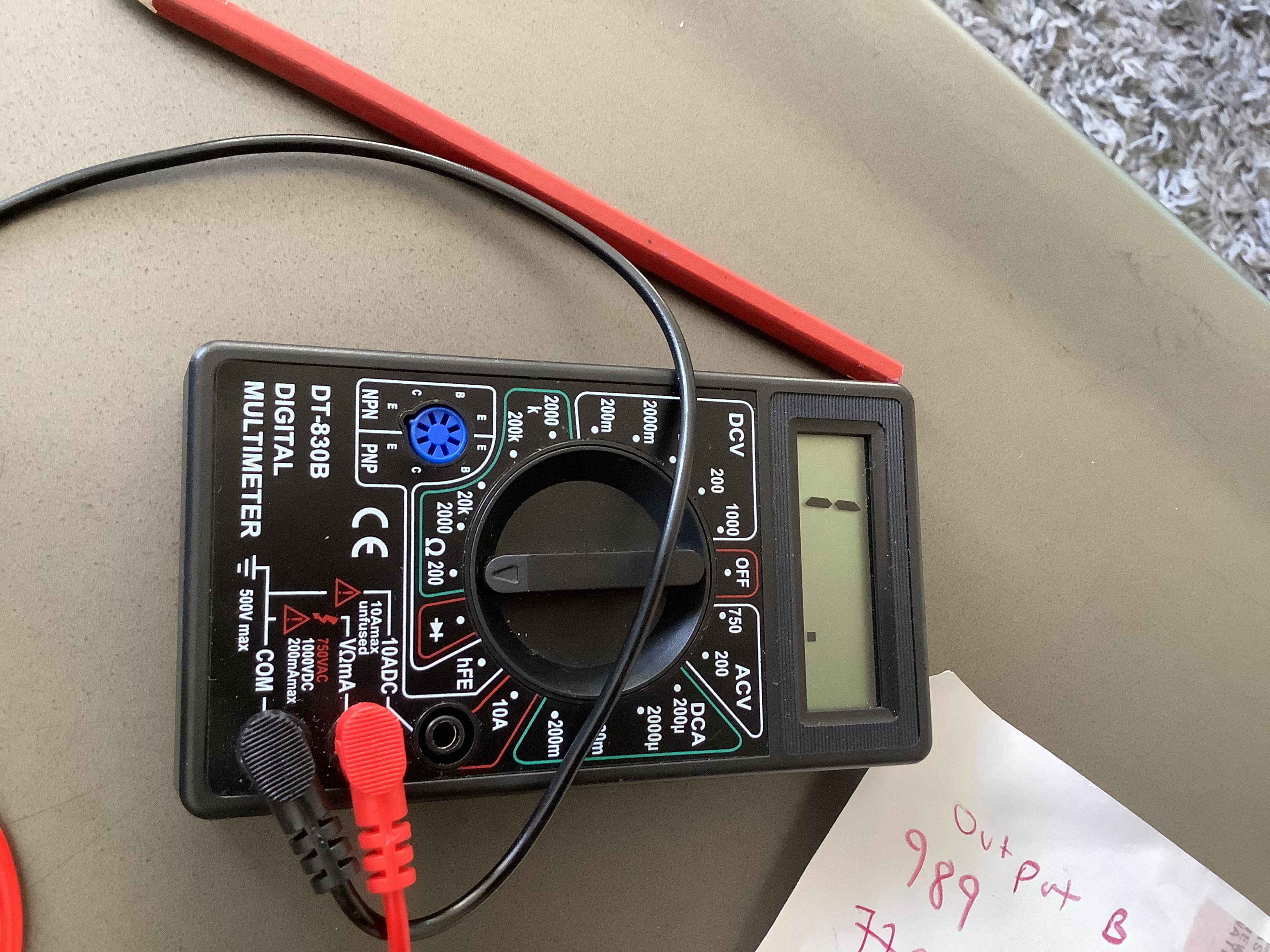

Hey Alan4411.
I did the tests you said to do.
Speaker output B reads 989
Speaker output A reads 775 but creeps up to 975 over 60 seconds or so ( was still creeping up after but very slowly)
Couldn’t get any reading from either RCA inputs. I tried outside and inside but got nothing.
I haven’t done the bias yet. I will do that next.
AlexJones said:Speaker output B reads 989
The speaker readings are fine. That's good.
I do not understand ''Couldn’t get any reading from either RCA inputs''.
Do you mean they are open circuit or short circuit?
Look at the picture I've posted, meter on 200k ohm range and put one probe on the centre pin (where the red and white wires go) and the other probe on the nut. Try again. If possible post a picture of the readings you get?
Did you set the bias on the previous ACA you built?
Alan
The meter doesn’t change when I do the RCA inputs. It reads “1”.
I did the bias on the first amp, yes.
That is just out of range on the meter. Its set to 200 ohms.
You need to set the knob so it points to the 200k setting (3 clicks clock wise...) and try again.
