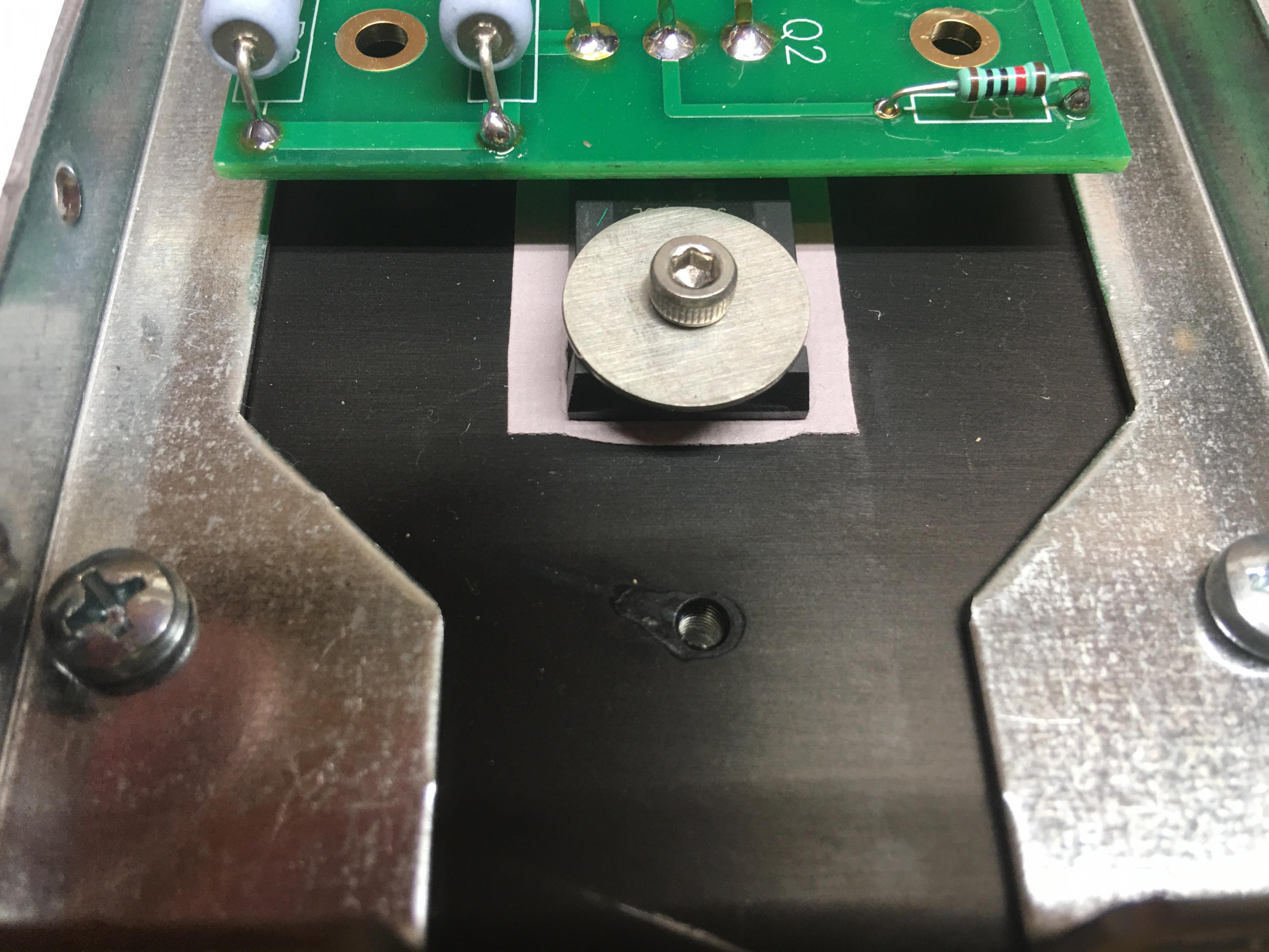

Ive soldered one board except for transistor C1. Can those thick little tabs be bent to hold in place? Will also search this. Just wanted to share that Ive progressed (at snail pace). Finally was getting a grrove then got stuck on C1.
C1? Do you mean Q1, the power FET?
You can bend lead wires gently but try not to sharply bend them as that fatigues the metal . Also never bend the leads where they emerge from the package as that can damage the package. Hold the leads carefully and bend a millimeter or two away from that point.
It is usually best to mechanically fit the parts to the heatsink first and solder last so that no mechanical stresses are applied to the devices when they are bolted down.
It appears I've put a bit too much torque on the transistor screws...should I replace Keratherm insulator?
