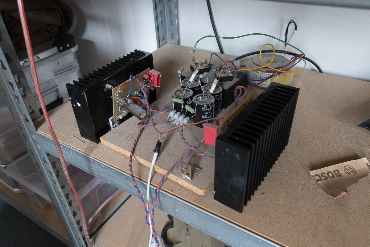

I built an ACA version for a headphone with IRF830. Bias is around 120 mA.
I run both channels from their own 12 volt DC (disregarding post 1489) and it works. But there is some HF problem.
I moved on to 24 volt (I put the two 12v SMPS is series and ordered some 24V versions) . That works very good. No HF problems anymore. Very stable operation. I get 150 mA at DC of 11-12 volt on output cap. Solid performance.
Just one problem: One channel shows disconnect signal, discontinuing, often OK and then all at once there is flutter.
- there must be a loose element. But. I have resoldered all parts.
- Maybe the [small] carbon composite I use as current settling resistors? (2.2/3.3 ohm). I can replace it with one 5 ohms. [I have one over in my box]
- or the only thing left is the pot that might have a loose contact.
ACA build for headphone (just to share some experiences)
Found out: I use the zerozone board. That has no power supply decoupling. BAD BAD Panda!
I first saw that touching the feedback resistor, with the parallel 10 pF taken away, that this channel would go in oscillation. Giving eratic current too.
Bypassing the diode from the kit gave no improvement.
Adding a cap (4700u/40) on the board did solve the oscillation. I will go to a smaller value, I have 220ohms/47u in the other channel. That one is stable.
Just one problem (28/6): One channel shows unstable signal, sometimes disappearing, often OK and then all at once there is flutter.
- Having the power supply via a multimeter on the testbench to see the DC current of course does not help at all. Silly me.

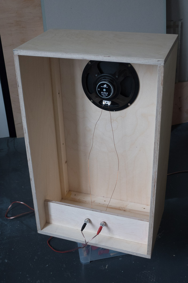

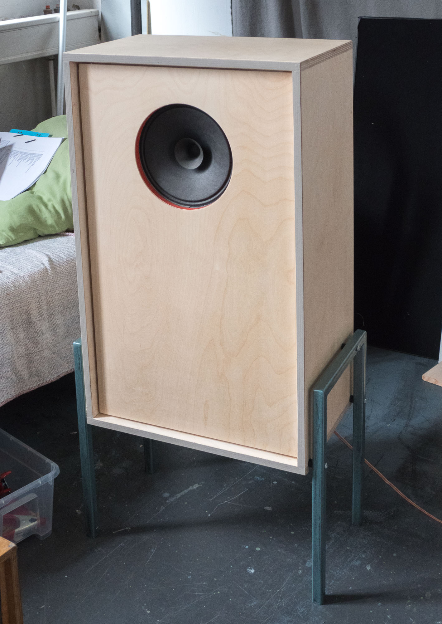

Beautiful work on the speaker cabinets. Did you follow an existing design or create them yourself?

Just a friendly suggestion. You might want to give that ACA a vacuum. That fine layer of sawdust is not showing off its best features.. 😎

tell us something about that Monacor driver
you can write in Da Pub, if you don't want here
how it fares with Monacor SP200X ?
edit - you Dodo
