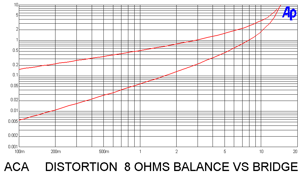

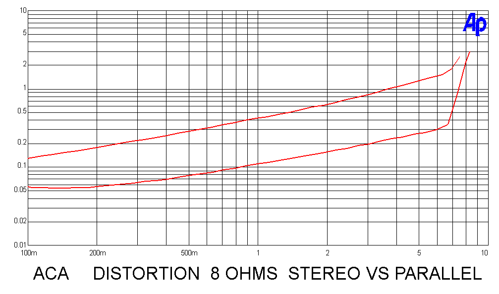

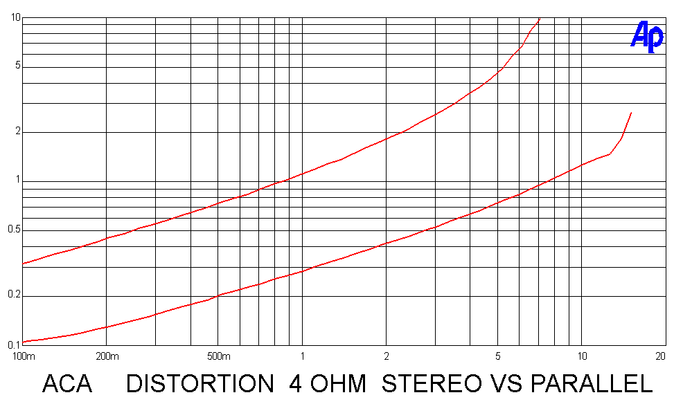

Johnson's Quadratic Law of Design Reviews:
If you present "N" pieces of quantitative data, the audience will demand (N squared) more.
i go for a bridged AMP Camp...
Yes, but will they ask for p-values? 😉
...which curves are which?
lower ones are for more
lower THD for parallel and bridged (last case)
Obviously parallel gives lower distortion, and in the case of balanced
vs bridged, the balanced has the lower distortion.

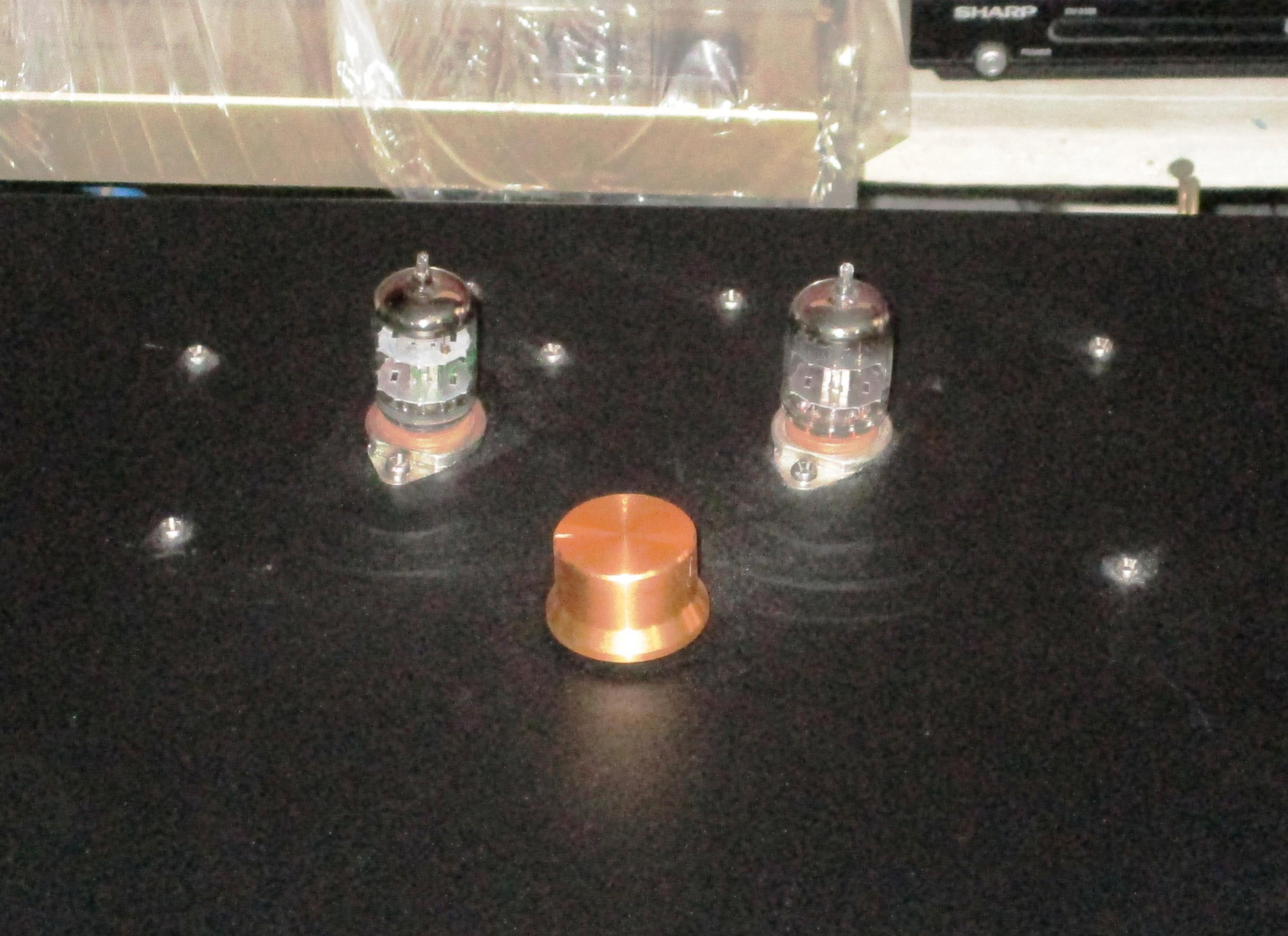

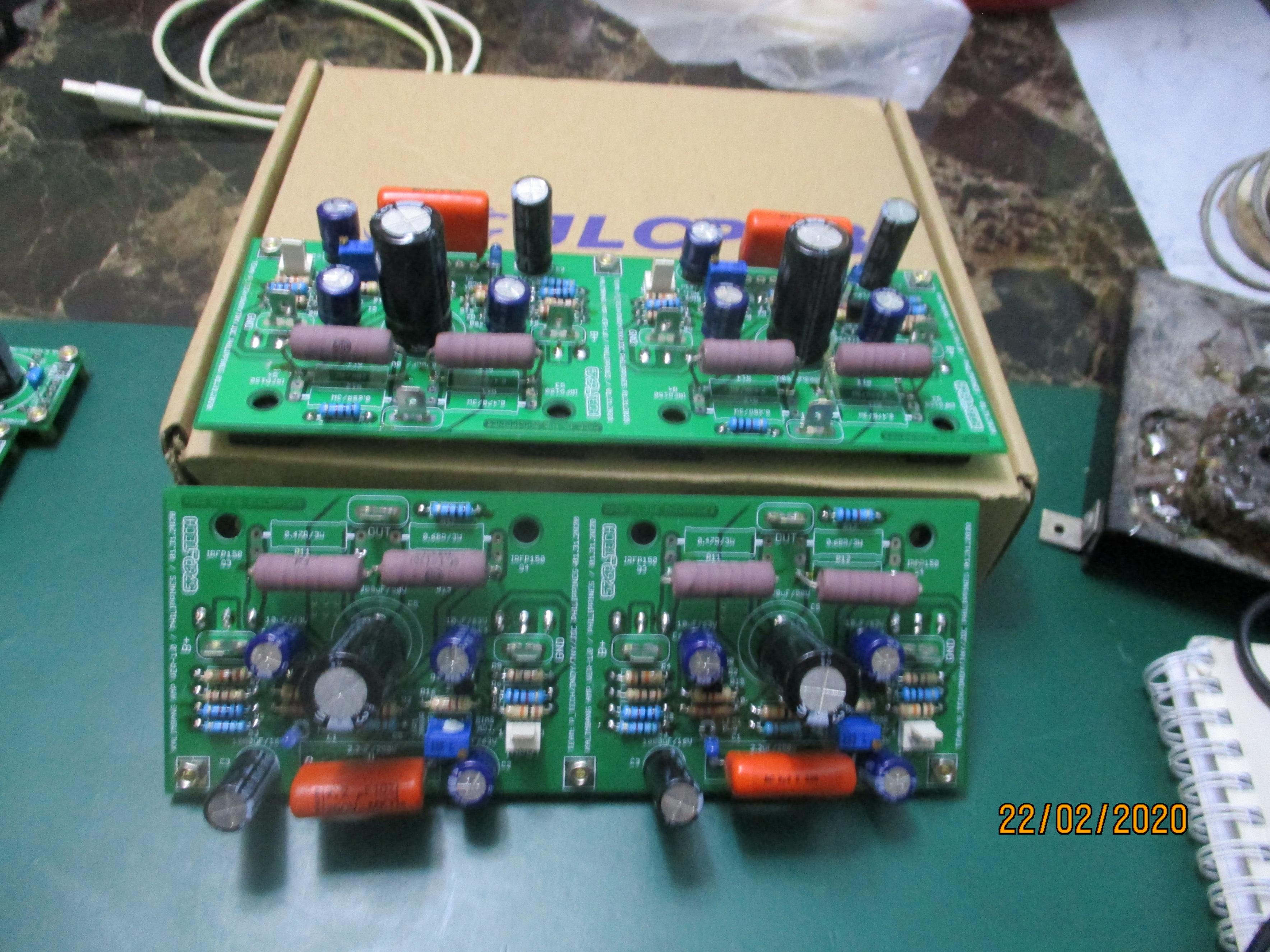

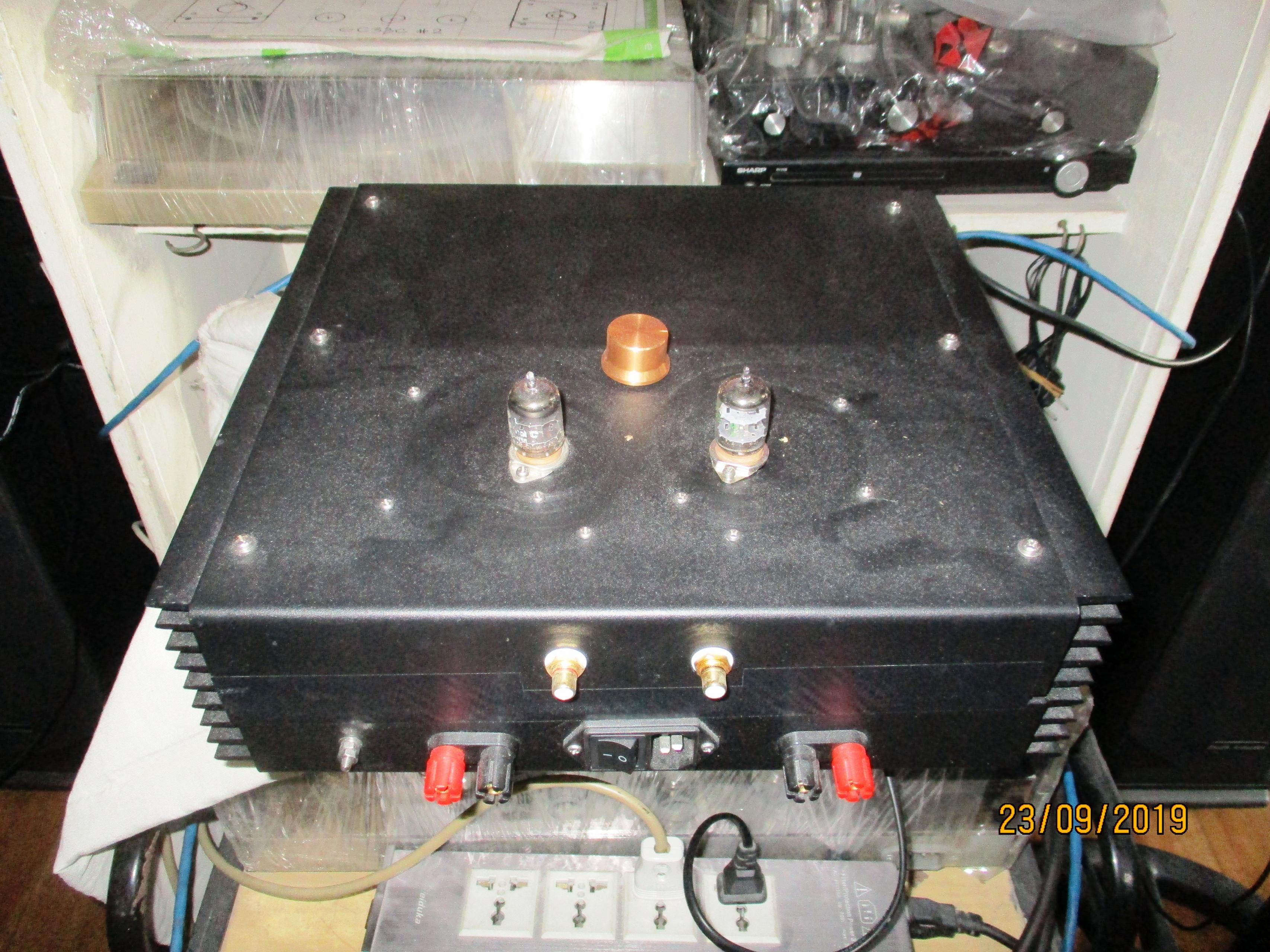

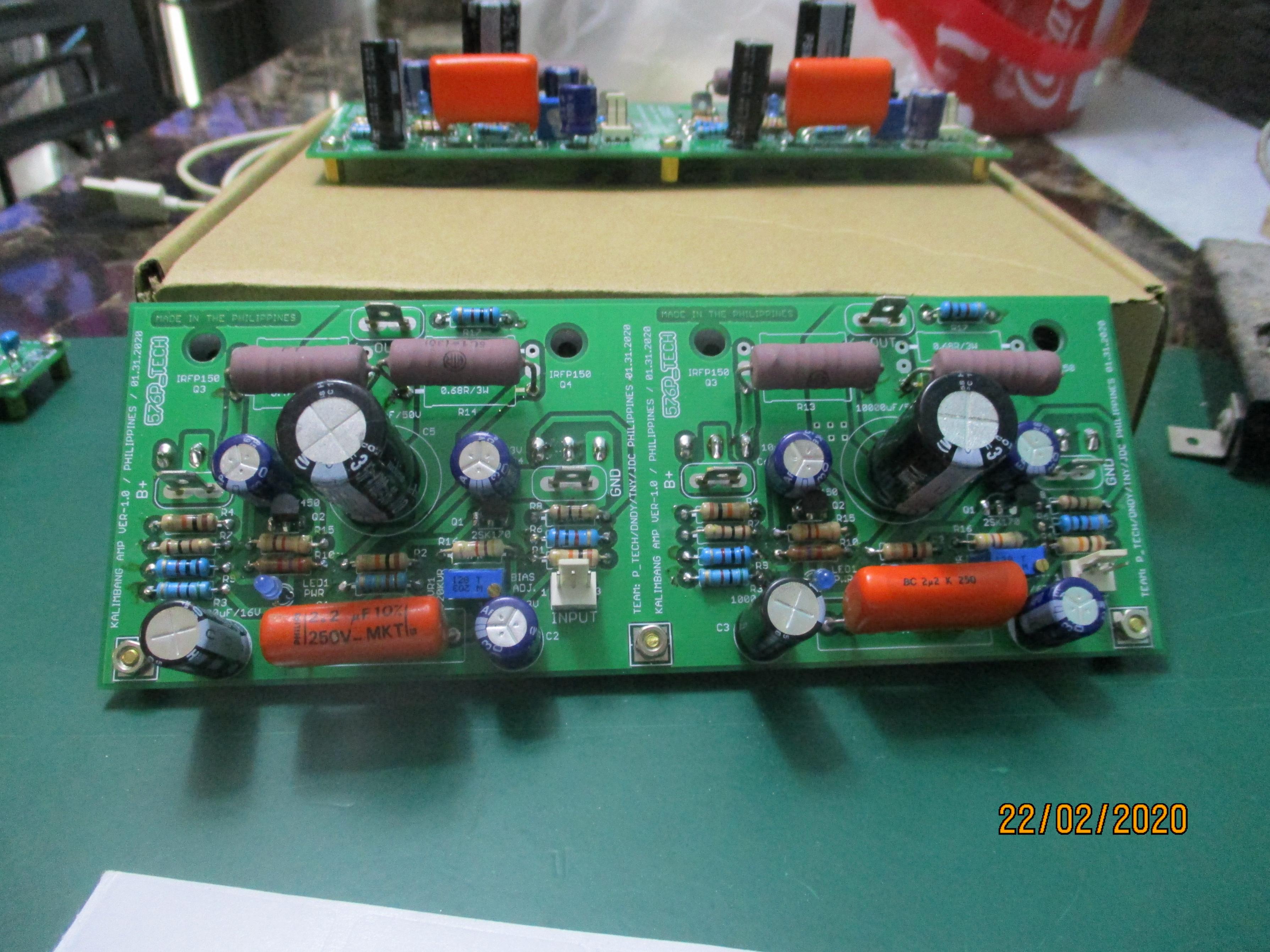

i am making one now, 48vdc, 4 smps psu, 4 ACA channels, and based on the data above i will be making it balanced bridged type using XLR's....i may even throw in a tube buffer to give it a tube flavor...
i am using the conrad engineering 35cm heatsinks....will post once set up..
What is the power output of a parallel 24V ACA into 4 ohms?
The power into 4 ohms would be twice that into 8 ohms if you run them in parallel.
Parallel connection only gives you more (double) the available current, the voltage output is still the same.
For example.
1/ 9 volts rms output into 8 ohm is 10.125 watts rms. The load current is 1.125 amp.
2/ 9 volts rms output into 4 ohms is 20.25 watts rms. The load current is 2.250 amp.
