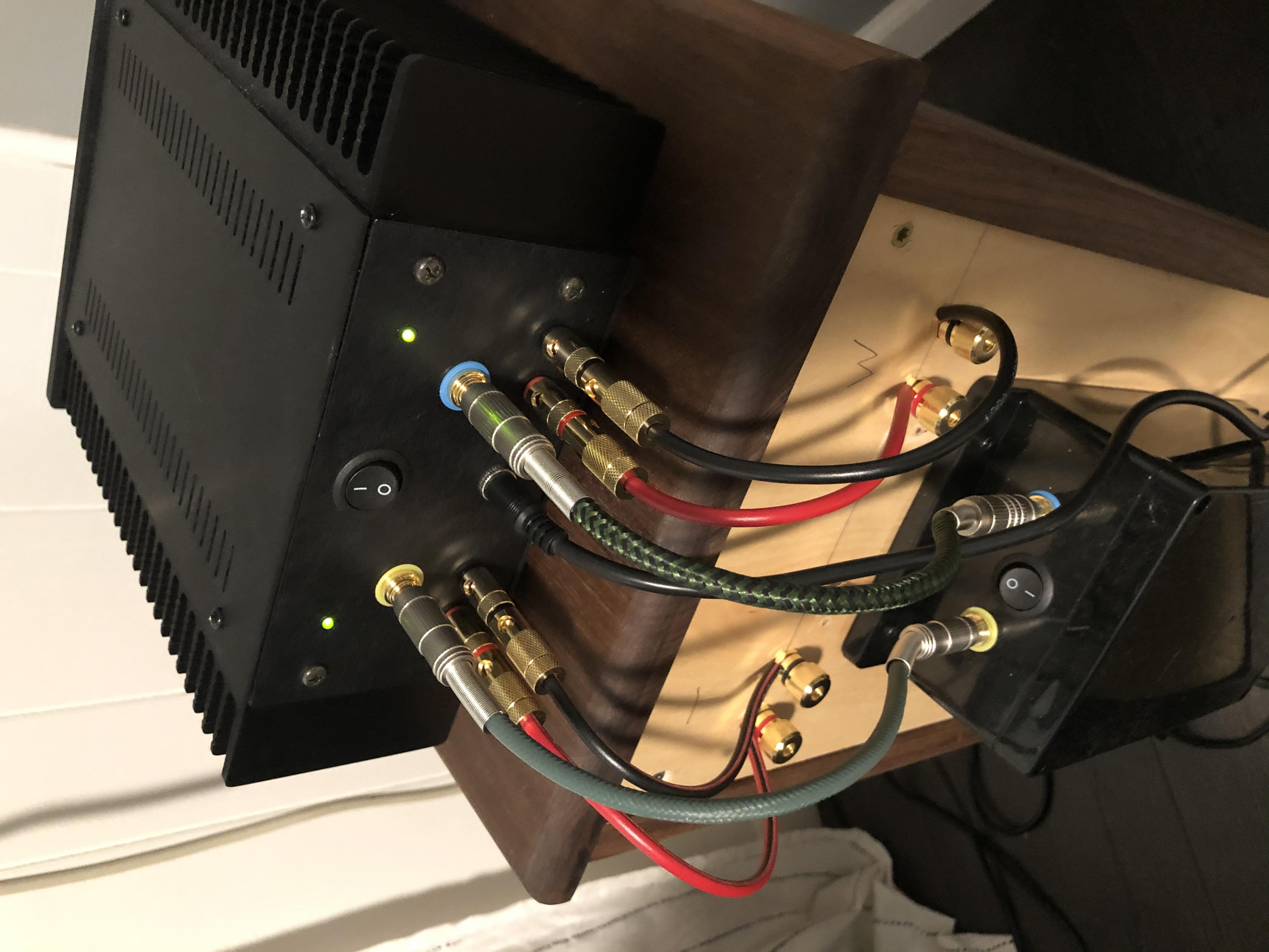

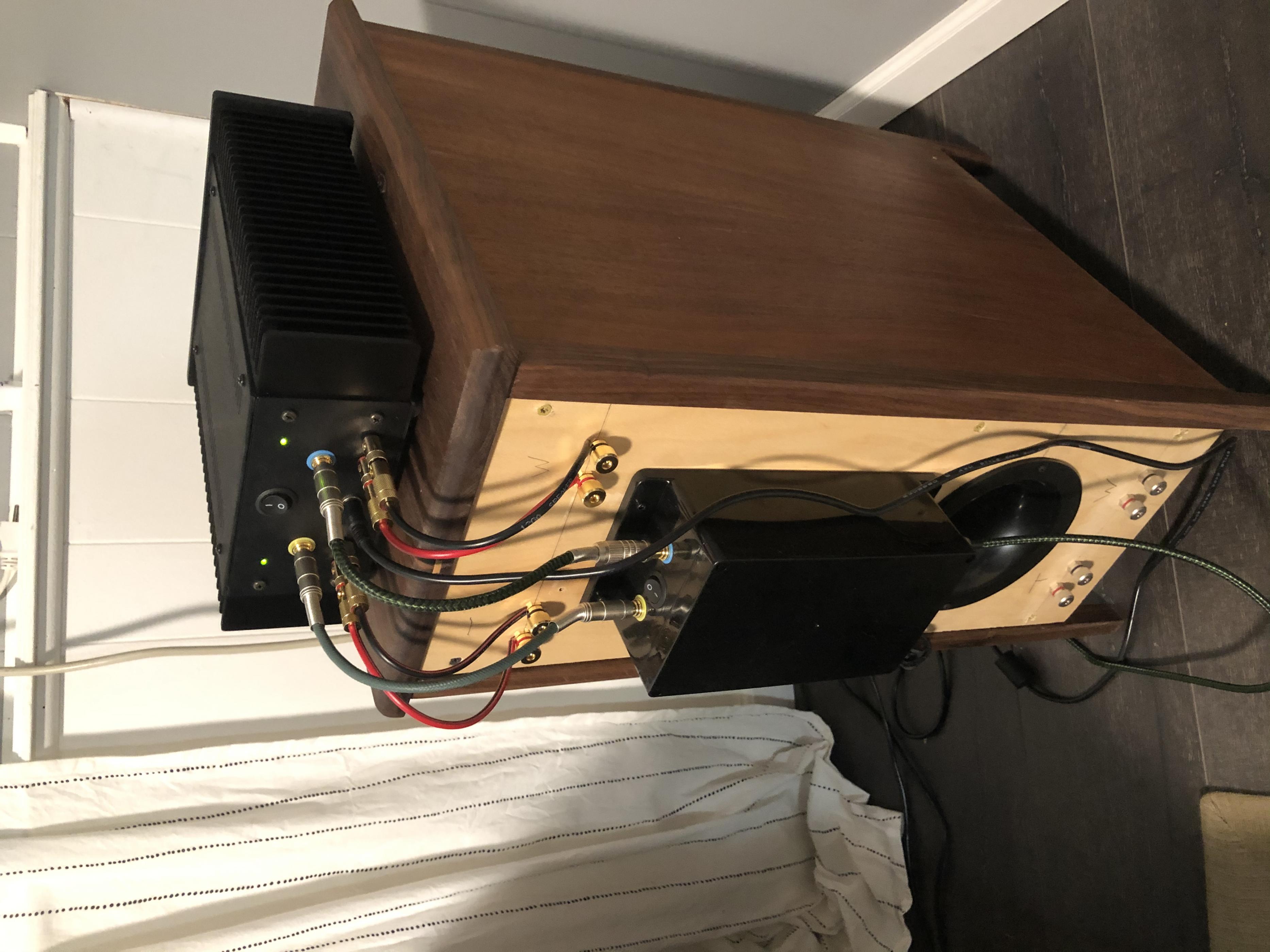

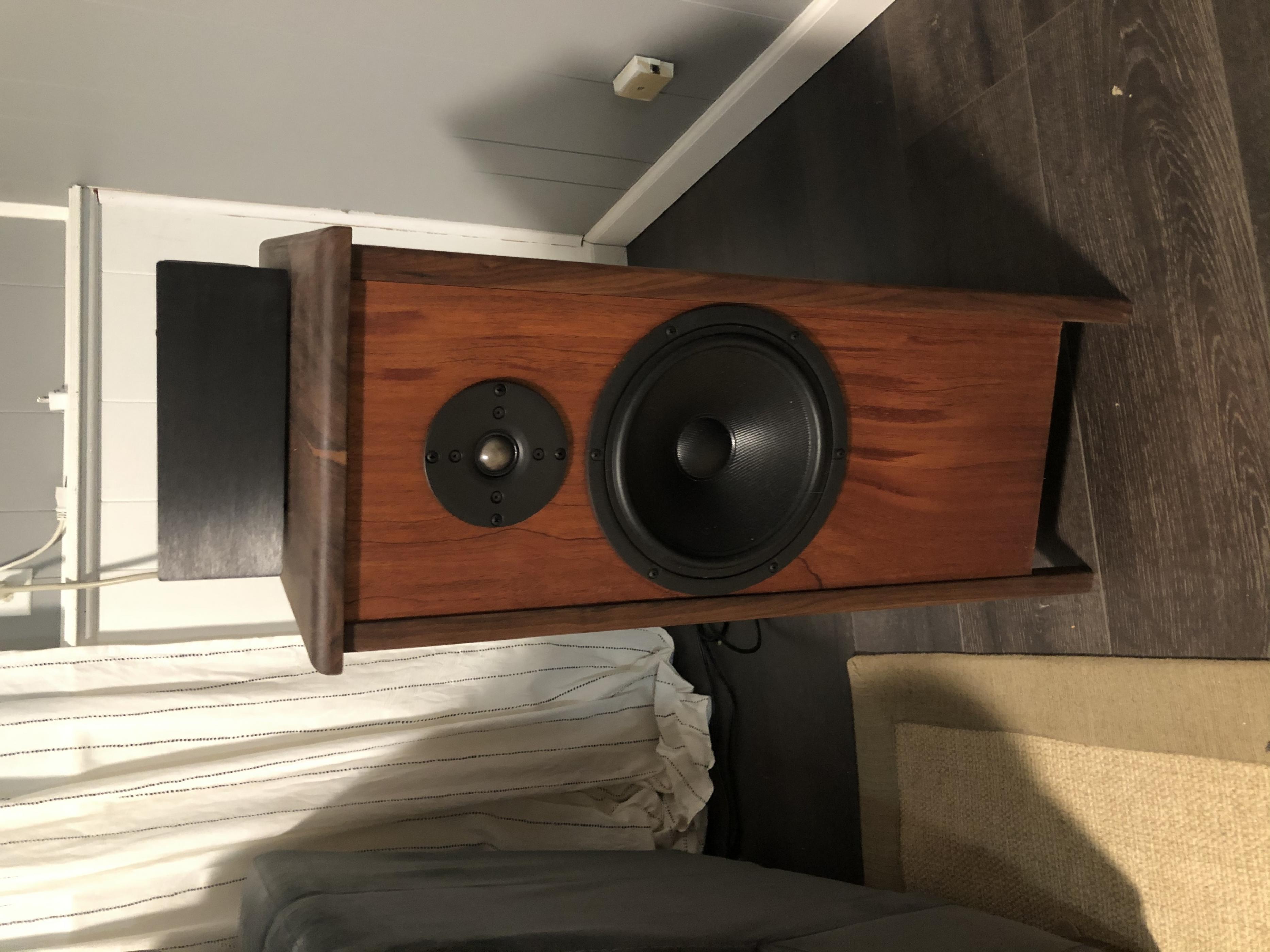

Sharing my bi-amp build
I decided to run each speaker driver with its own ACA to see what would happen. I’m so impressed. How fun! Sounds fantastic!
The build: The only piece I didn’t DIY was the turntable.
Rega turntable to boozehound labs phono amp to (blank no pre amp yet, waiting on the Korg nutube b1) to boozhound labs active crossover to the ACA with one side driving the woofer and the other driving the tweeter. I built the speakers too - scanspeak drivers, mahogany and walnut case. Sized and ported to spec.
I wonder what it will sound like once the korg is in the line. It sounds so great I hate to put it in. But, it will be nice to have volume control, and another input channel.
