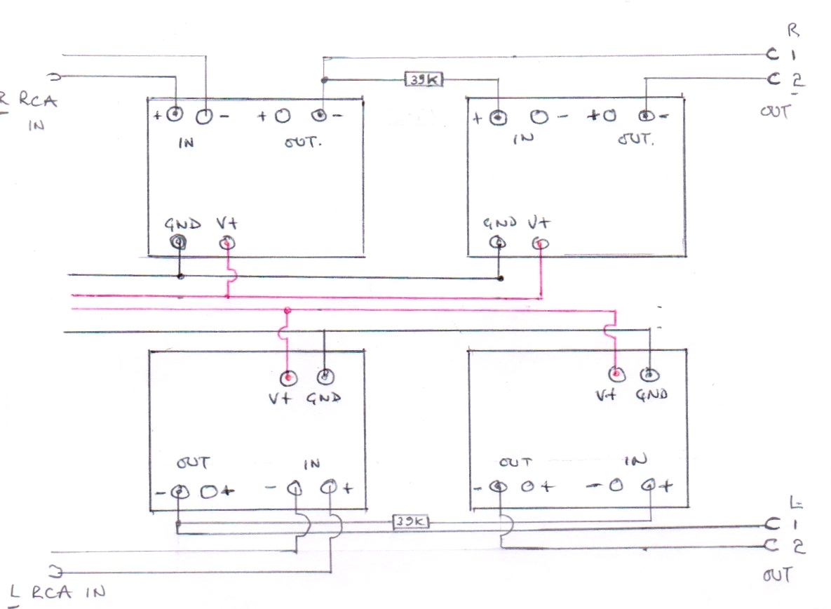

Although you're putting all four channels in the same box, it's essentially the same as building two stereo amplifiers along with the ability to run them as bridged monoblocks.
Read the guides linked below all the way through. Focus on steps 46 onward in the second link. Come back with specific questions. If you're not using store boards / a kit, then post your schematic and pictures of your build.

Are you using XLR (balanced input) or RCA type input?
Amp Camp Amp V1.6 Build Guide - diyAudio Guides
Amp Camp Amp V1.5 Build Guide - diyAudio Guides
Enjoy!

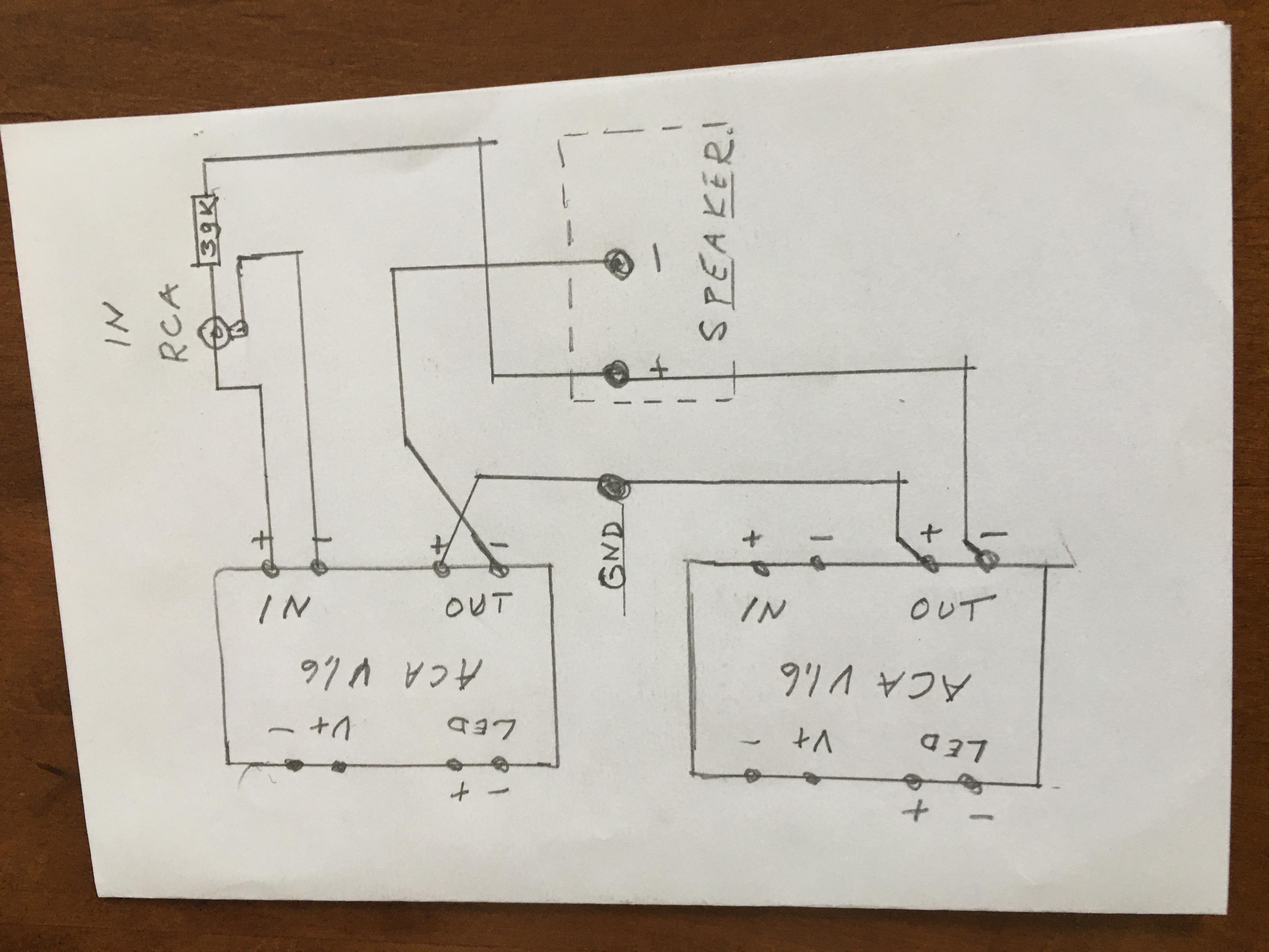

is this an installation for real ?
This is all you need. I assumed you have used ACA 1.6 boards.
Note, you use the two negative outputs (marked OUT - on the boards). In bridge mode the positive outputs are not used.
You do need to note the board which has the RCA input. I have noted it as 1 on the diagram. That is the output your Black speaker lead goes to. That way your 2 mono blocks will be in 'phase'.
I assume you can figure out the LED and power supply wiring. Just follow the build guide. Personally I would double up the supply wire thickness too.
Not quite.
The RCA input is on the board bottom right. Then it will work.
A small part of the output from the board with the RCA input is fed to the input of the other board (via the 39k resistor).
