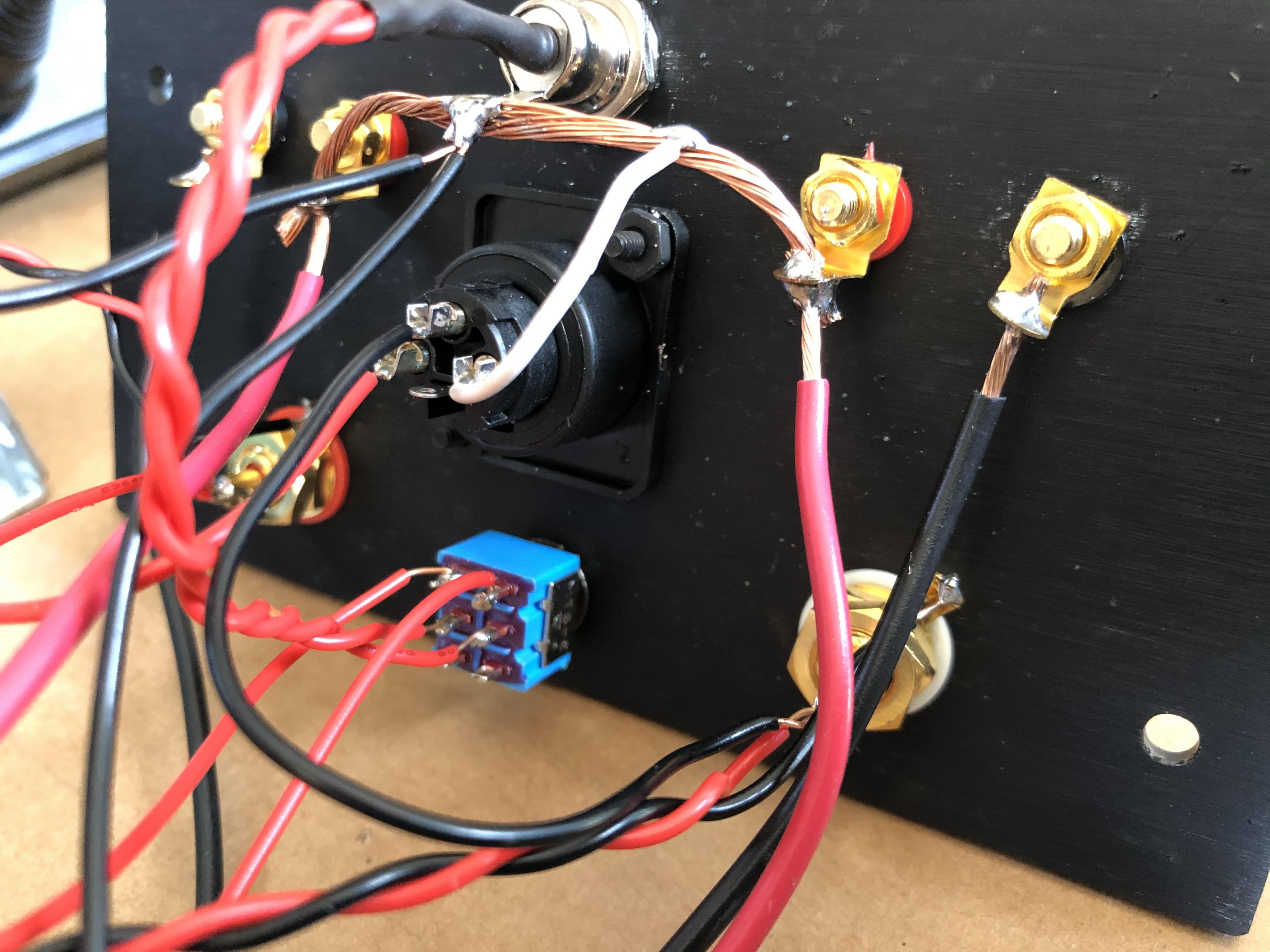

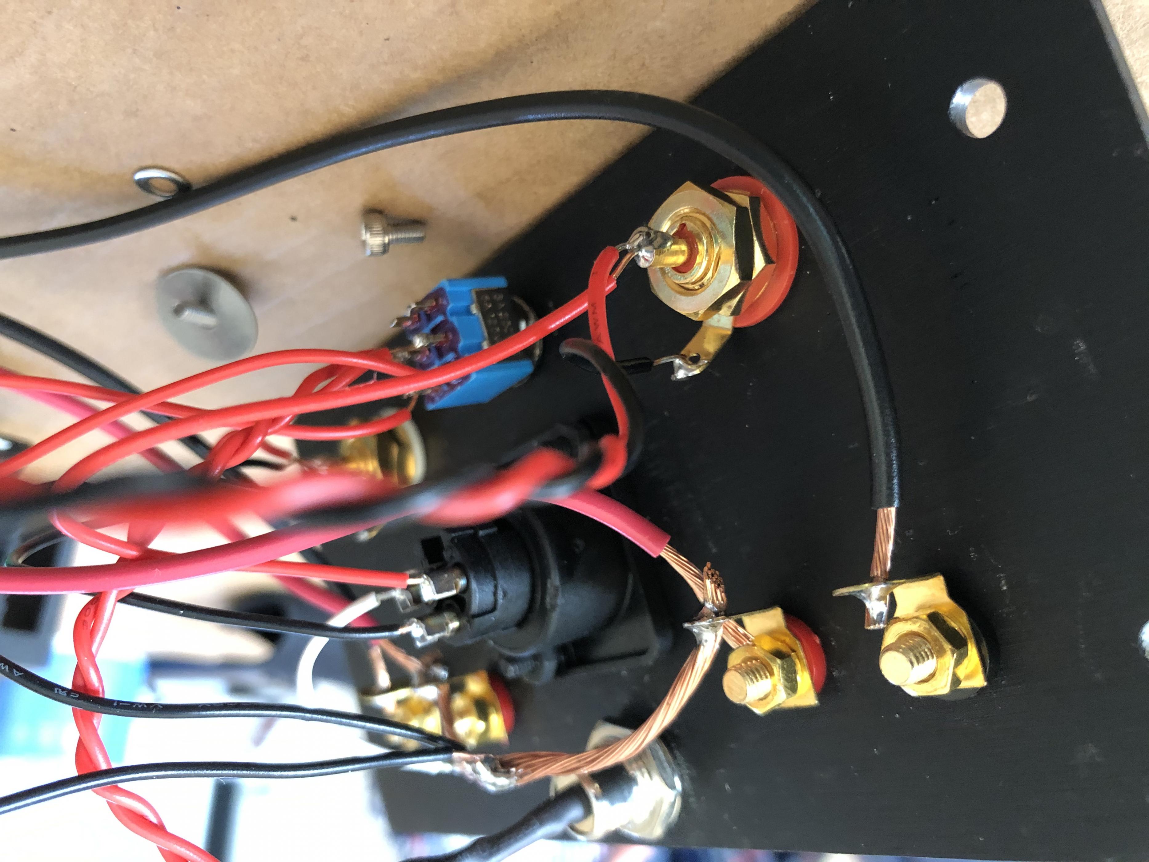

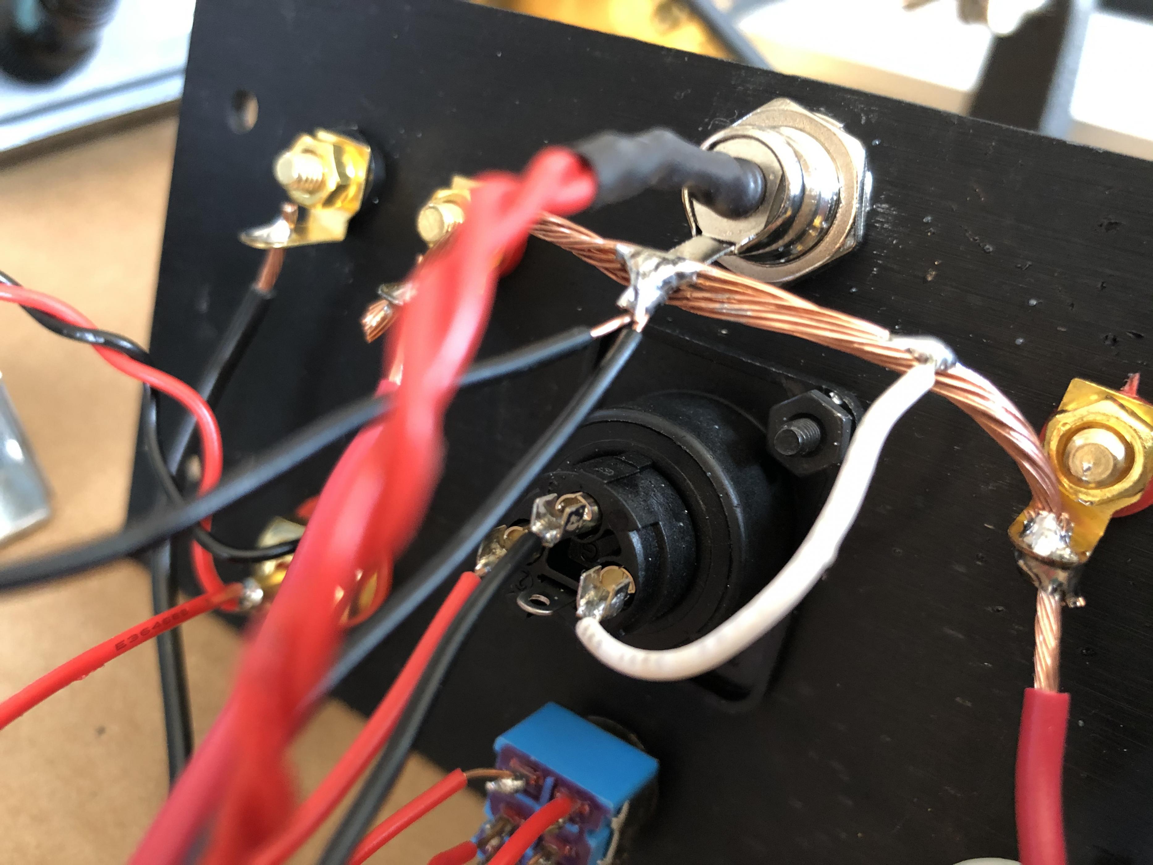

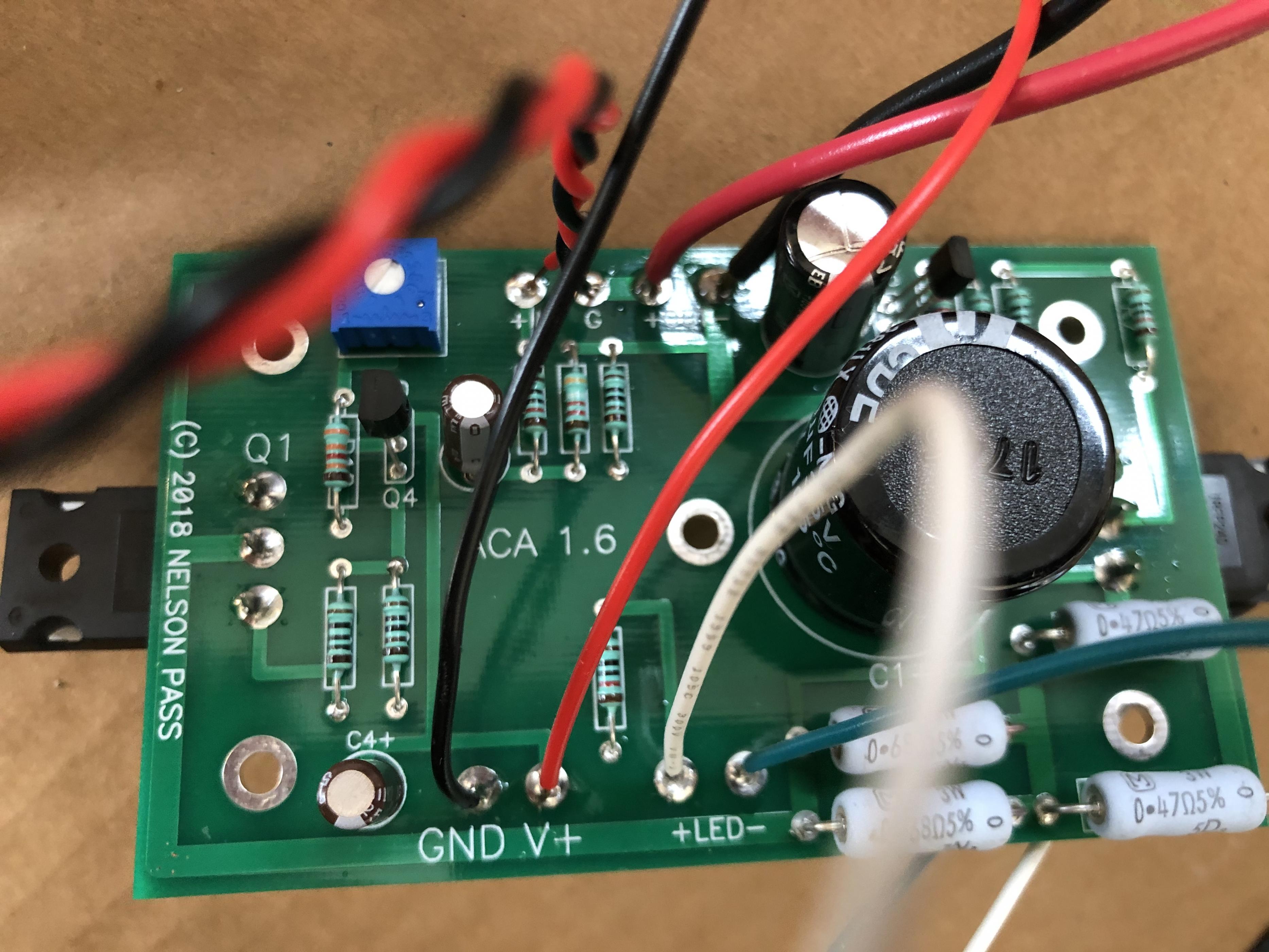

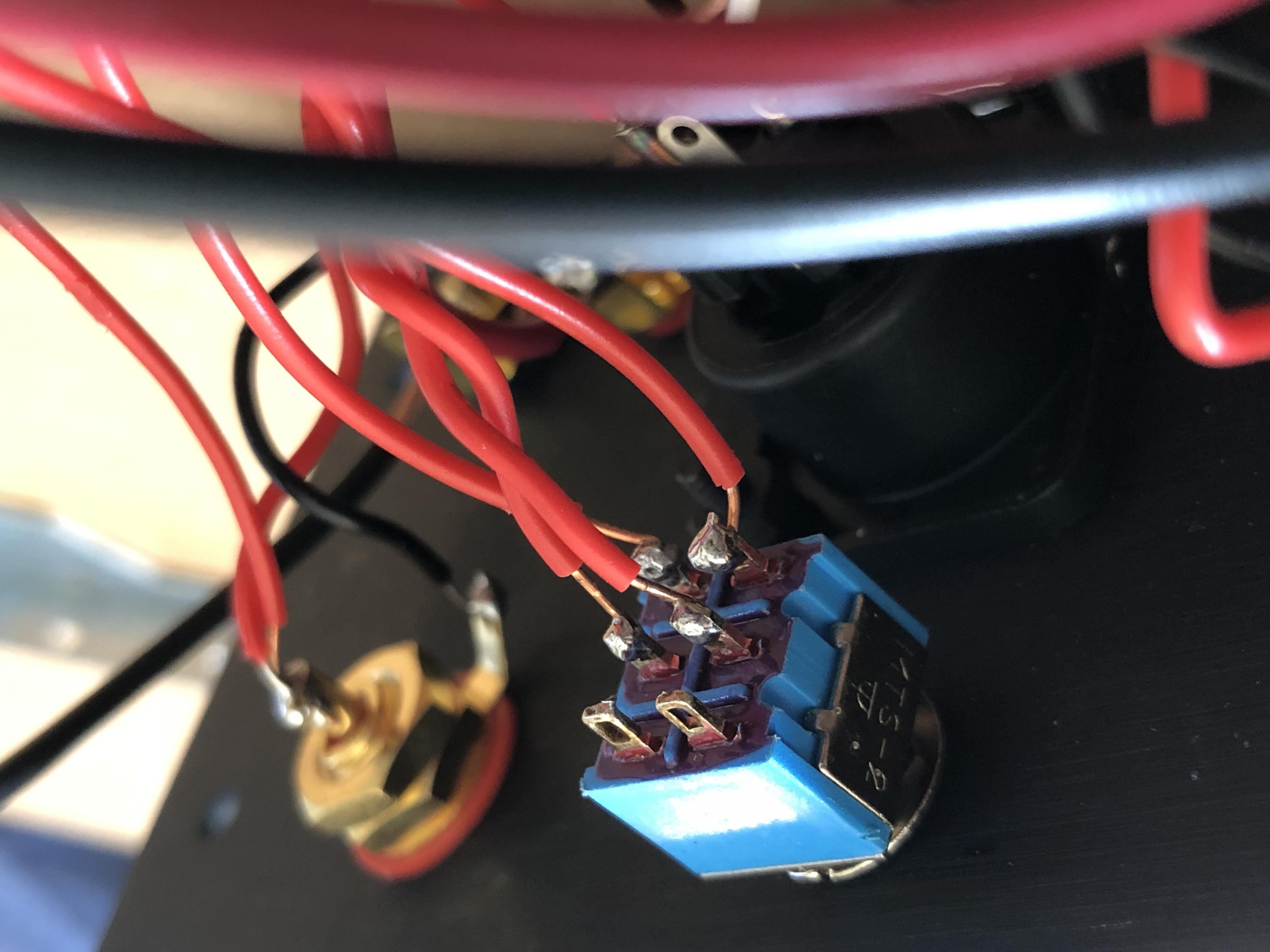

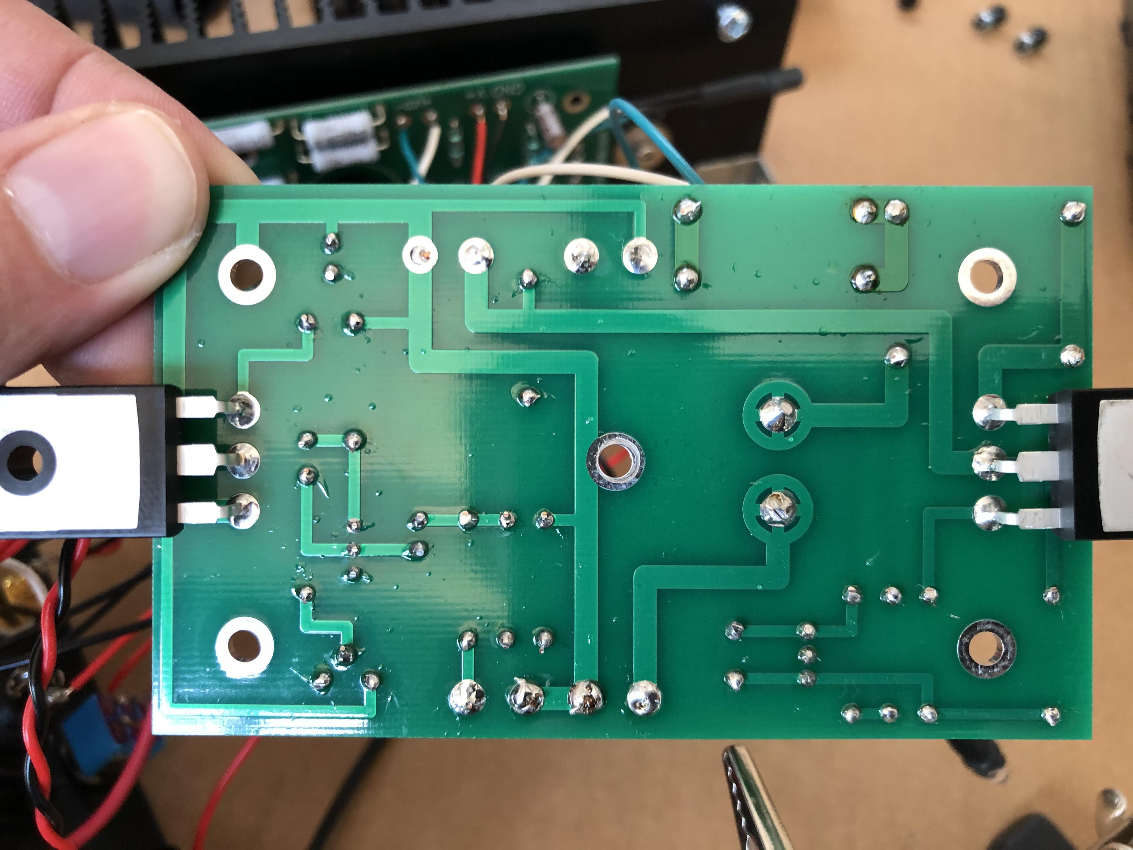

When this happened to me. I found it to be the power supply connector on the back panel. It was pretty much a low resistance connection between the center conductor and the case. Was my fault. I overheated it when I put the amp together and after a couple of weeks it failed the rest of the way.
My fix was to take the connector socket out. Cut the plug off of the supply cord and passed the lead through the hole and soldered it inside right at the switch. On my second mono block I got really fancy and put a grommet around the lead. The proper way of course is to replace the connector. But that wastes valuable listening time... : )
Hope this helps? May not be the issue at all but the symptoms are identical.
So I popped open my amp and my parts box and I had an extra power supply jack that I installed. I also tried to carefully inspect everything and cleaned up a couple of the solder joints that were maybe questionable. When I reassembled everything, I have the exact same problem as described above.

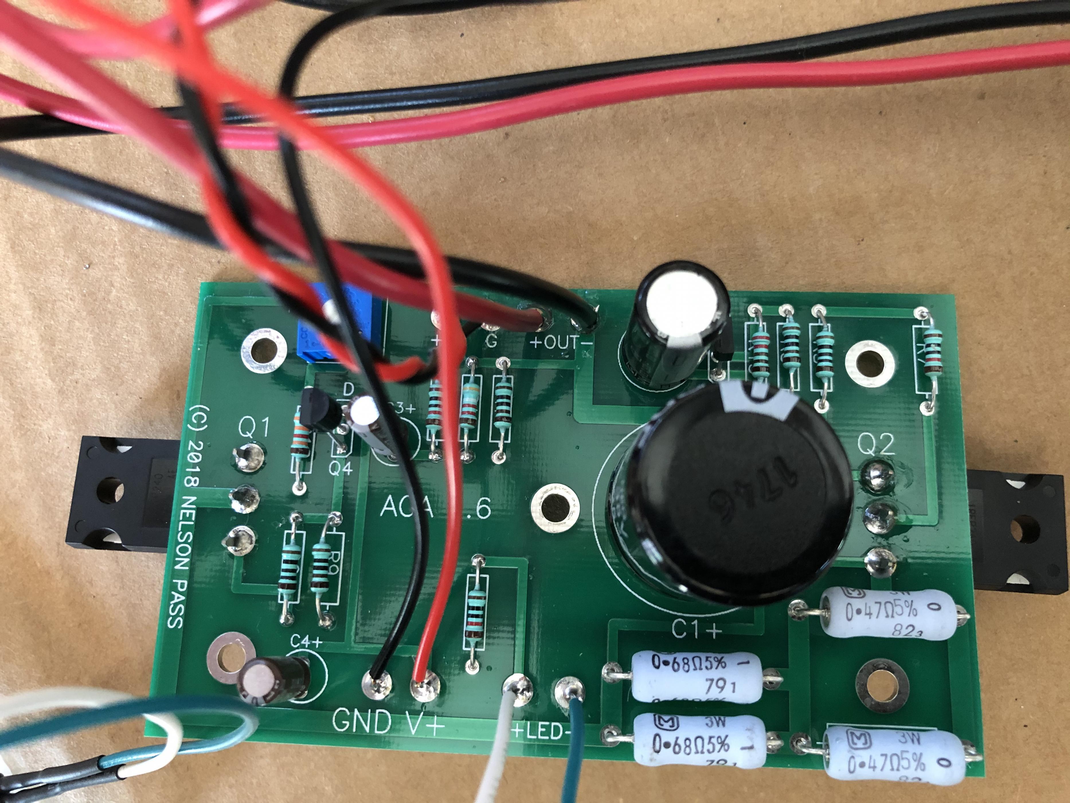

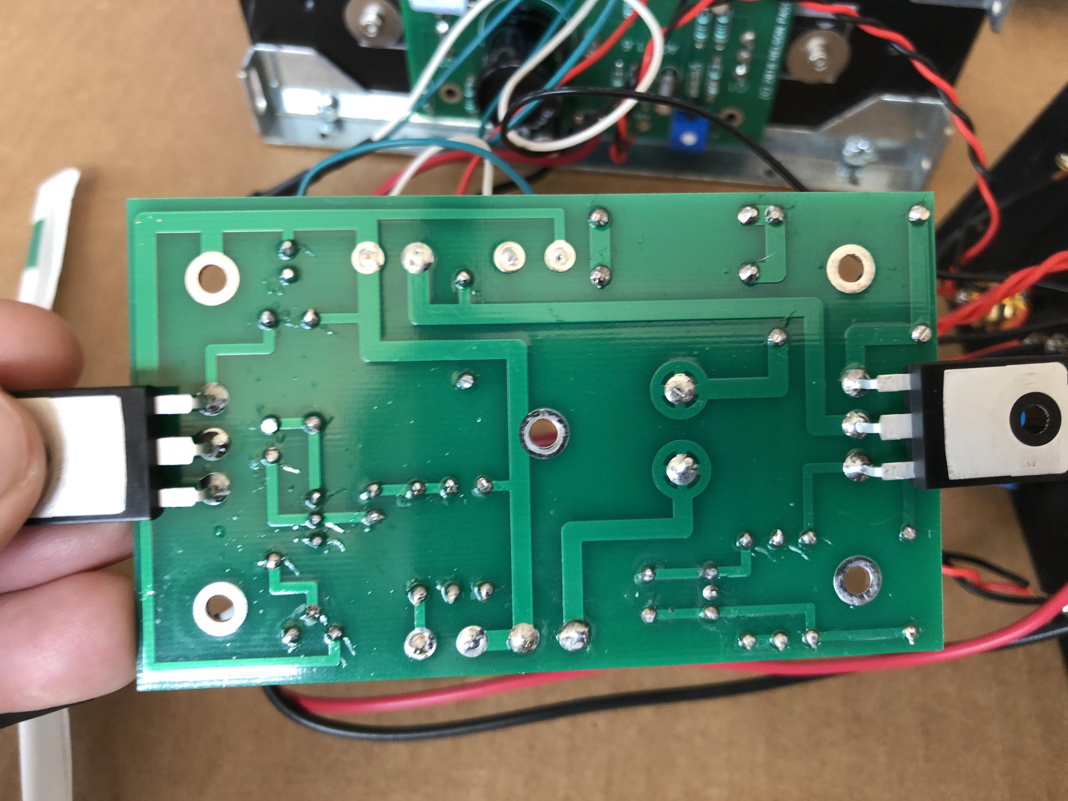

I have attached some photos in the event that someone with eagle eyes can find Waldo (or the issue). I also have a 10 second video showing how all the lights (including from the power supply unit) dim on and off.
I presume it has to be the switch? Or something on the back panel because both lights dim when the power cuts? If it was an issue with one of the boards would only one light dim?
Such a bummer because this these amps have been solid for a long time now.
Thanks for any input you can provide.
Jim.

When you lose power, is the power supply light still on?
Yes. It may be difficult to see in the video, but both LEDS on the amp and the light on the power supply dim at the same time. Note that all lights dim, but do not go out completely.
The power supply will keep a dim light for an incredible period of time after unplugging. Can you recreate this with consistency? If using a power strip, have you tried plugging in directly to outlet?
Thanks for the reply. I can’t recreate it in so much that it just keeps happening randomly, but it consistently happens within a minute or so of plugging it in. I have tried it in multiple outlets and it happens the same. Most recently, it was not hooked up to anything. Just plugged in to the outlet.
