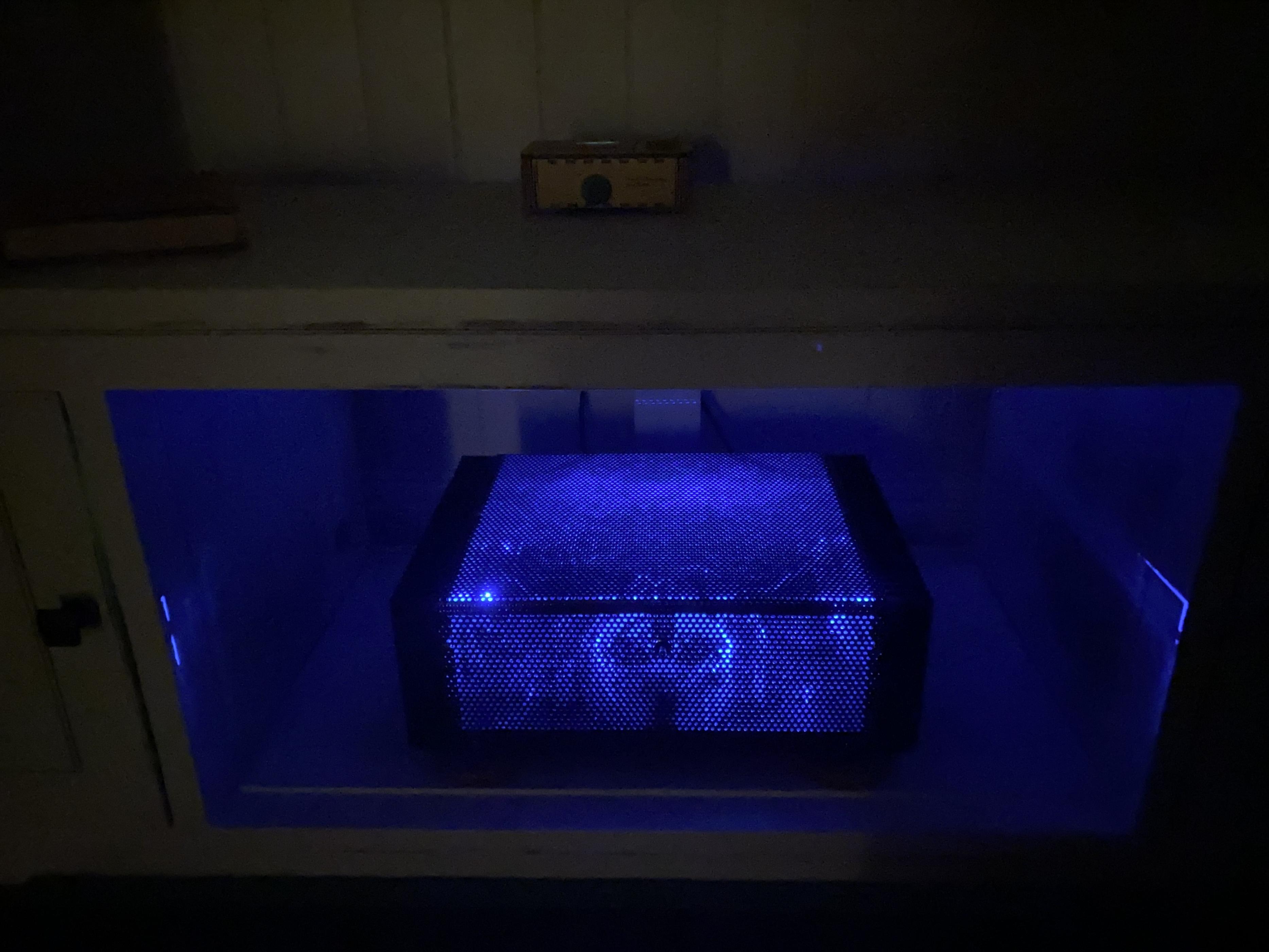

The ACA itself doesn’t vibrate, but it may be closer to the speakers than a separate preamp. It also needs ventilation and cooling slots in the top and bottom plates. The B1 Korg is best enclosed in a heavy solid aluminum chassis with no ventilation holes. It also needs to be suspended by vibration absorbing materials. I housed mine in a Naim NAC 62, powered by a separate HiCap PSU. Mine had no problems with oscillation.

ACA with Korg B1
Its not too much of a squeeze, most challenging issue is fitting the volume pot to a 10mm thick front panel. It does make a very neat integrated and I haven't experienced any heart or vibration problems. I do use separate power supplies for
the Kong and the ACA, mainly so that I can turn the ACA off and leave the Kong on constantly. In my case a single source amp is fine...tried to attach images but failed miserably. It all fits in a 2U ACA Dissipante chassis
Thanks Gary. Yes, definitely looking into that premium thread. Thanks also dweightman. I’ll probably do a very ventilated perforated enclosure like my AlephJ. Perhaps add an internal heat shield to segregate the Korg.
