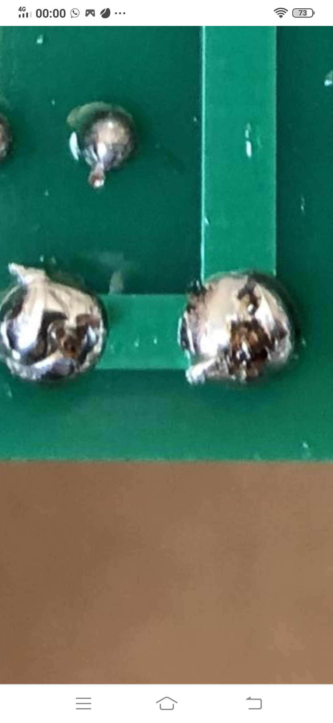

I would check for cold solder joints first.
Your PCB soldering looks OK, but still worth re-flowing all solder pads.

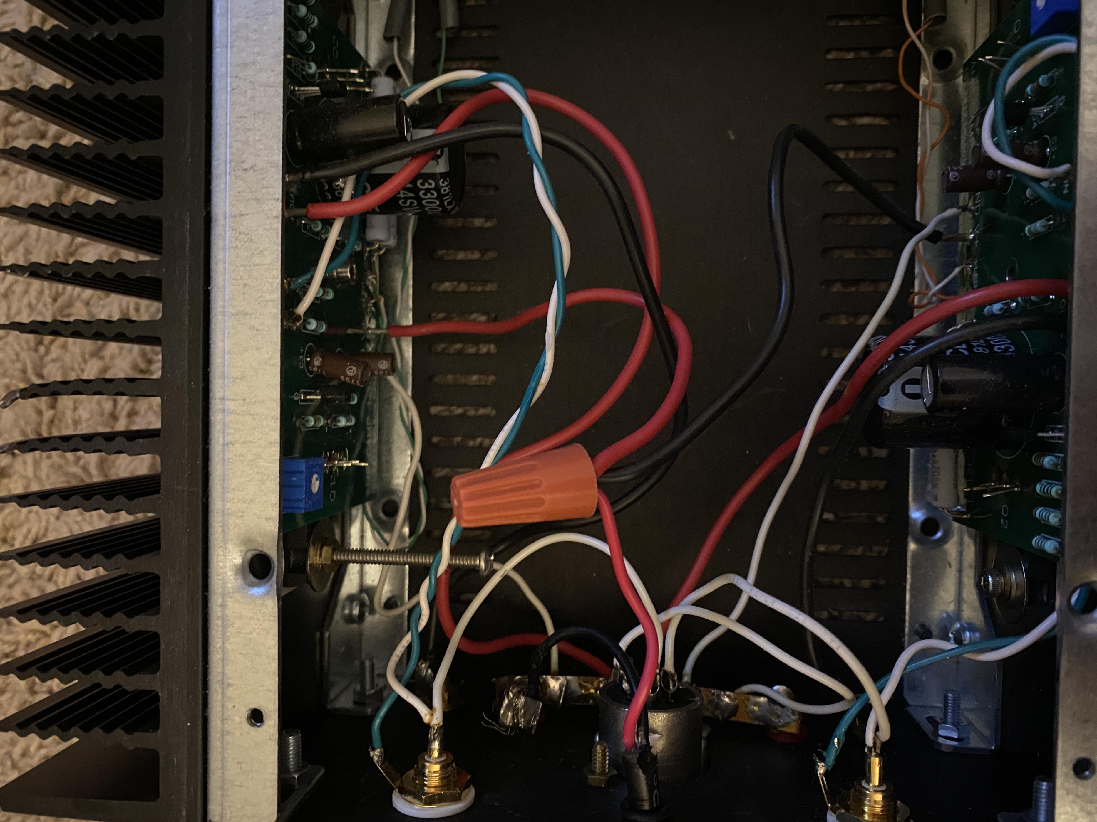

The wiring OTH at the different terminals looks a bit iffy.
Good practice is to tin the wires before soldering them to terminals.
Not saying that this is your problem, but it is the simplest thing to do at the beginning of fault finding.

Try using a magnifier from your mobile phone. To see if there is problem with the solder.
Looks a little. Lumpy the solder.. Are you using lead free?
Yeah. I know my solder work isn’t the best. And the wiring is sloppy to boot. But it seems like everything is solidly connected. When I had it all apart yesterday, I tried to touch up anywhere that seemed like a possible weak connection With more solder - hence the blobby bits.
If possible, I would try to eliminate the power supply from the equation.
Well since I have this setup as monoblocks, I have two power supplies. So I swapped them out. No issue on the other monoblock and the problem still occurs on this one.
Question 1 - Is there any truth to that this has to be something on the back panel? My logic:
A. Doesn’t appear to be the power supplies since it happens the same using two different power supplies.
B. Since the issue dims the lights on both pcbs, it’s not something just on one pcb (or I would assume one LED would dim, but not the other).
Question 2 - the switch in the back is setup up to turn the power on and off. Assuming I could just connect the wires to eliminate the question of the switch? Again, I’ve since replaced the PSU Jack, so I don’t think that’s it.

Thought: disconnect the switch output to the amps one at amps one at a time. See if one side or the other is causing the grief.

Both leads go back to the same connector. So either side can cause both to dim. Because of the common source voltage.
You can, yes. Clip across the switch.

Looks cold solder joint . Took screen shot
Alright. I connected two wires across the switch (One for each side) with the switch off and powered it up. The issue with the amp powering down still happens.
Then I disconnected one of the jump wires at a time, and each side of the amp did not blink on and off at all when only one jump wire was connected and the amp was switched off.
I had assumed that at least one side of the amp when connected this way would reproduce the issue.
Once I removed the jump wires from across the switch and powered it back up, it started to blink on and off again.

Jim perhaps your switch is somehow shorted to ground internally. It sounds like the amp boards are OK. Something that gets the voltage from the input connector on the back panel and the power input leads to each amp.
I think I uploaded a picture to show you what I did to get around the issue you describe, which is identical in nearly every way to your issue.
I eliminated everything in the path and it works great. I have mine on a switched power strip.

You can do a simple test to check the switch for a short to the chassis/case. Just undo the nut and push the switch inside. Make sure the metal toggle and frame does not touch any thing, maybe wrap a turn of tape round it. If you connect it up and the problem is gone - the switch at fault. If the problem is still there it is not the switch...
