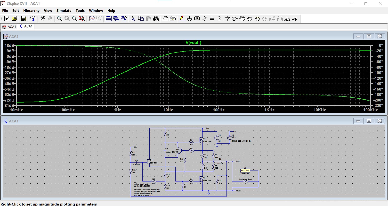

Input capacitor C3
Hello,
Maybe someone already asked this question, I was not able to find an answer however so if it's asked previously I apologize.
I was wondering if I could place a 15uf cap on C3 instead of 10uf? Currently it's stocked with an 10uf audyn cap plus (very nice cap). I came across a good deal for two 15uf jantzen silver z caps so I couldn't help but wonder if I could throw those in.
Cheerz

Simple and quick answer is 'yes'. The larger value shifts the peak in the ACA's low frequency response a little but since this is around 1Hz its way below the audio band.
Alright thank you! I've known this was the case for my gainclone lm3886. I didn't know this design however and since the positive output is connected to ground I thought I'd ask before smoke magically appears.
It won't let any magic smoke out 🙂

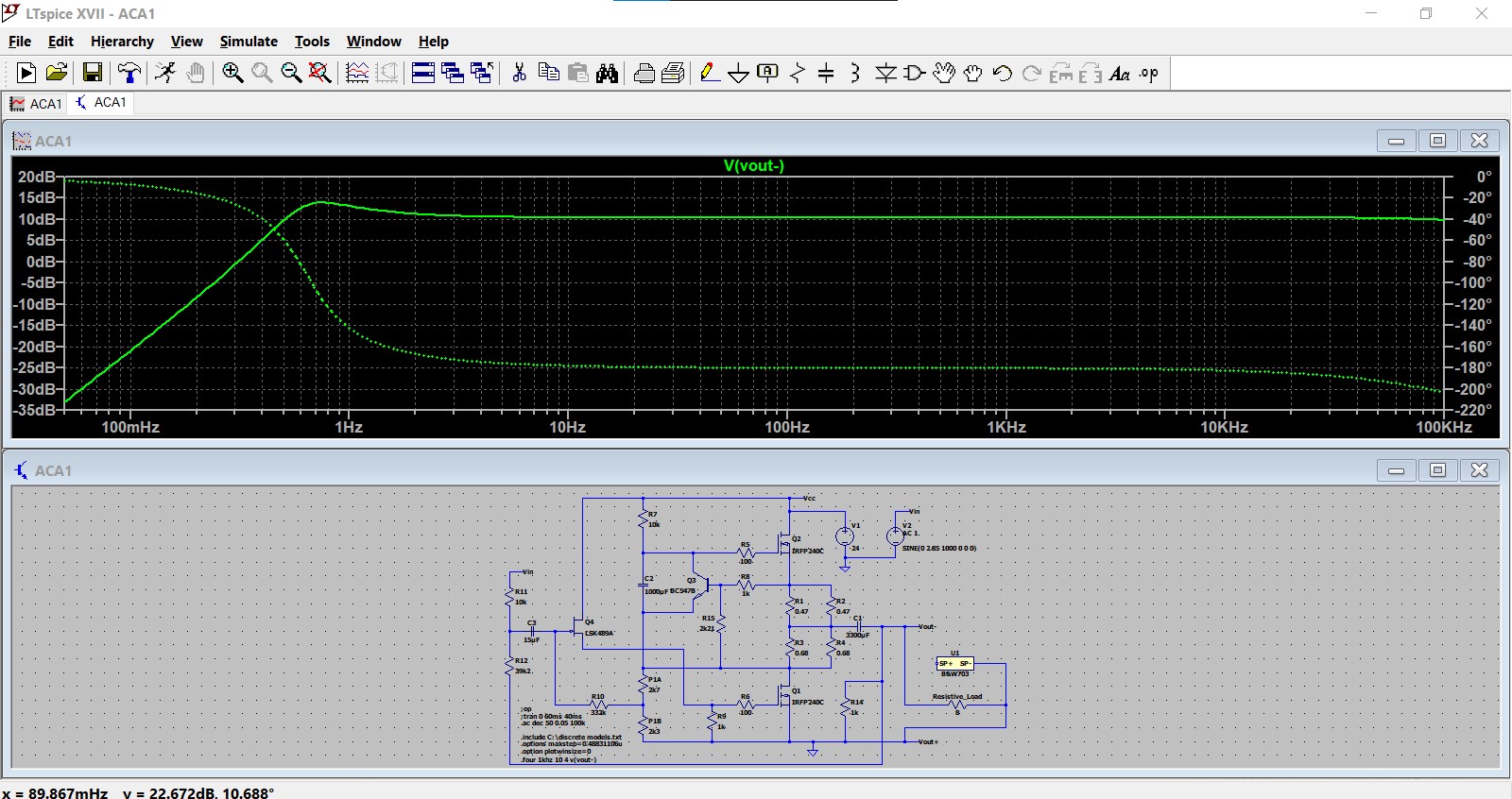

The peak in the response is caused by the two time constants of input AC coupling and AC speaker coupling. This shows 10 and 15uF for comparison.
I see. Thanks for making things visual. The graph however suggests that since the rolloff is so low in the audio band that C3 can be much lower to obtain for example a roll off at let's say 10Hz. This makes me wonder why Nelson choose the 10uf value
I would like to think it's because its the most suitable vs cost effective part for the job 🙂
Physically large parts like caps have a much greater chance of pickup of stray radiated noise and hash, particularly when used in high impedance locations such as C3 here. This is a 0.047uF cap
If you go smaller in value then you push the point at which the input vs output phase difference becomes a factor (the dotted line). It is 180 degrees (right hand scale) out of phase over the audio band because the amp inverts.
At low frequency the phase shift increases.
This amp behaves differently to most because the AC feedback is taken from after the speaker coupling cap. So the amp tries to increase the output voltage (before the cap) to compensate as frequency falls. That means a small value cap would increase the probability of clipping at LF.
