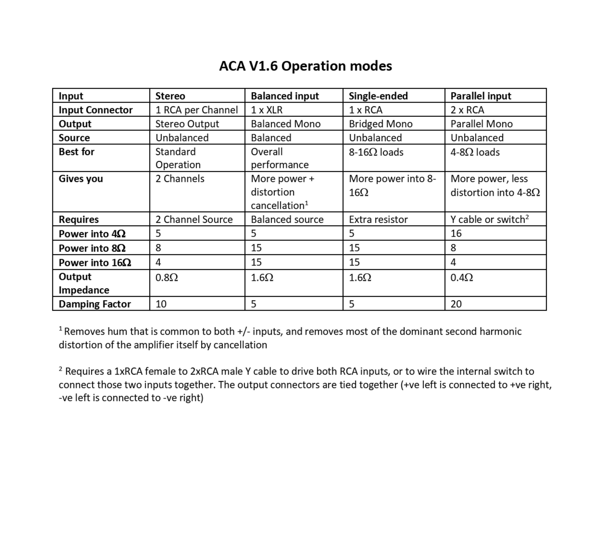

What is the power output of a parallel 24V ACA into 4 ohms?
Try this.

So then educate me on something I've never understood about SE amp specs.
Tor the ACA stereo version the power into 8 ohms is 8 watts. The power into 4 ohms is 5 watts.
I would expect the power into 4 ohms to be exactly half what it is for 8 ohms.
In every SE amp spec I've seen the power into 4 ohms is always a bit more than half what it is into 8 ohms.
Why is that? How is the power into 4 ohms and 8 ohms calculated for an SE amp?

Without going into specifics and using vernacular vs. engineering terms, I think it depends on whether the limitation to the max power is available current or the max voltage at clipping into the load. There's probably more to it though.
If you are current limited, you'll have lower maximum rated power into the lower impedance load.
What current would be necessary to be able to drive a 4 ohm load to clipping at 32V? What would the total power output be? How about for an 8 ohm load?
What if my amp only had 1A0 of current available until I reached temp limits or some other design limit (bias current)?
SE is (generally) current limited / heat limited - thus you may see lower max power ratings into lower impedance loads. However, some amps have oodles of output devices, big ol' honkin' heatsinks, or use other methods and will drive either a 4 or 8 ohm load to clipping at the same voltage. If you're seeing amps that show that they're stable and have increased max power output down to 2 ohm loads, you've likely got a beast on your hands.
At least I think that's the basic concept. Others far more knowledgeable can fill in some blanks as needed.

class A SE amps have efficiencies in the 25 to 50% of input power, this is one way to look at it, with tubes, it is even less if you consider total efficiencies.....that is from wall to speakers...
Nelson, you numbers don't seem to agree with the graph I posted in post 6200 of this thread.
Single channel:
8 Ohms 1KHz 7W at 1%.
4 Ohms 1KHz 10W at 3%.
For Balanced drive at 8 Ohm 1KHz I got 20W @ 3%, 12W @ 1%.
For SE drive Bridge at 8 Ohm 1KHz I got 20W at 4%, 6W @ 1%.
I simply measured the unit that Variac brought up here. Since your
numbers are better, I will be happy to use yours.
