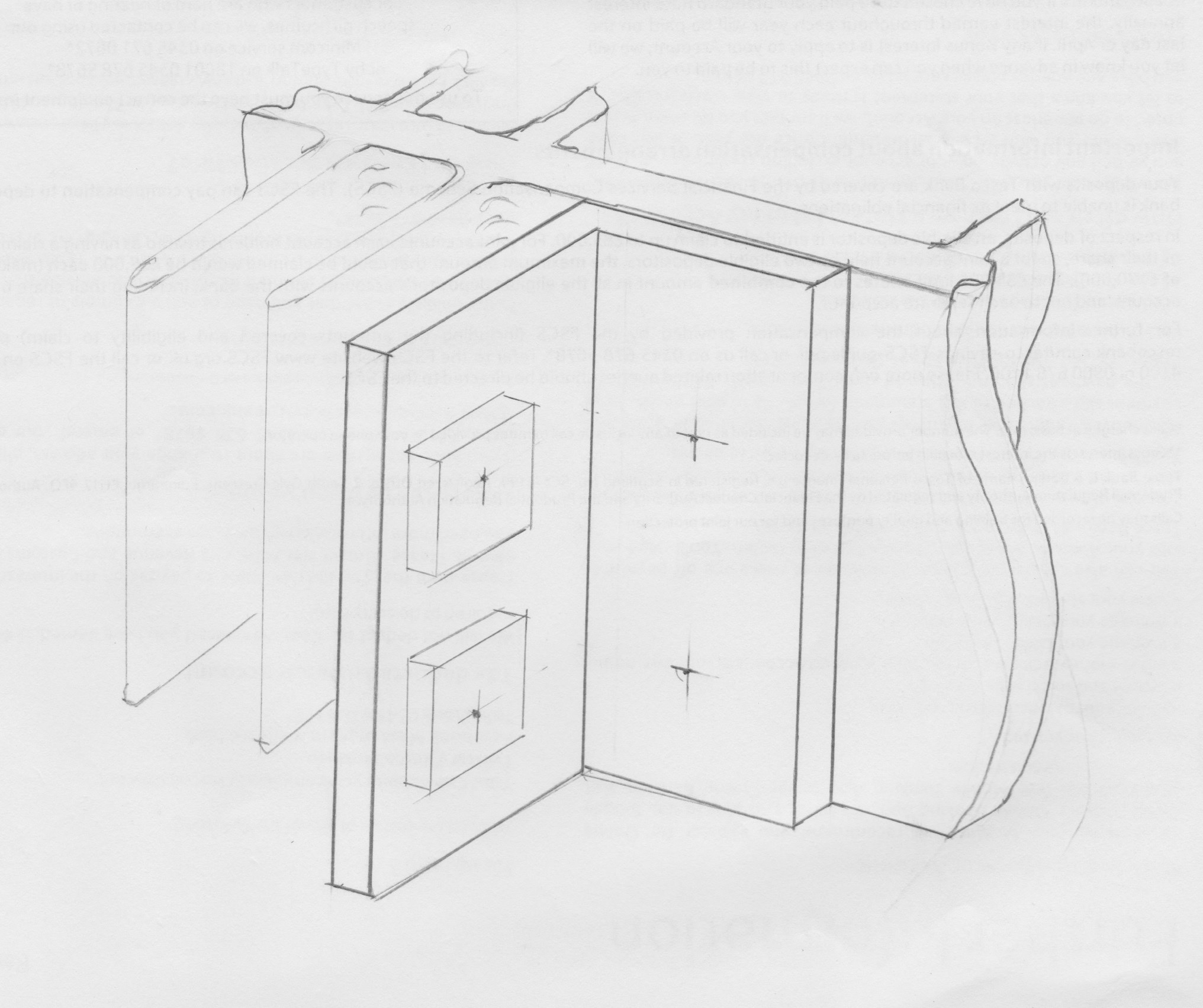

You could use some thick aluminium 'angle' and use the existing heat sink holes to mount it. Then you can fit the FETs and board to the other angle. Choose the best fit for the boards from there?

Very nice drawing Alan!
The aluminum L-bracket is a nice solution and should be easy to find world wide.
I think 5mm+ thinkness should do.

I used 50x50x5mm as can be estimated in the picture, 2 amplifier modules (roughly 40W dissipation each) per Heatsink is too much in my case... 1/ amp would be perfect.

Thanks so much friends! Particularly Alan4411. Your solution really appeals to me in a lot of key aspects: simplicity, local availability, better distribution of components, avoid soldering cables to the MOSFETs, allowing the so-much-needed 3rd anchor point.
I went shopping today (took 3 days off work to do all the mechanical work for the ACA! 🙂 ) and have secured all the parts for the chassis.
I was able to find a 3.2mm thick aluminum L, just as in your drawing. 5mm was not an option.
Still, I think it may work out nicely... I had to widen a bit my design since both cards would collide with my previous target width, but its not much of a concern.
