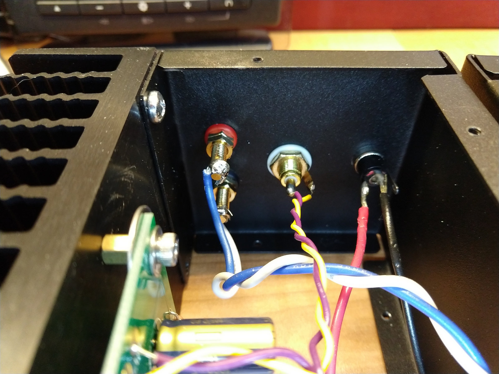

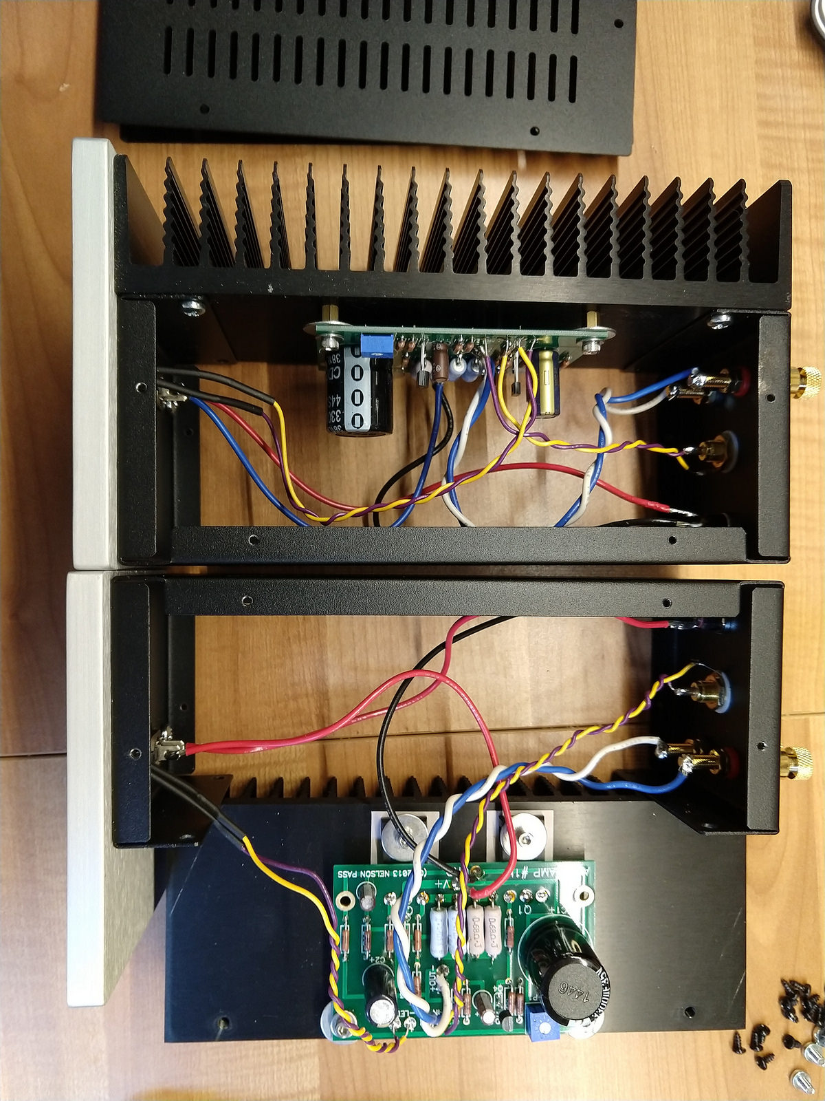

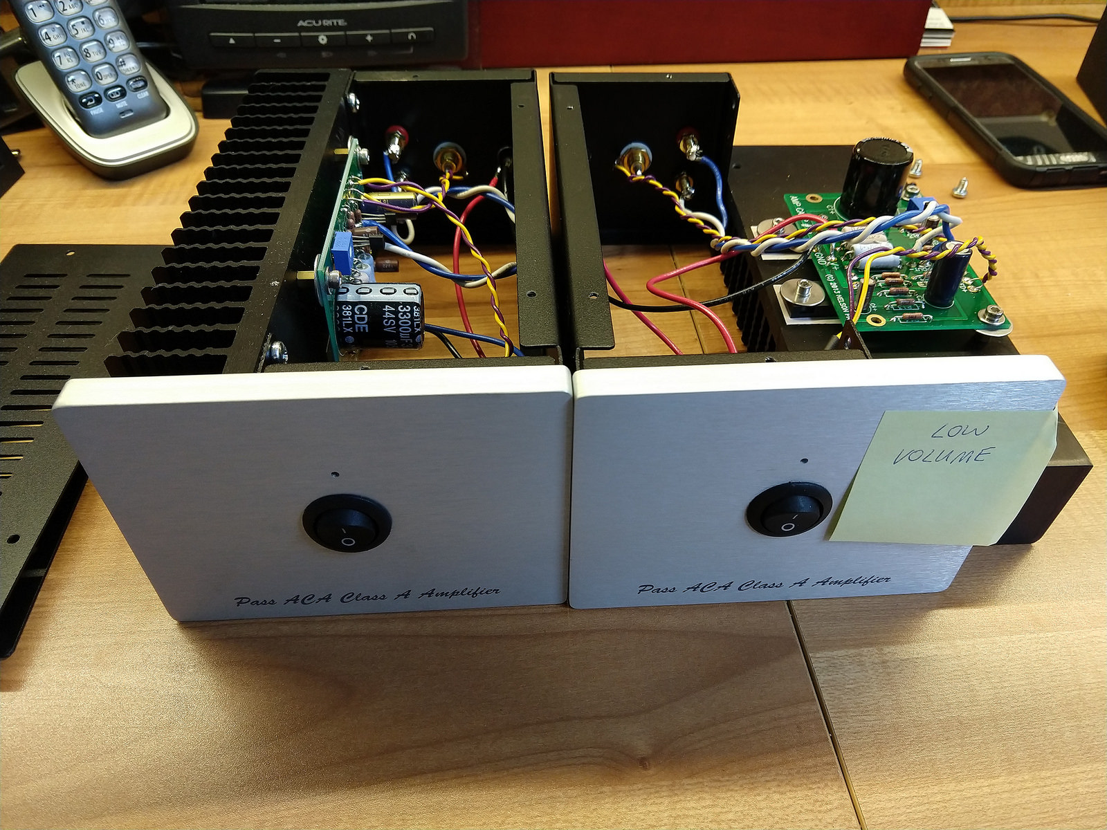

overall pic of entire unit.

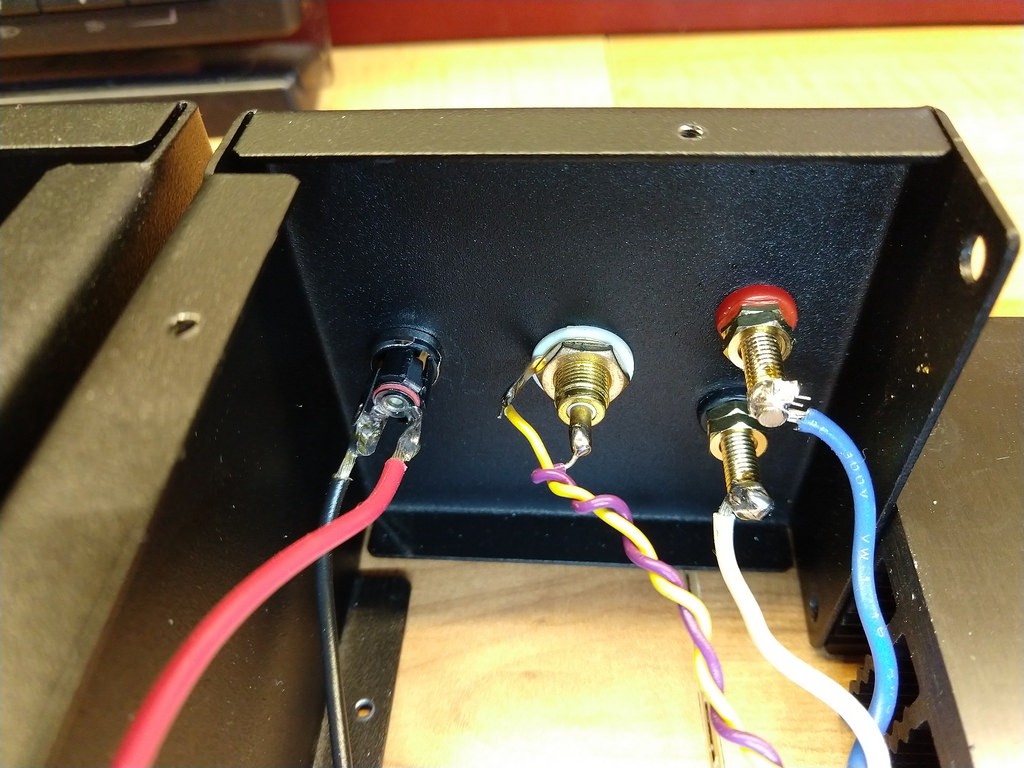

pic of inside back panel.

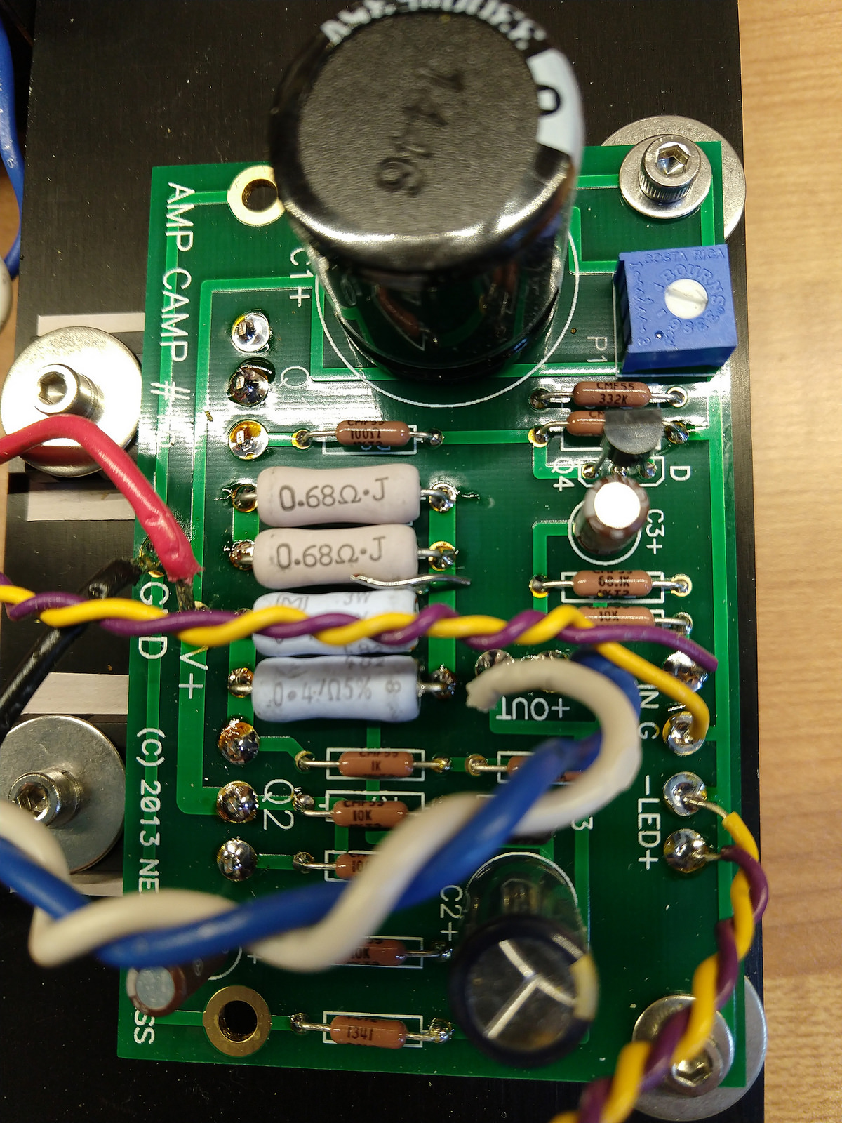

pic of left channel.
pic of right channel.

Three photos attached, have a peek. 2 more in a post following.

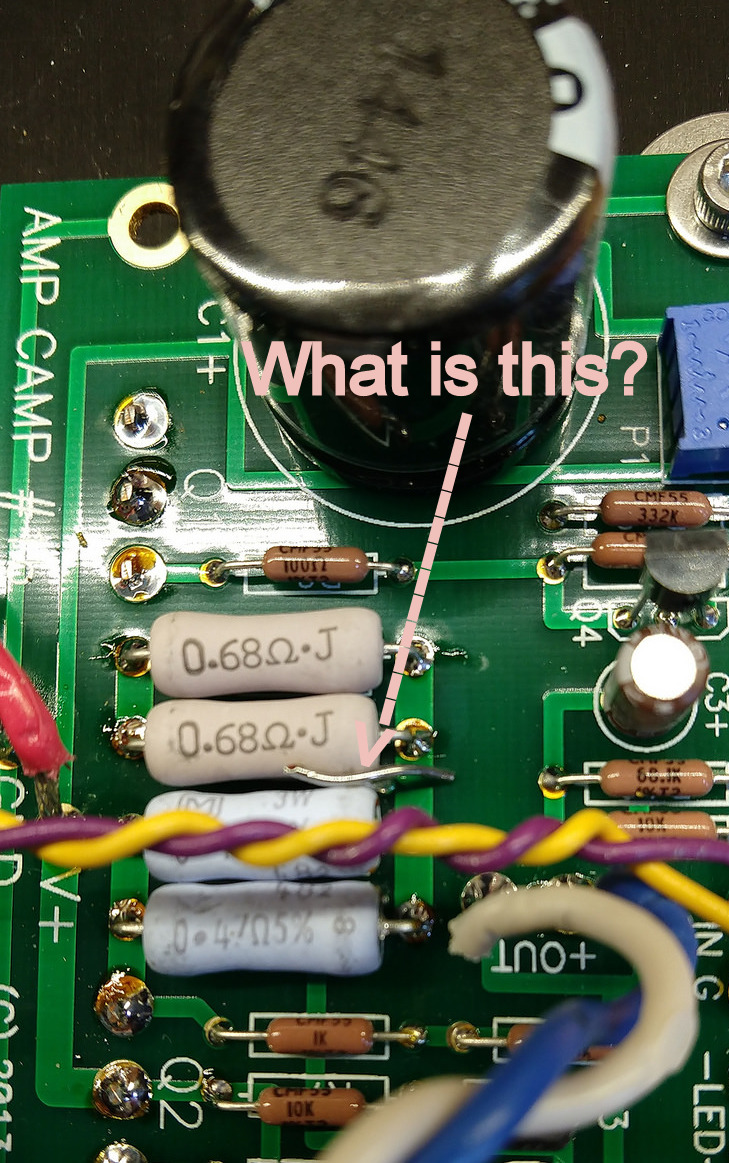

There is a foreign object in there.
Get it out before going any further...
Good luck, Alan
I'll be danged and hanged, you are correct. I never even noticed. It appears to be a little bit of unused solder. Probably been there since it was built, because these things have not been opened up since building and testing.
Thanks, Alan! I'll keep you guys posted on how it goes.
Foreign object is removed. No change in performance. Still low volume, but no audible distortion. I cranked the volume to max and could not detect distortion.
On my ACA amp the RCA is a little loose. I will occasionally get lower than normal volume out of it, especially if I had been messing around with the cables behind it. My RCA is a little loose and I can get full volume back by jiggling the cable and RCA jack. I would check that and the binding posts first before looking at the board.

^^ ... and are the two large IRFP240 Mosfets (Q1 and Q2 under the big washers) both as hot as each other? Try from cold and compare with the good side.

I modified my previous post after I reread your first post to comment on the connectors. I was having a similar sound issue that I traced down to a loose connection with the RCA connector.
The RCA connectors can be a little tricky to fasten to get a good GND connection. It would be better with a type which has a hex-shape (instead of round) so you can get some pressure on the GND solder connection. There are also types like these:
CMC(R)-Charming Music Conductor.
where you solder direct on the "frame" (nice stuff). So no chance for a bad GND connection.

Some of that soldering looks a little sketchy - you could try a solder reflow job, touching each point with an iron until everything looks smooth.
If that doesn't work - since you have a working amp and a non-working, I would take DC measurements with your DMM at various point in the circuit and compare the good versus the bad. This is, of course, with the power on. Be careful not to short anything out, etc with the test probes.
Also check the ohms - power off - of R11 and R12 the feedback resistors. Make sure they match the circuit.
