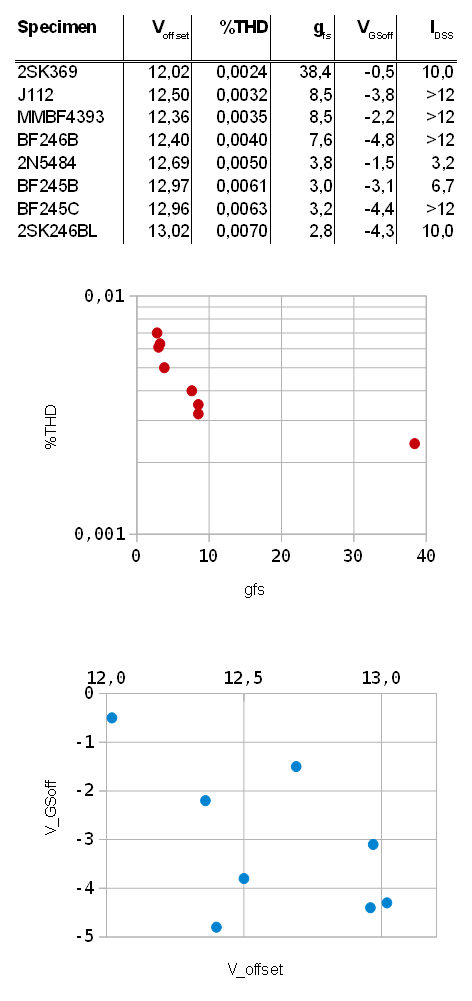

I ran a first test with all the working JFETs on an unloaded ACA. It was connected directly between soundcard output and soundcard input, with no additional load on the output. Input level was -26dBFS, which translates to roughly 0.105VRMS, yielding around -3dBV at the output.
Power supply voltage was 20.75V, and the offset of the amp was adjusted for lowest THD reading for every individual JFET.
From the data above you can clearly state that the higher the transconductance of the JFET, the lower the THD.
Not as clear, but with a visible tendency, I would also state that the smaller the VGSoff of the JFET, the closer you can trim the offset voltage to half the supply voltage. This is important to maximize output swing in both directions.
So it looks like the 2SK369 is clearly the best performing part for the ACA, with the original 2SK170 being pretty close, I suppose. The MMBF4393 would be the runner-up (J112 too, with lowest possible VGSoff) and a cheap replacement. I got mine for 1/3rd of the price of the 2SK369.

Maybe I'm being thick, but where is the original 2SK170 in that chart?

It's not there because I don't own any 2SK170 and thus couldn't test it. The 2SK369 is basically the same as the 2SK170, but with double transconductance.
