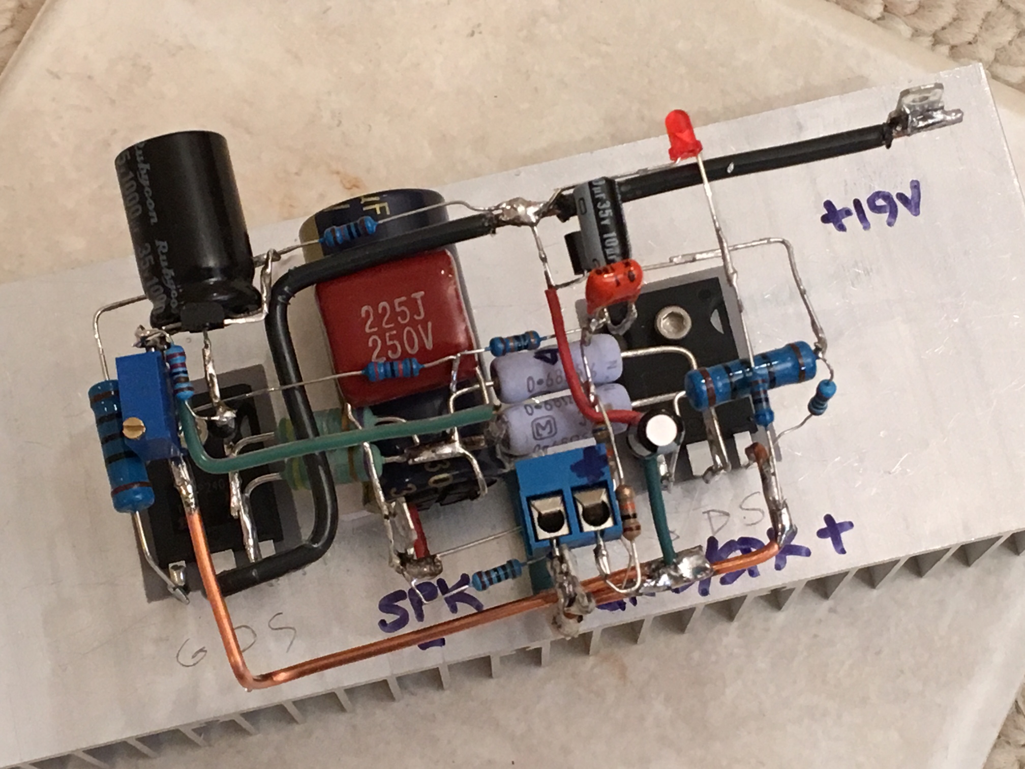

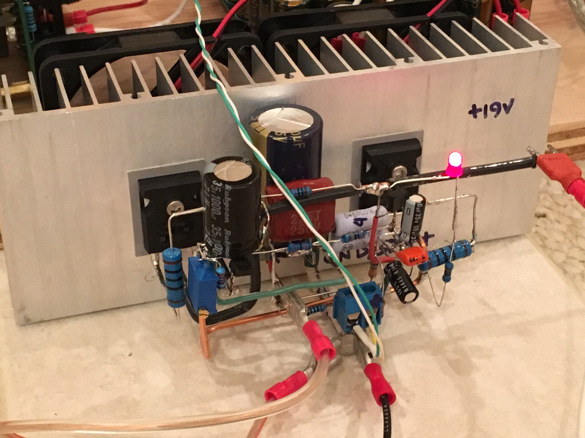

My Deadbug ACA
Threw this together and it is singing right now. It is running hot though so need to double check values. I measure 1.9v across the resistor network or 3.3amps quiescent current (that's too much right?). This is with the 2.2k resistor mod between E & C of the ZTX450. I adjusted Vd of Q1 to be 10.0v. I must have a resistor value incorrect somewhere.
Playing music:
Edit: I think I found the mistake: emitter of Q3 connected to middle of resistor network, when should be drain of Q1.
Yep, fixed it. 0.83v across the resistors for 1.43amps. Much cooler.

Mikegranger,
I like this for a prototyping style. I may use for a mono f5 prototype, 1 output transistor per side. It is easy to get too precious then be afraid to experiment!
Niceonecyril
Thanks Niceonecyril , wrk971, and all who commented. I was surprised how sturdy this little assembly is. Someday I may get around to wrapping some metal around the middle to make it look finished. I also utilize plywood as a base in many of my prototypes. It is a great material. Variac I was thinking also that these dead bug circuits have an artistic quality when done well. I love the three dimensionality.
