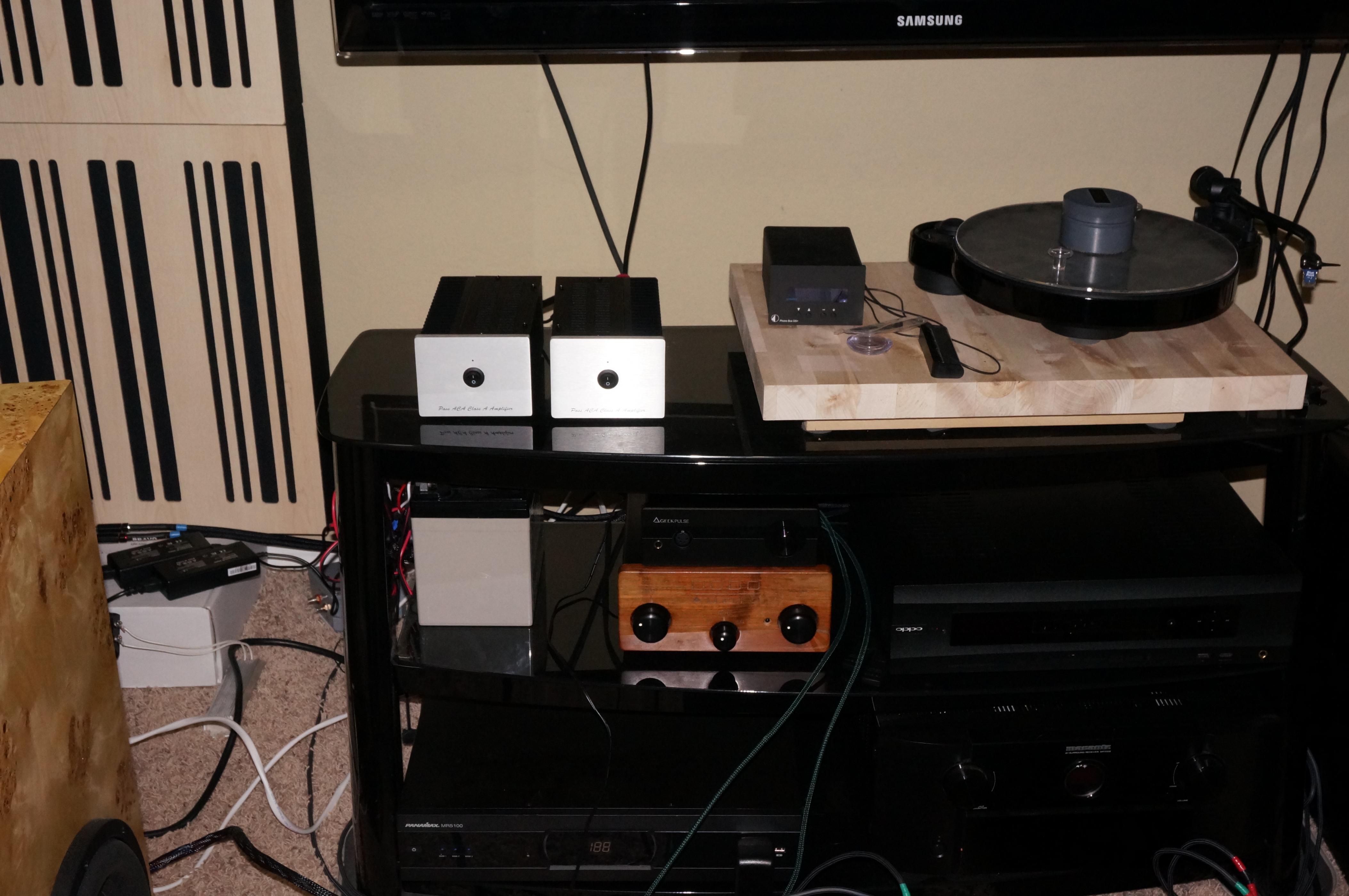

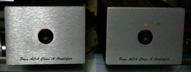

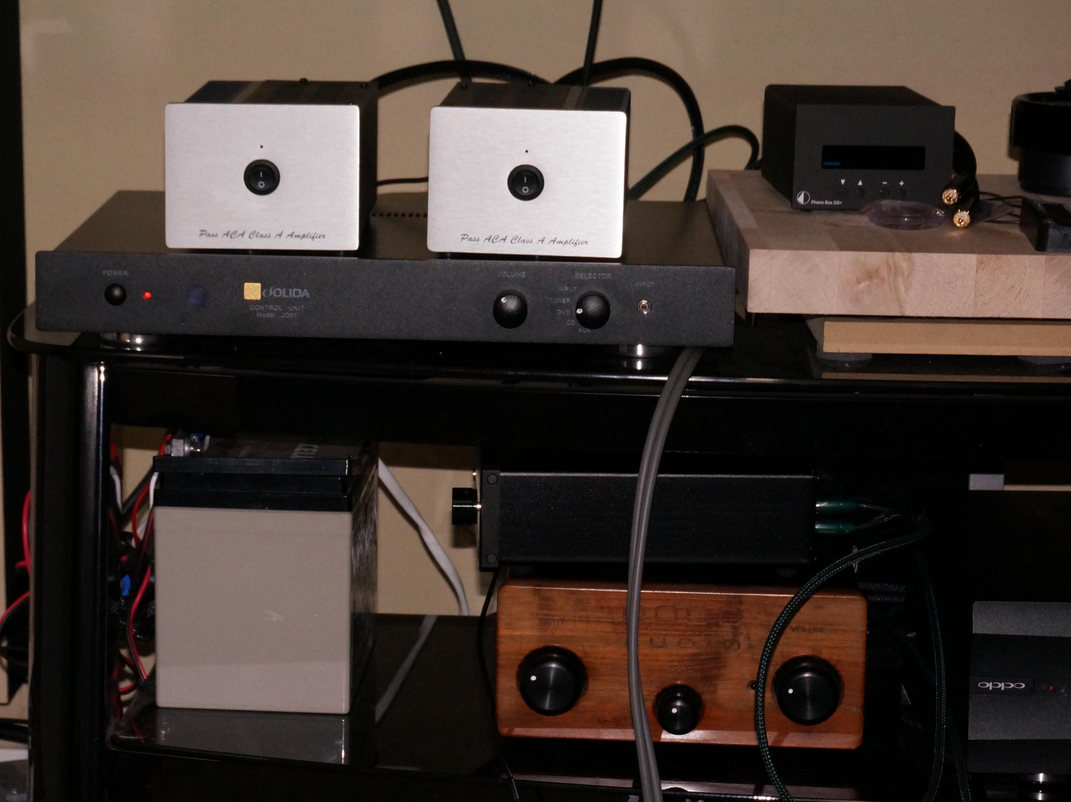

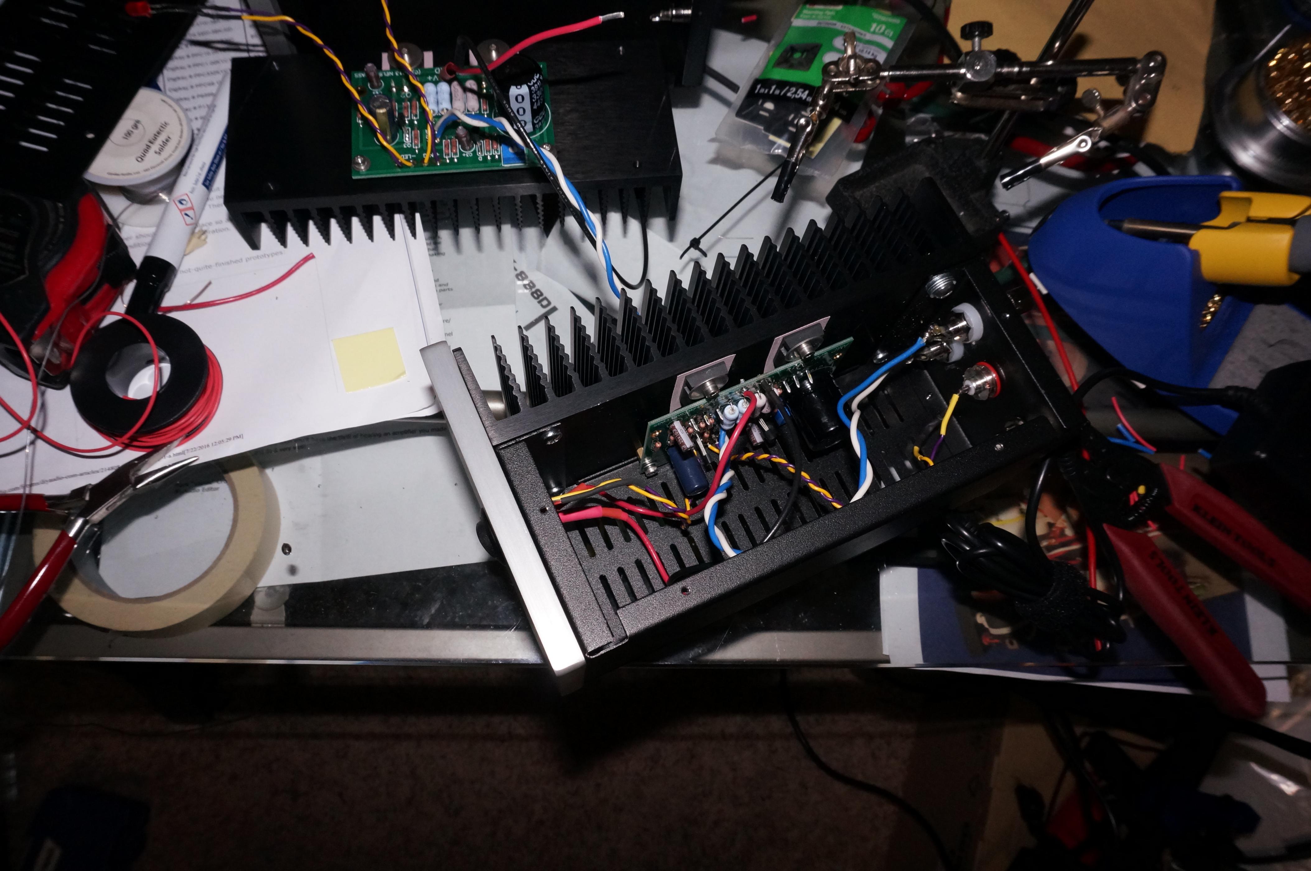

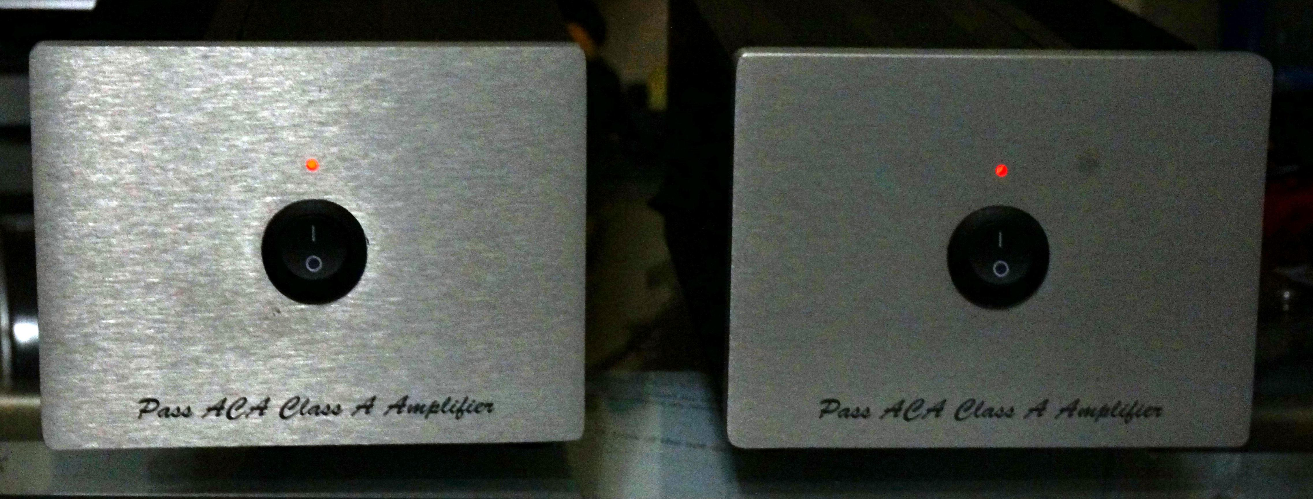

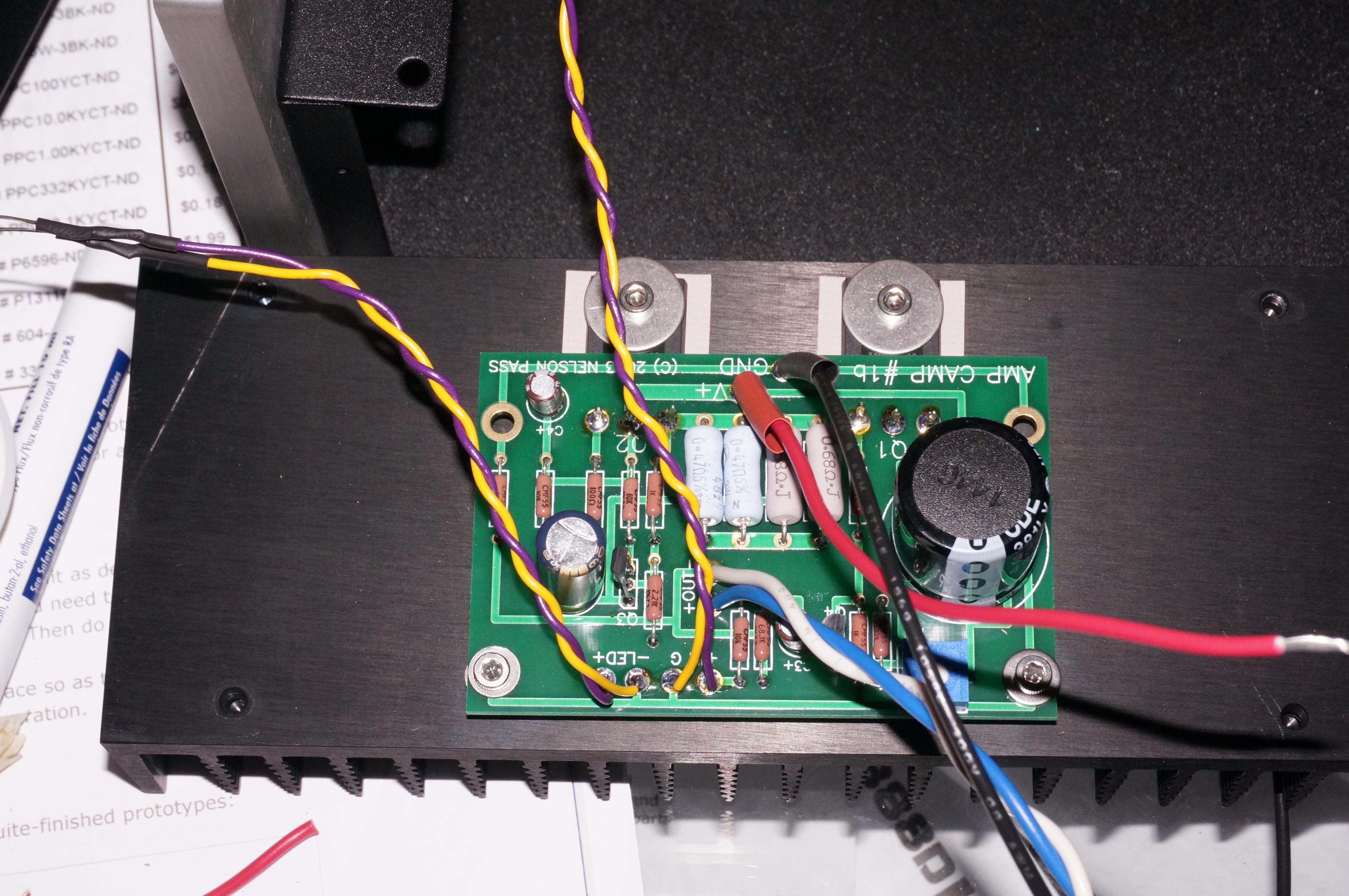

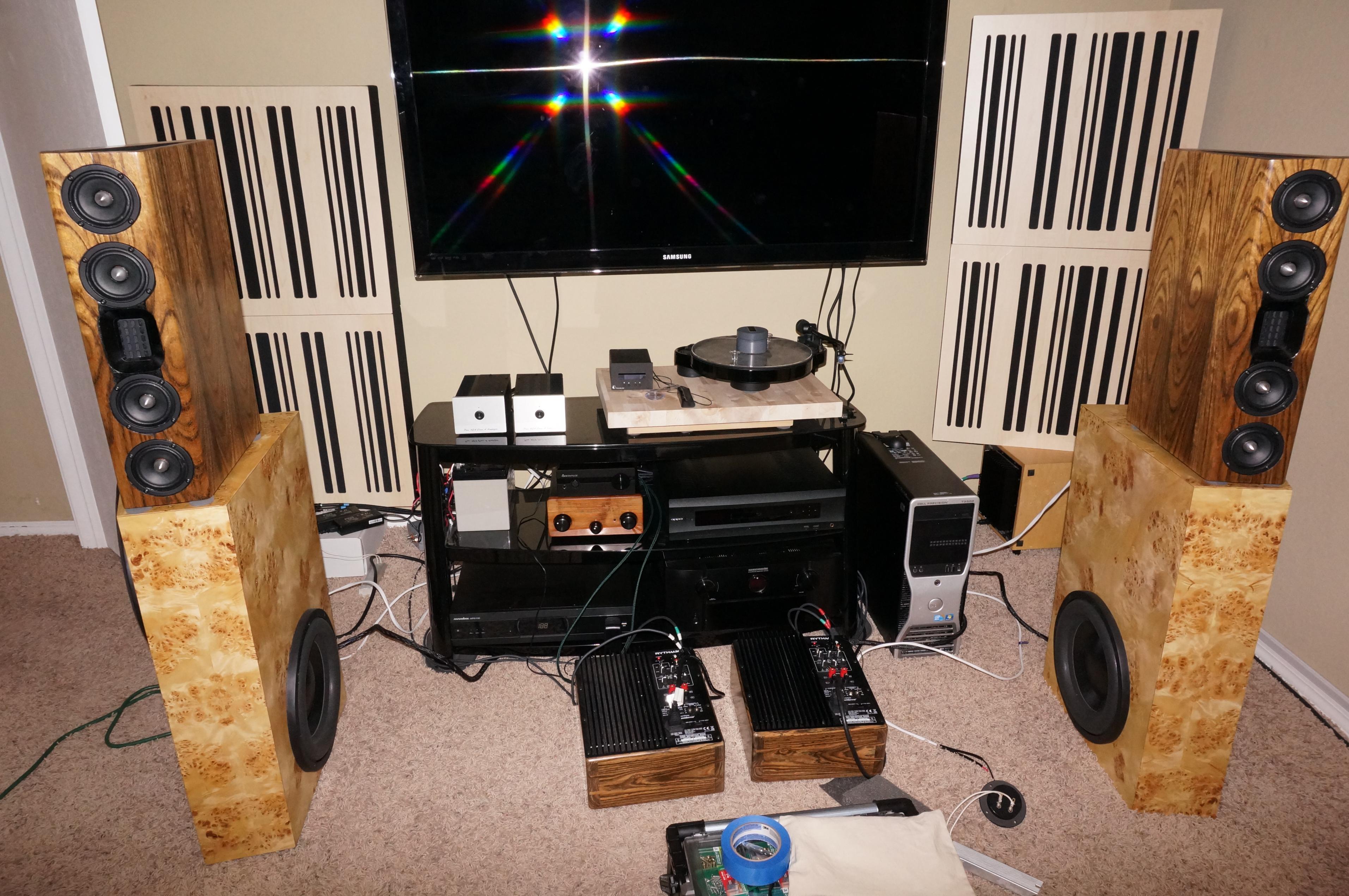

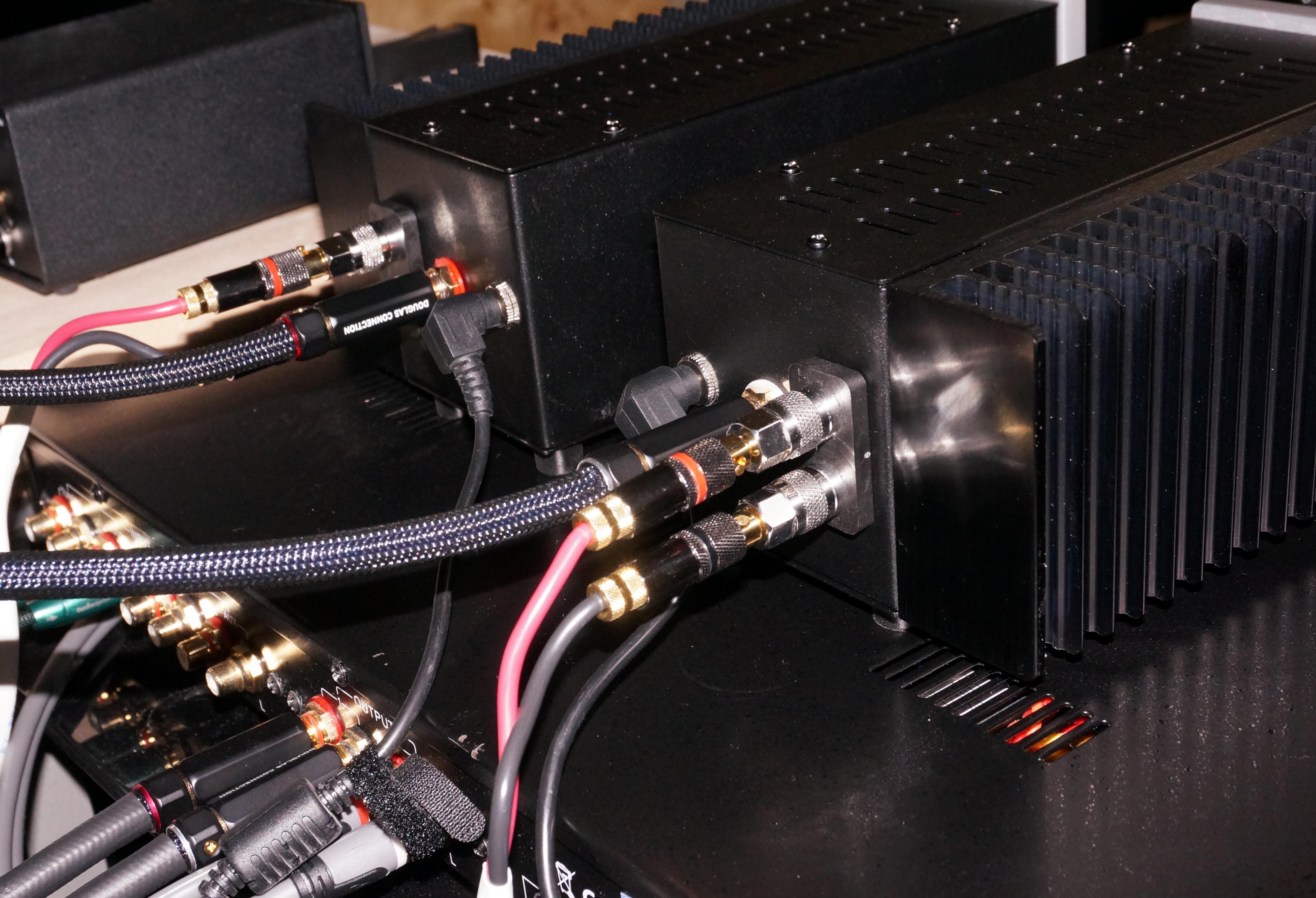

Anand,
Here you go
The first two pics are of the build in progress and getting close to the end.
The third is a shot of the Cardas RCA connectors and binding posts. These required reaming the binding post holes out to just over 1/2".
Next is the first time I powered them up. All magic smoke stayed inside where it belonged.
The 5th pic is the ACA occupying the space where the Prologue 4 usually sits. The wood front piece on the second shelf is the Dodd Audio tube buffer I normally use for source switching and volume control.
Next is a shot of the system. The Xeon based computer in the lower right is the source. You can't really see the DAC because it is black and sits on top of the Dodd tube buffer. The DAC is an LH Labs Pulse X-Infinity. The speakers are open baffle DIY kits (I built and finished the cabinets) from GR-Research. The ACAs are powering the top sections which play from 200Hz-20kHz. The subs (20Hz - 200Hz) are powered by the plate amps on the floor between them. When fed through the Dodd the ACAs sounded anemic. This is because the Dodd tube buffer does not have any gain.
The last picture is of the ACAs on top of a Jolida JD-5T preamp which I borrowed out of another of my systems. When fed through the Jolida the ACAs came alive due to the 10dB of added gain and 7V output of the JD-5T.
