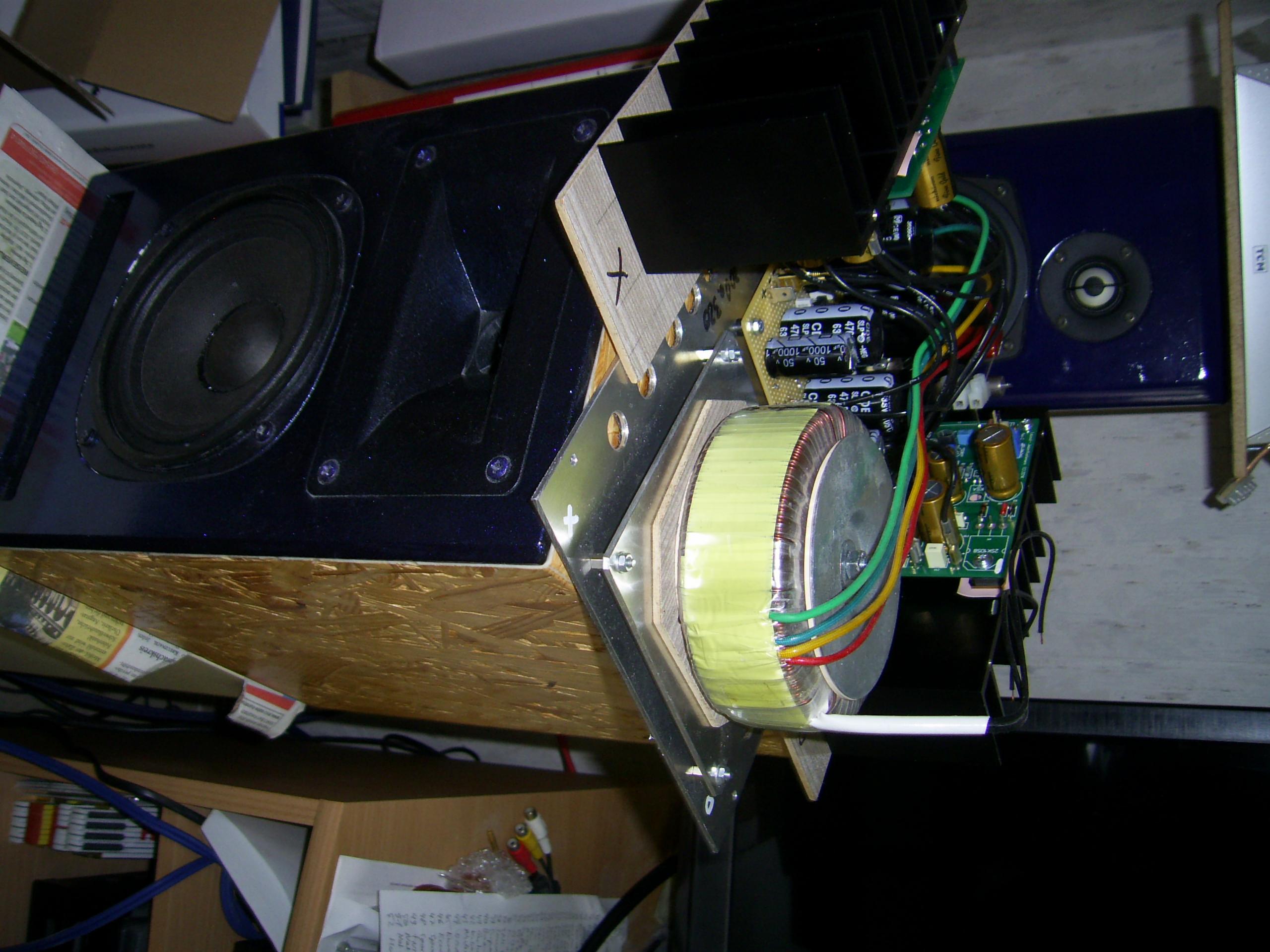

I'm working on a project where I'm considering mounting the ACA's vertically on a speaker stand. I'm going to employ some isolation techniques to minimize vibrations from the speaker to the amp...but still am concerned. Do you think this would be a problem?
Also, would mounting vertically effect the thermal dissapation? Should I consider relocating the board on the heat sink. I think there's room to rotate it 90 degrees and place on the bottom third of the sink. But I'm not sure it matters.
I don't think relocation of the board is necessary. The most obvious concern is that the heatsink fins will be horizontal, but that's a tradition with Nelson's First Watt amps, so it can work! Having it in free air instead of in a shelf unit will be a big advantage thermally so it will probably be fine

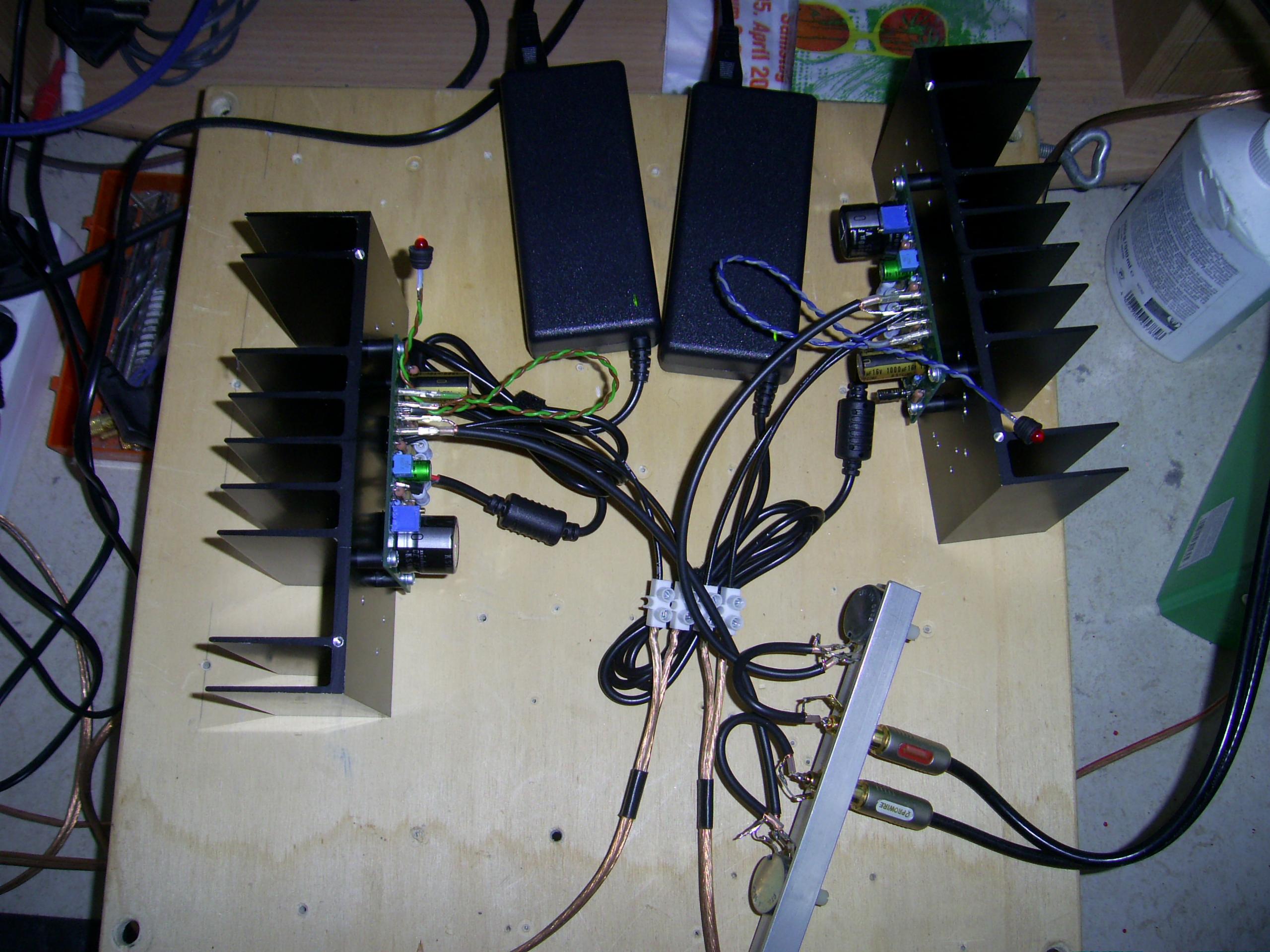

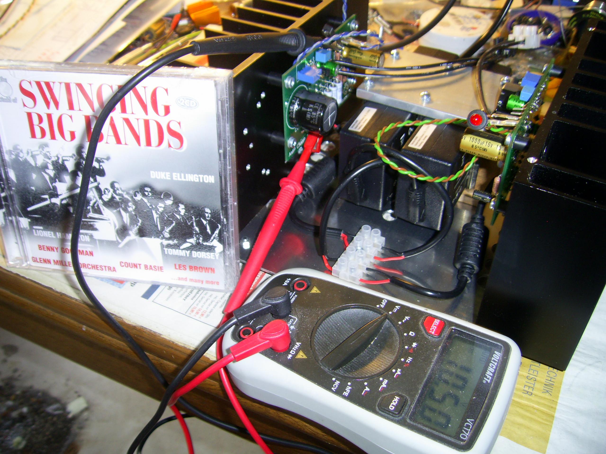

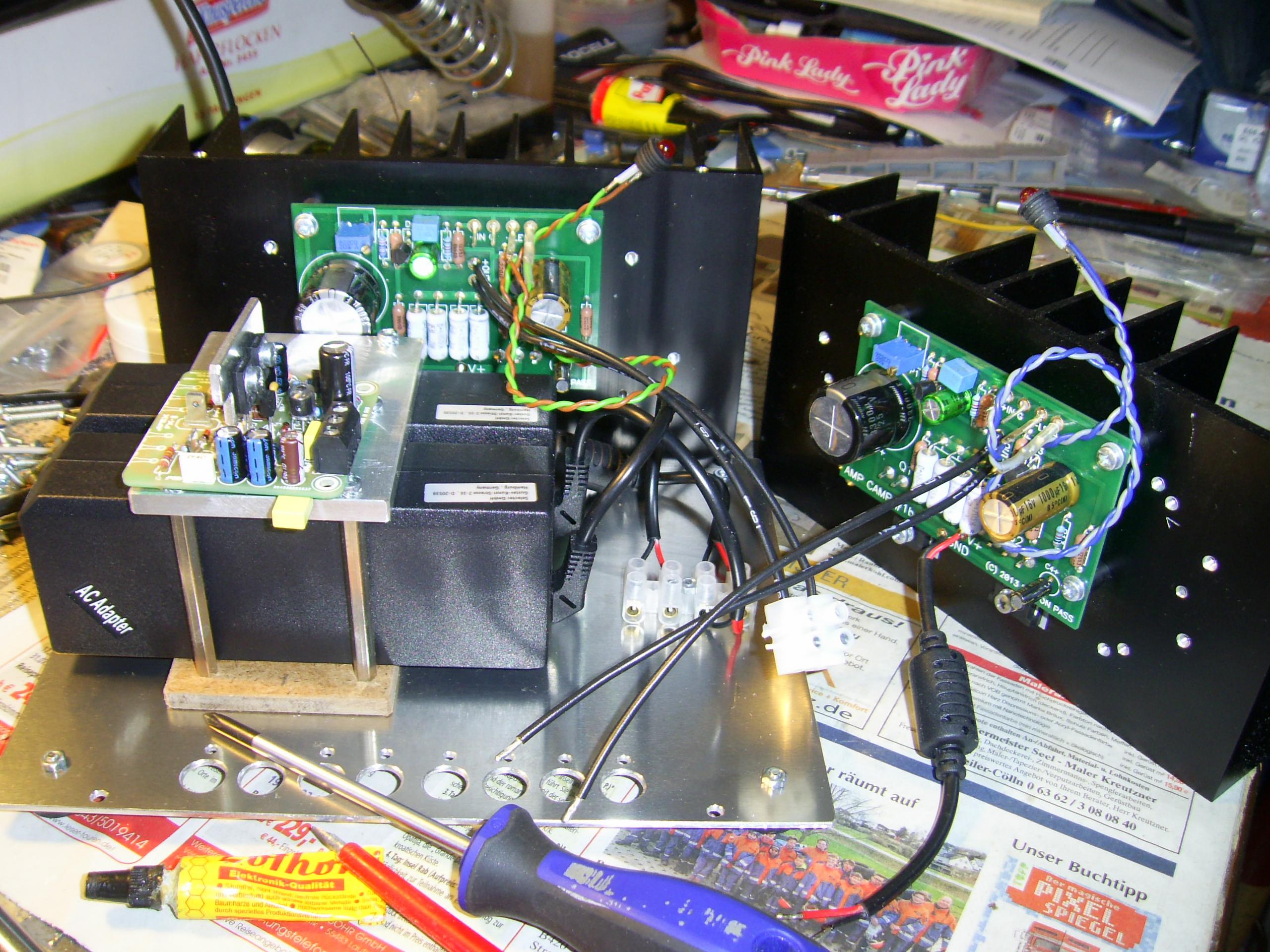

Hallo ACA Friends.
I have now testrunning the R15-2,2k pimped Variant.
The first SMPS 19V 4,74A- one of them works with failure: whistling and send it to Speaker.
So i ordered new ones 20V 4,5A and set up the bias point to 10,5V on measuring point.

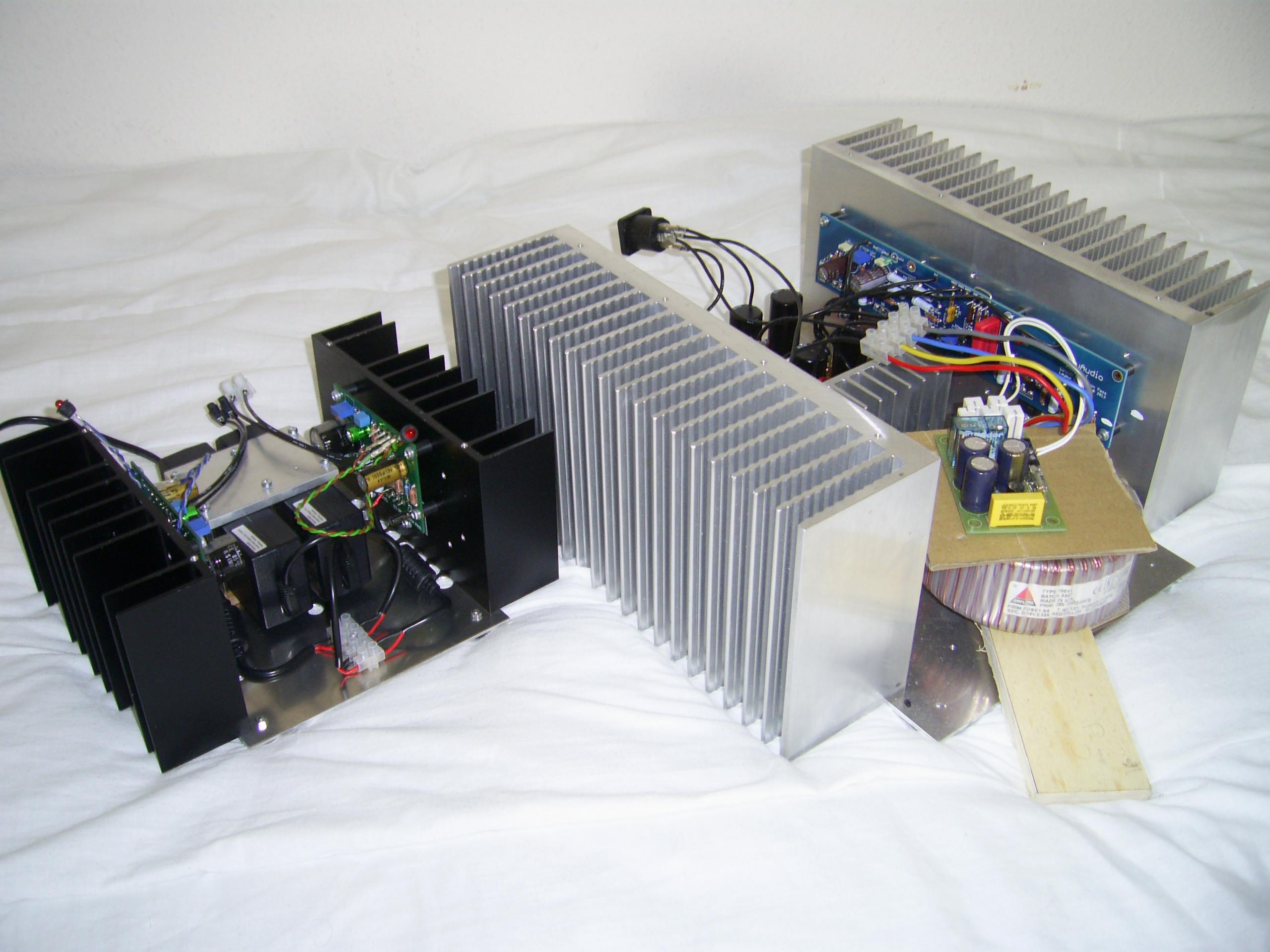

I tested it long day period now and detected that my heat sinks are a bit tiny
to dissipate.
Also the 3W resistors goes very hot there.
Could i lower R15 to 1k?
I am not so lucky with my capacitor choose actually, missed a bit staging, separation.
In contact with Rudi, his active ACA Loudspeaker project- he doesn't mod R15,
only goes higher in voltage- 24VDC.
That i have done on my Mini Aleph Project and find that works.

Hallo ACA Friends.
to dissipate.
And Yes the ACA Boards available i also say weeks back now.
And thanks great quick store service my BA-3FE boards very fast received
here. Yes!
See my Test Build.
Bangla
Heatsink too smallHallo ACA Friends.
to dissipate.
here. Yes!
See my Test Build.
Bangla
